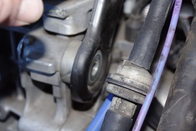

This is what it looks like "When Good Bushings Go Bad". Pulled this off my car the other day.
It's so much easier to just replace the whole torque arm. Eeuroparts has a Nordic one for only $57. The genuine Volvo can be had for $92. I'm also replacing the whole vertical bushing at the firewall with the updated one.
Question: Does anyone advise also replacing the horizontal torque arm that connects the two? It's under $50, genuine Volvo only. It looks like a part that could get easily bent once the bushings fall apart.
I'll be installing all new engine mounts. Going with Volvo subframe bushings, Corteco rear mount, Hutchinson front and trans torque mounts, and Febi right engine mount.
Any thoughts on the Nordic upper torque arm? Has anyone tried this part? I've heard their rotors aren't the greatest.
Nordic Upper Torque Arm - Eeuroparts

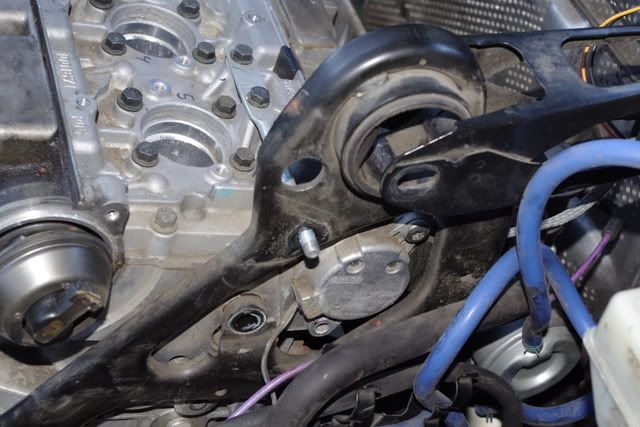

Alright, I need help. Is that cn90 guy around? Remember a few posts ago when I said how much easier it is to replace the whole torque arm? Uh yeah, I was talking out my posterior apparently.
I've got the bolts off and that sucker won't budge. It appears that it's either pressed in where the two lower bolts go, or it's supposed to be pried off. I don't want to start prying on the thing if that's not what you're supposed to do. I thought this was an easy part replacement, but I may end up just putting in a new bushing like everyone else.
front bolt hole
rear bolt hole
