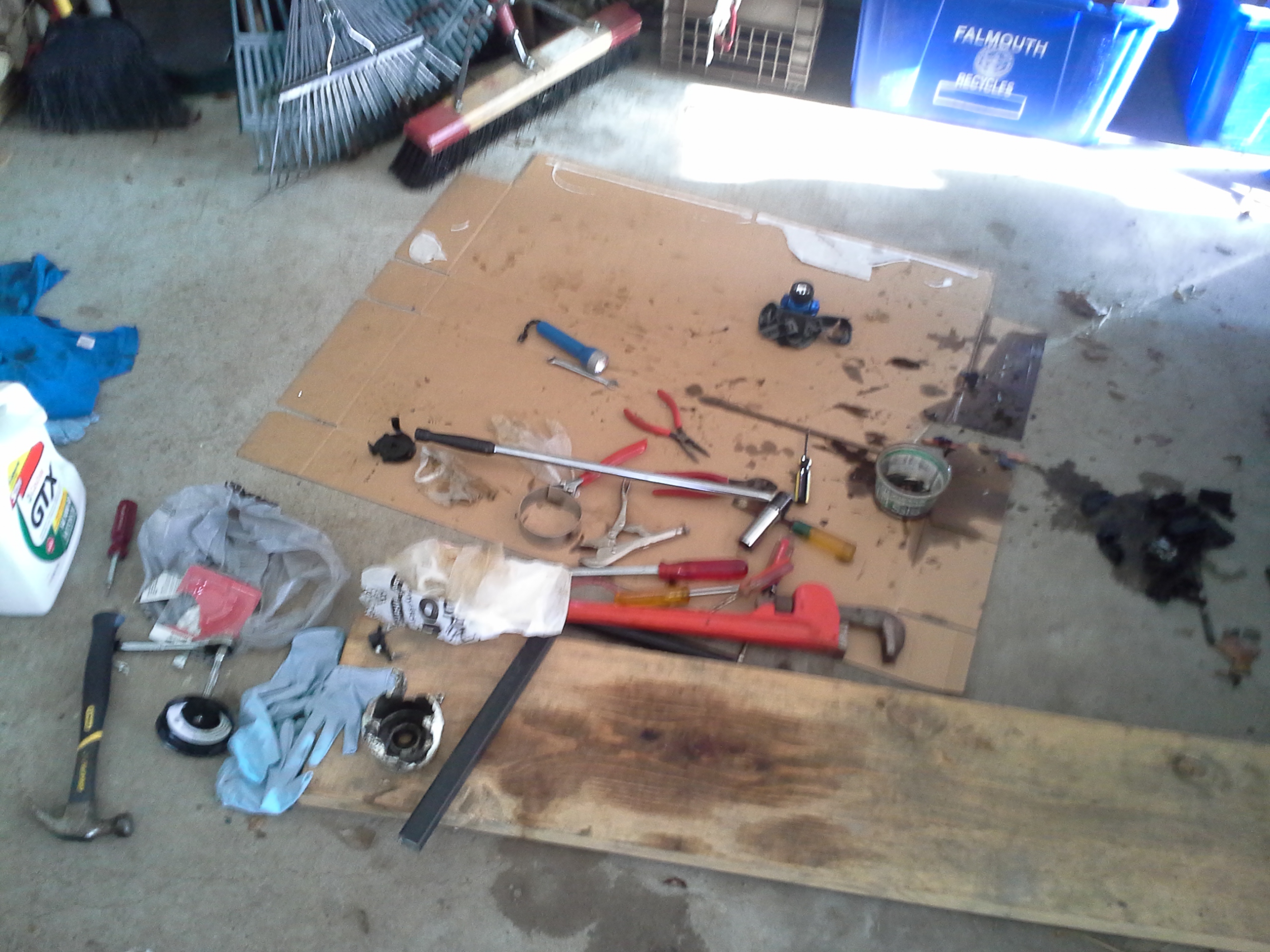

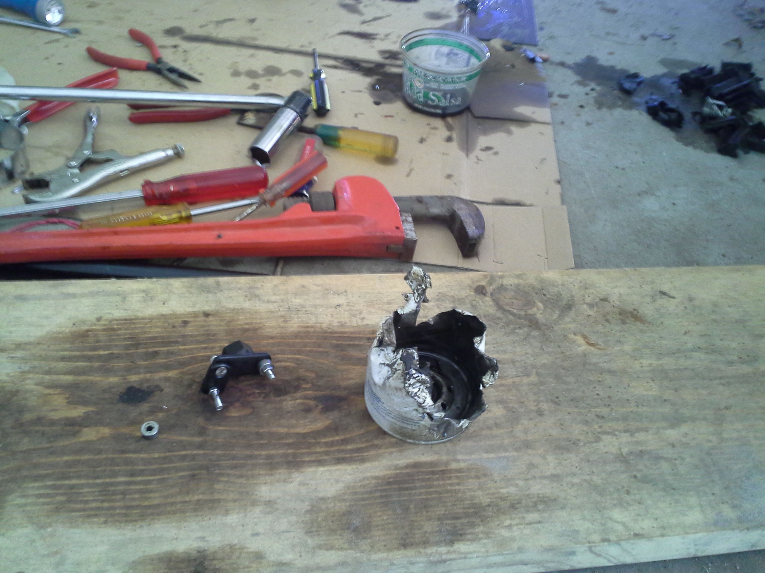

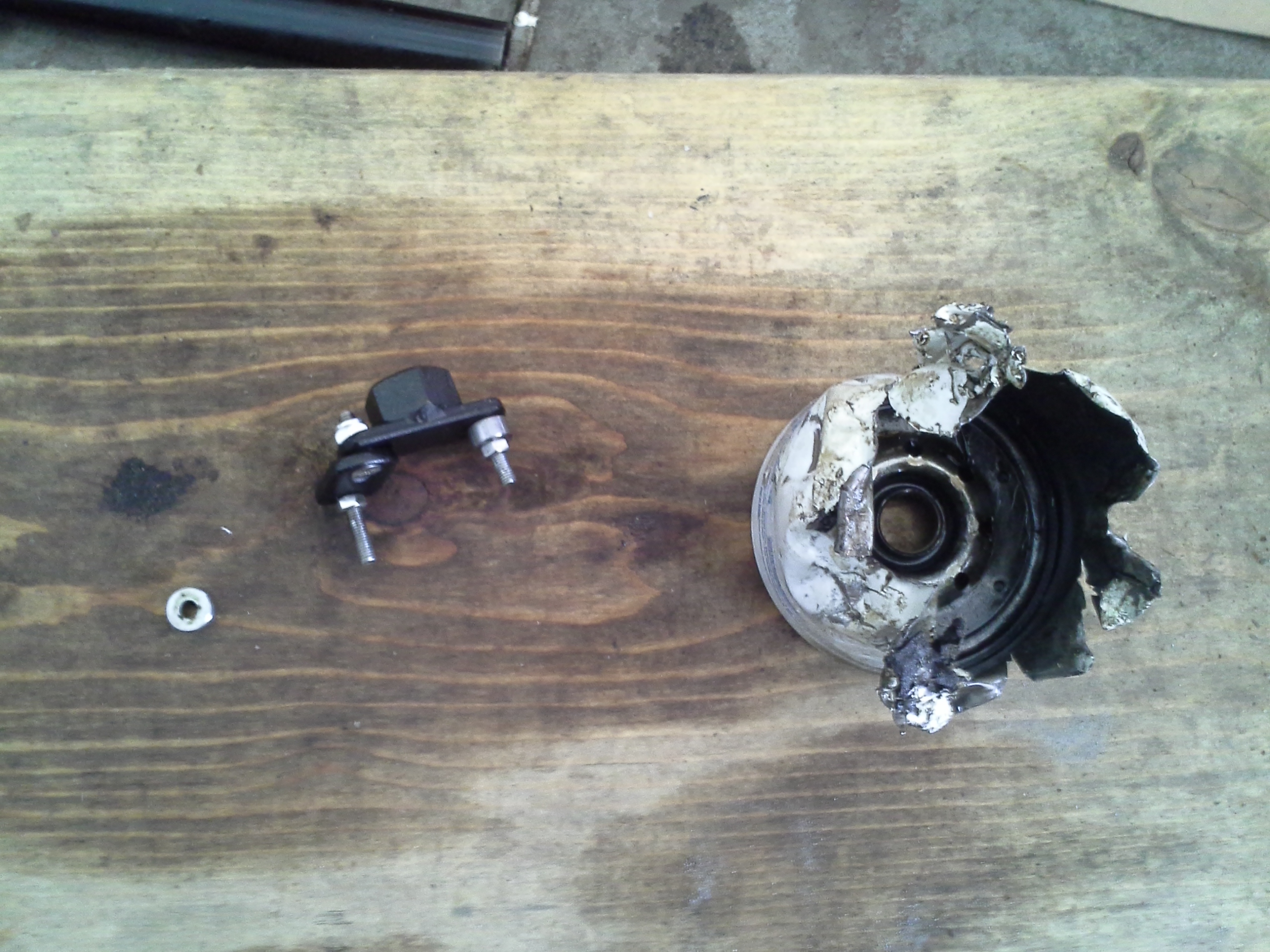

I finally removed my oil filter. I ordered that special tool from Bogert Aviation. The pins bent on the first try, so I replaced them with some thicker screws. That did the trick.
see the pic of all the tools I tried on the thing.

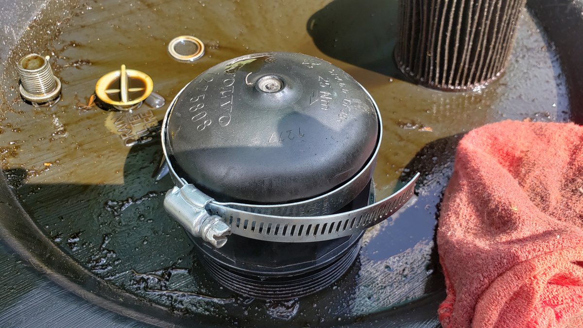

I know this is an old post, but after hours of struggling with the same thing, this worked quickly for me. I took a large hose clamp, tightened it around the filter with a socket and then used a hammer to hit the socket wrench until it started turning.

Thats awesome as a trick.
I use the fluted cup type oil filter wrench and have never had one stuck, but I hand tighten only, too.
