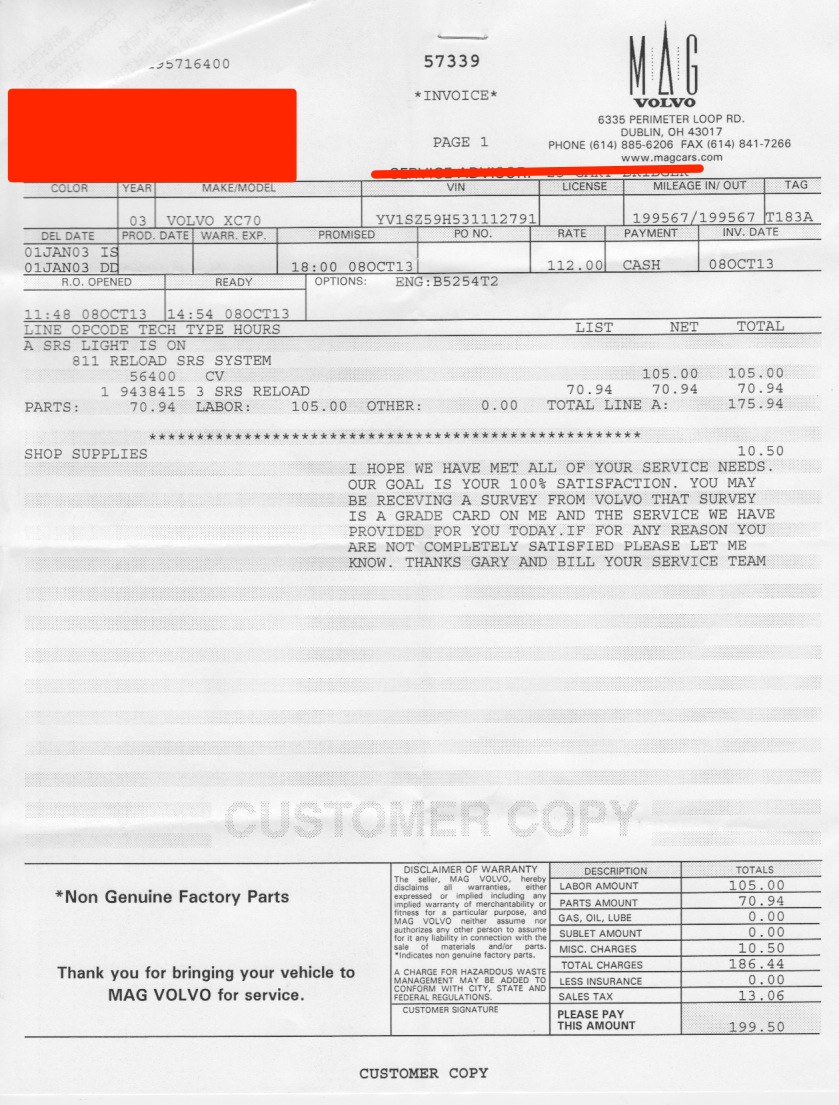

More info on my adventure...
Volvo dealer (MAG in Columbus) wants $210 to reflash the SRS module. They tried to update it but it wouldn't even take their update. About $70 for the software plus the ridiculously hourly labor rate!
Good news is he said the newer Volvos are not the headache these P2 cars are with software and modules.

Dealer or indie?
There is no sympathy at this big dollar dealer (Bentley, Porsche, Landrover...). The guy who I was dealing with was nice and knowledgable but actually laughing about how often they have to reflash some modules. He said there are some cars that come in that were left off battery power for so long that almost every other module needed reflashed...he said one project took 5 hours. I'd like to think the P2 years were the first big design in module based computers...and somewhat of a failure in execution on some level.
I'm pretty pissed on this just on principle but again, I don't mind the live and learn aspect of it. One thing I tell anyone who is thinking of used Volvo ownership...if you cannot purchase and manage a Vida Dice expect a lot of time at the dealer.

Mine was an indie...I hate paying out when my car isn't fixed so feel for you. Agree on the design flaws...I don't mind complex if it never goes wrong.
