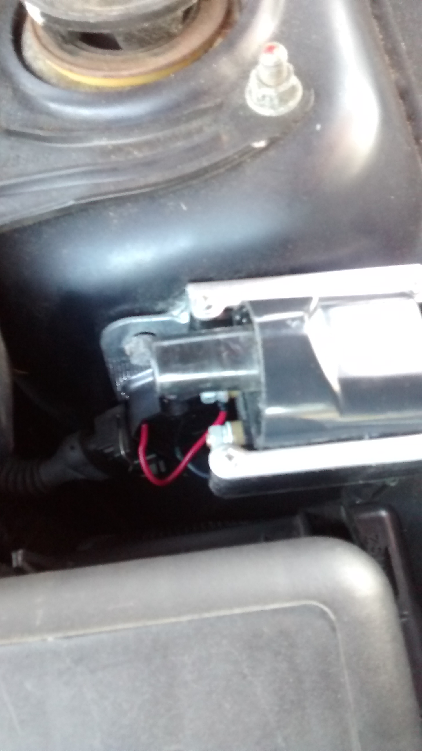

let it trickle charge all night had 13 volts this morning plenty to crank would just thump at the end of the crank,ive ordered a crank sensor,new cam sensor,cap,rotor ignition coil and wire.

defiantly no spark

Virtually nothing at contact points when i crank maybe 1.3 volts

replaced the coil again and the coil to cap wire fired right up, did not suspect the coil because i had just replaced it this summer. I'm doing a full tune up anyhow,plugs,wires,cap,cam sensor,crank sensor got good deals on the parts less than 200 for all.
