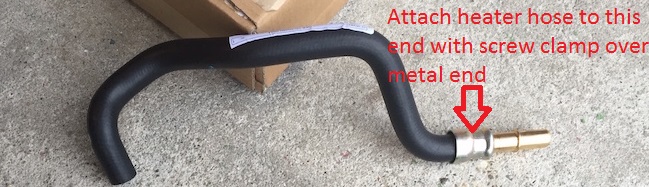

Instead of cutting the metal lines inside the car why not attach a generic heater hose to the metal end of the hose inside the engine bay. This way you keep the factory fit and it should be easier to do.
I'm not sure of the OD on the heater hose and if you can get a rubber hose to fit on it after you debur it.
But it would keep the factory seal of noise/debris from entering into the cabin.
BTW: nice body work Ben850; I've done it before and it takes a lot of patience but I hate it.

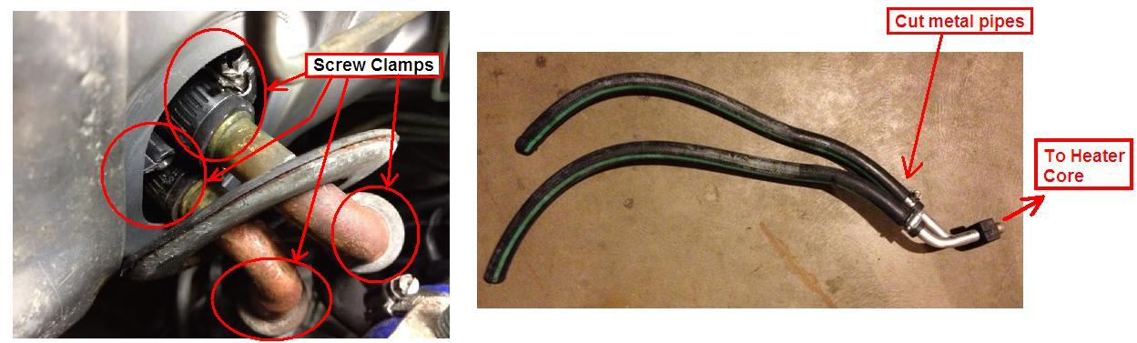

Because the factory design is convoluted over-engineered non-sense: this O-ring, that O-ring, this quick disconnect, that quick disconnect etc. that are prone to failure.
I am putting together some random photos to illustrate what I think is a better approach:
Heater core ---> cut metal pipes (inside cabin) ---> generic hose (and clamp) to "recycled metal elbow"
---> firewall ---> another hose (and clamp) ---> engine block.

How well does the hose clamp hold onto the factory elbows? There's no bead on them to retain the hose. I'd be worried about hoses blowing off. (I drove the better part of a kilomile with those elbows shorted using hose clamps and a short section of hose and experienced no problems, so it's more of a long-term concern.)
McMaster-Carr sells 5/8" brass barbed elbows for ~$9 each. I've ordered a pair of those. You can also get plastic elbows at any auto parts store for just under half that.

Ok, My idea is to do half of what is required, it looks like it will work. I see the hose from the pics the hose secured to the recycled metal eblow.cn90 wrote:Because the factory design is convoluted over-engineered non-sense: this O-ring, that O-ring, this quick disconnect, that quick disconnect etc. that are prone to failure.
Because:
What keeps the hose from moving around ?
What about shafing the hose?
What seals the firewall?
Much less work
I've never had one issue with the connection: no leaks, never came loose. Its only when people start trying to unhook it improperly, or not replace the O ring when they do. If you leave it alone, it is normally okay.
Nonetheless, if you do see issues with the o-ring connection. I see the merit. Glad to see that just securing a generic hose seems to work but I imagine to use a generous bend radius.

I have done this many times in other cars (Jeep), smooth metal pipe with no ridge, slide the hose in and clamp it.j-dawg wrote:How well does the hose clamp hold onto the factory elbows? There's no bead on them to retain the hose. I'd be worried about hoses blowing off. (I drove the better part of a kilomile with those elbows shorted using hose clamps and a short section of hose and experienced no problems, so it's more of a long-term concern.)...
It holds the connection very very well.

Ironically, the issues will now come from exactly that, leaving it alone. The 20 year old o-rings get crunchy and start to leak. Or the plastic coupler crumbles when stressed. Unless you pull and replace the entire coupler and its assorted knickknacks, there will be issues with the factory setup. The one in your car may be holding out well (so celebrate indeed!) but that is a sample size of one. I've had leaking o-rings on two cars now (luckily both are gone!). The most common occurrence is that they are great all summer and fall but coolant slowly disappears come wintertime, when temps get cold and the metal shrinks and/or the o-rings are less pliable. The coolant leaks down the inside of the firewall and slowly pools under the floor mat(s). Lots of fun to replace when it's 20 degrees in the garage.mecheng wrote:... I've never had one issue with the connection: no leaks, never came loose. Its only when people start trying to unhook it improperly, or not replace the O ring when they do. If you leave it alone, it is normally okay.
