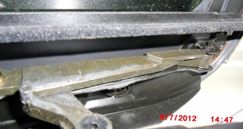

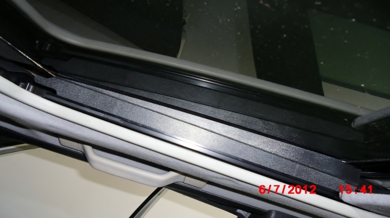

Here are some supplemental pictures of a 1998 V70 XC sunroof removal. Bay13 at VolvoSpeed already has good write-up.
Pull on the middle of the bottom plastic that shields the sunroof raising mechanism to pull it out of the track and then pop it up onto the top.
CIMG1779 (800x448).jpg (144.07 KiB) Viewed 1773 times
You can see a metal standoff to the right where the plastic shields snap on/off the sunroof raising mechanism.
CIMG1780 (800x448).jpg (193.64 KiB) Viewed 1773 times
Here is the plastic shield from the sunroof raising mecahnism scissored open. Good time to vacuum it.
CIMG1781 (800x448).jpg (125.72 KiB) Viewed 1773 times
Here is the plastic shield from the sunroof raising mechanism snapped together. You can see the snaps for the standoffs.
CIMG1783 (800x448).jpg (182.09 KiB) Viewed 1773 times
Re-assembled after wiping everything down and using silicone spray sparingly to lubricate moving parts. Too much will attract dirt.
CIMG1785 (800x448).jpg (215.55 KiB) Viewed 1773 times
