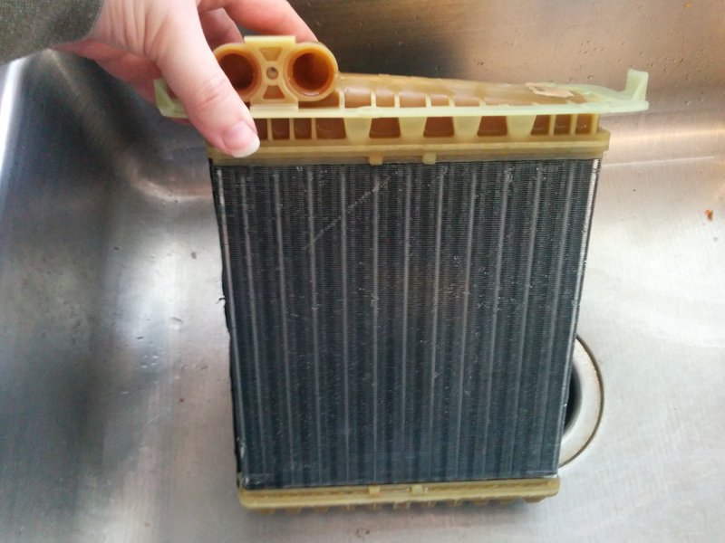

Figured I'd chime in. I also have an ebay core "Swedish Auto parts" with the crimped ends on my '99. I suggest running it through the dish washer on the lower rack first to avoid an oily smell. I used the included o-rings and had zero leakage - at this point it has been in ~2 months in the frozen north east. I did this on a ~30 F day with 2 trash bags and an old washer fluid jug. It was great getting heat with no smell... My opinion is that it may not be quite as warm as the OEM but we'll see how it lasts. I believe the gasket seal (foam) isn't sufficient for the pressure and volume of the air being sent toward it. I may go in and work on fixing this in the summer...
When putting it back together it is critical that you get the metal pipes to mesh just right or you WILL get or have a leak - assuming all else is correct with the tolerances. I wiped mine down carefully and lubed both o-rings and passages on the heater core with antifreeze before insertion. You may need to use light emery cloth if yours was leaking from this interface. You don't need to he-man it tight either, we're just going for tight enough that it isn't loose.
Replacing the heater core hoses after ~20 years in service isn't the worst preventative maintenance idea. Very little cost to replace them now - quite a bit of cost if you crack the head because of a 'preventable' failure. Would suggest replacing the thermostat at the same time. Would boil it first to verify it at least opens. Obviously your finances and your situation will guide you on this suggestion.

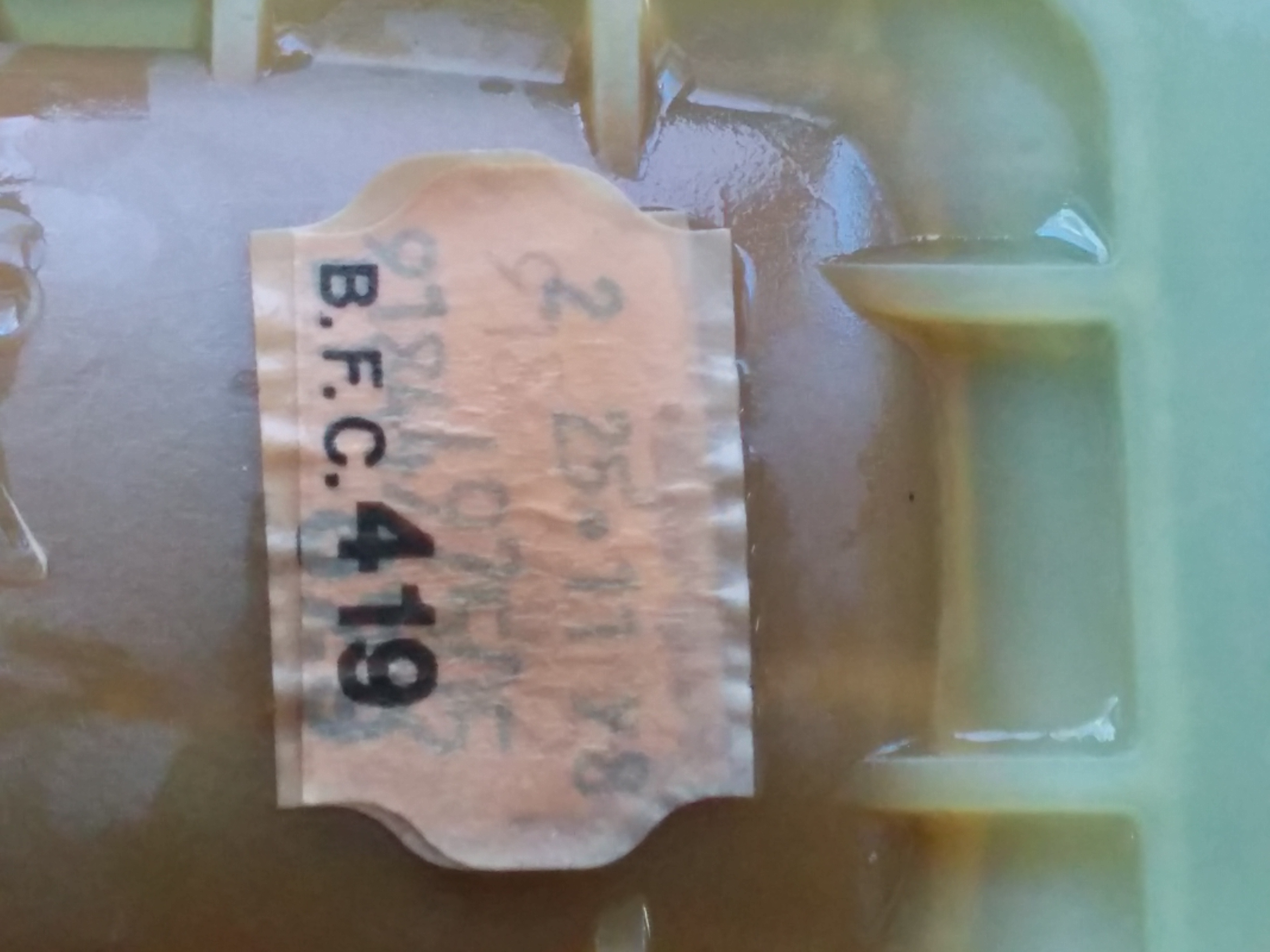

The heater core I replaced was built on 11/98 - the sticker was still on it so I'm assuming my build date was close to the end of production or that this is the 2nd core it has had. It had developed pinhole weeping when hot and drove me nuts with the smell. There was no visible collection of antifreeze in the heater box when it was removed.
