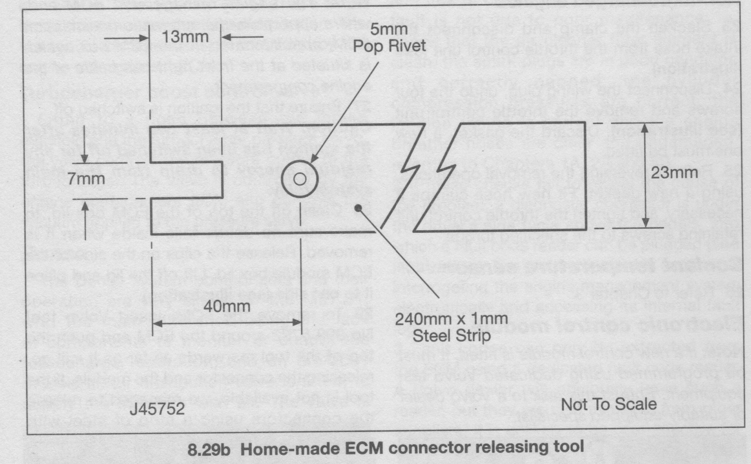

I suffered the same scenario on my wife's 05 S80T with Bosch throttle body. Various throttle-related fault codes, going into limp mode, "Reduced Engine Performance", etc. And I learned a $350 lesson in the process (Purchasing a new throttle after all the cleaning in world wouldn't help.) I should have taken a clue from my Volvo indy mechanic when he said he had NEVER seen a Bosch throttle body got bad. Turned out to be flaky ECM connections. Removal, cleaning, and reinstalling by the indy fixed the problem.
Haynes has a drawing for building an ECM removal/relock tool if you're handy with metal work. Otherwise you can purchase one for around $20-30. Here's a pic if I attached it correctly:
ECM Tool.jpg (297.05 KiB) Viewed 1566 times
