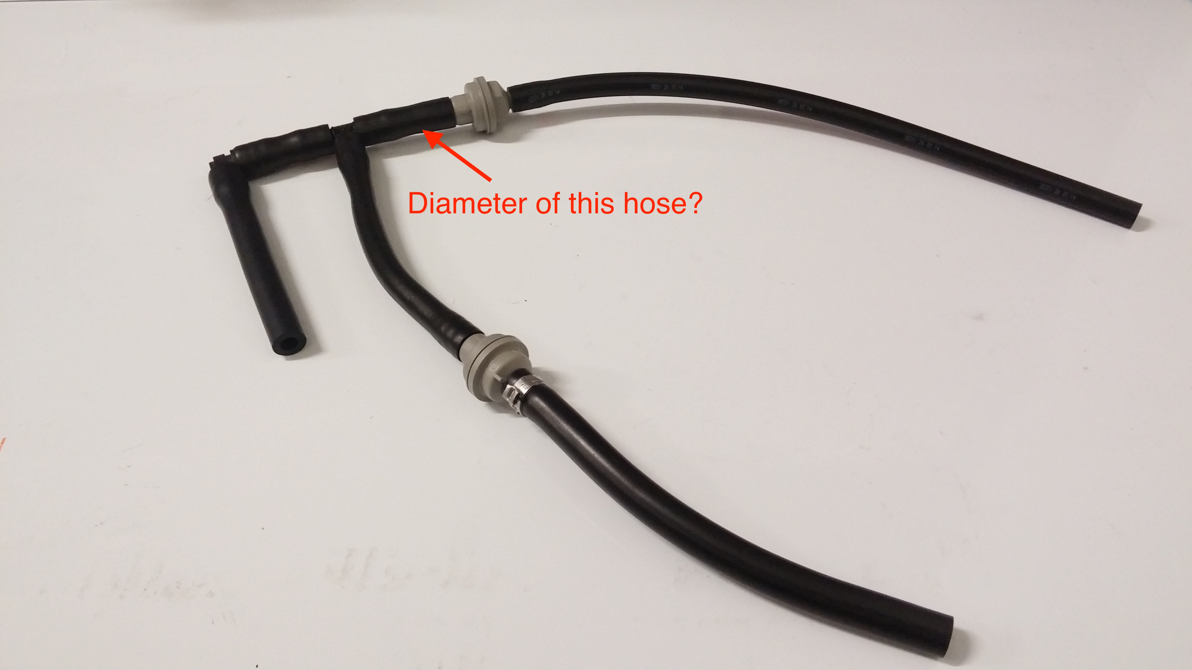

OK, so this is a very interesting discussion but I still don't have answer due to "forum drift".
So I thought I'd try this another way. See picture below. Anyone know the answer? If I don't get an answer, I'll go measure it in the dark this evening (taking off an air intake tube which is in the way) and report back. Will this be a a rare case where the forum was slower to the answer than the do-it-yourselfer?

Please don't do that to this cool topic. It's bordering on forabuse.
Cut the hoses and measure. There isn't even a guarantee they are OEM after so many years

Its been a while since I did those hoses. You don't care about the o.d. as there is plenty of space where that goes. If I remember the T fitting is slightly smaller than the valve which is in the 3/8 to 7/16 ID area. What is important is to make sure you get PCV rated hose that can handle oil vapor or better (oil,fuel, trans line etc are all fine if they are out of PCV oil vapor rated). Vacuum hose is not meant to carry petroleum vapor ( just air) so it is less resistant.

I had a brain fart. I realized that I posted this in the wrong thread. I had another thread going on about the vacuum hose here. Jumping beween threads, I got confused. I am myself responsible for the "forum drift".songzunhuang wrote:OK, so this is a very interesting discussion but I still don't have answer due to "forum drift".
Here's the link to the proper thread for the vacuum hose question.
https://www.matthewsvolvosite.com/forums ... =1&t=74636
Sorry for the tangent.
