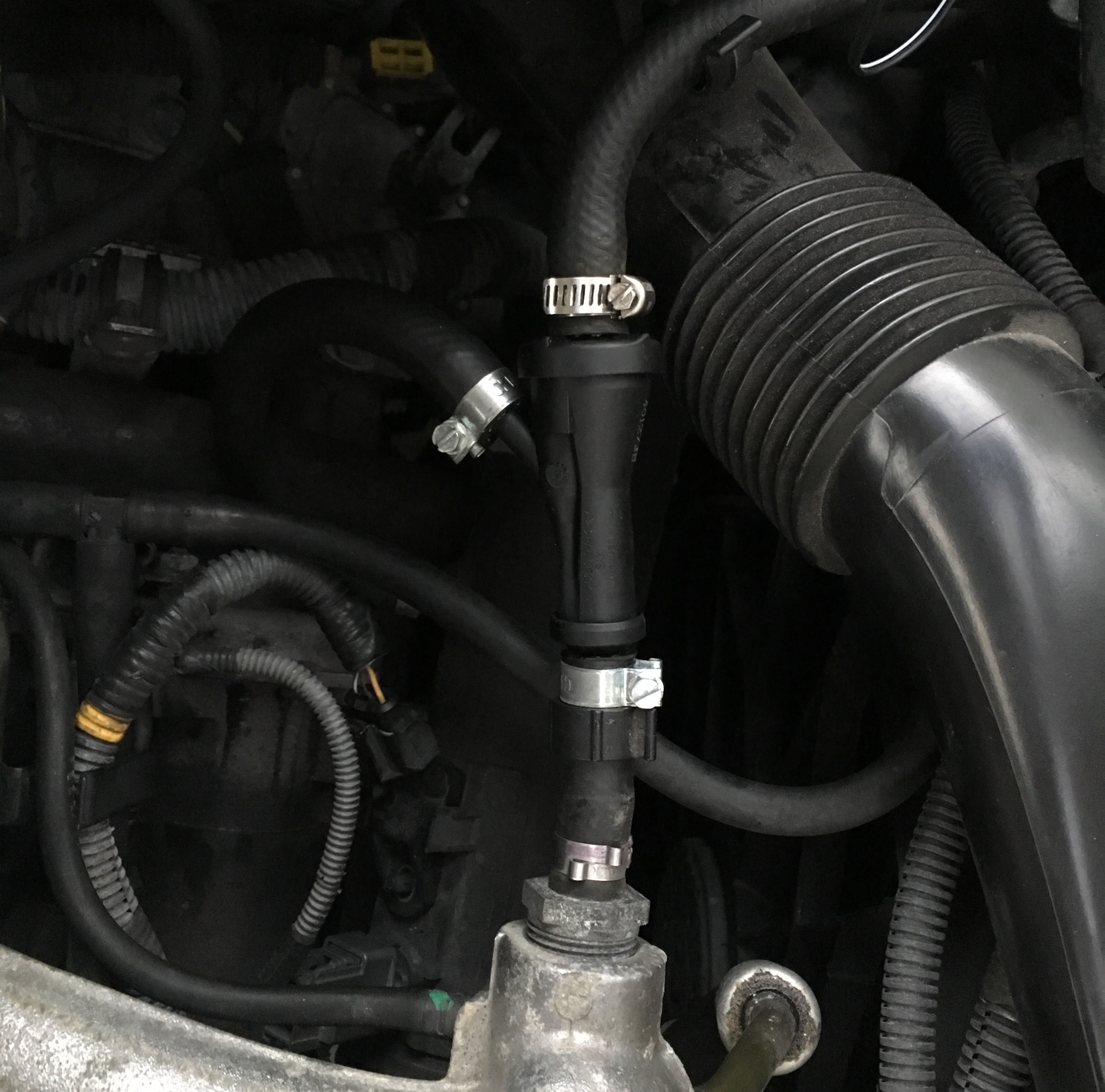

I had this vacum unit replaced back in February when it was 10 degrees out. By any crazy chance this went bad again. In February the vacum connection cracked causing the brakes to fail and the engine to shut down....

I've had a trickle charger on the battery since I'm in and out of the car. Lights are on plus cranking the battery probably drained it some what. I will place the battery on the charger for a few hours tomorrow. I replaced the alternator last summer with a top notch Volvo rebuild with a new regulator and bearings.
I'll tell ya if anyone on this forum has that little Y vacum and you have 100,000k change it out. It was one hell of a scary ride. Online part $40 free install.
