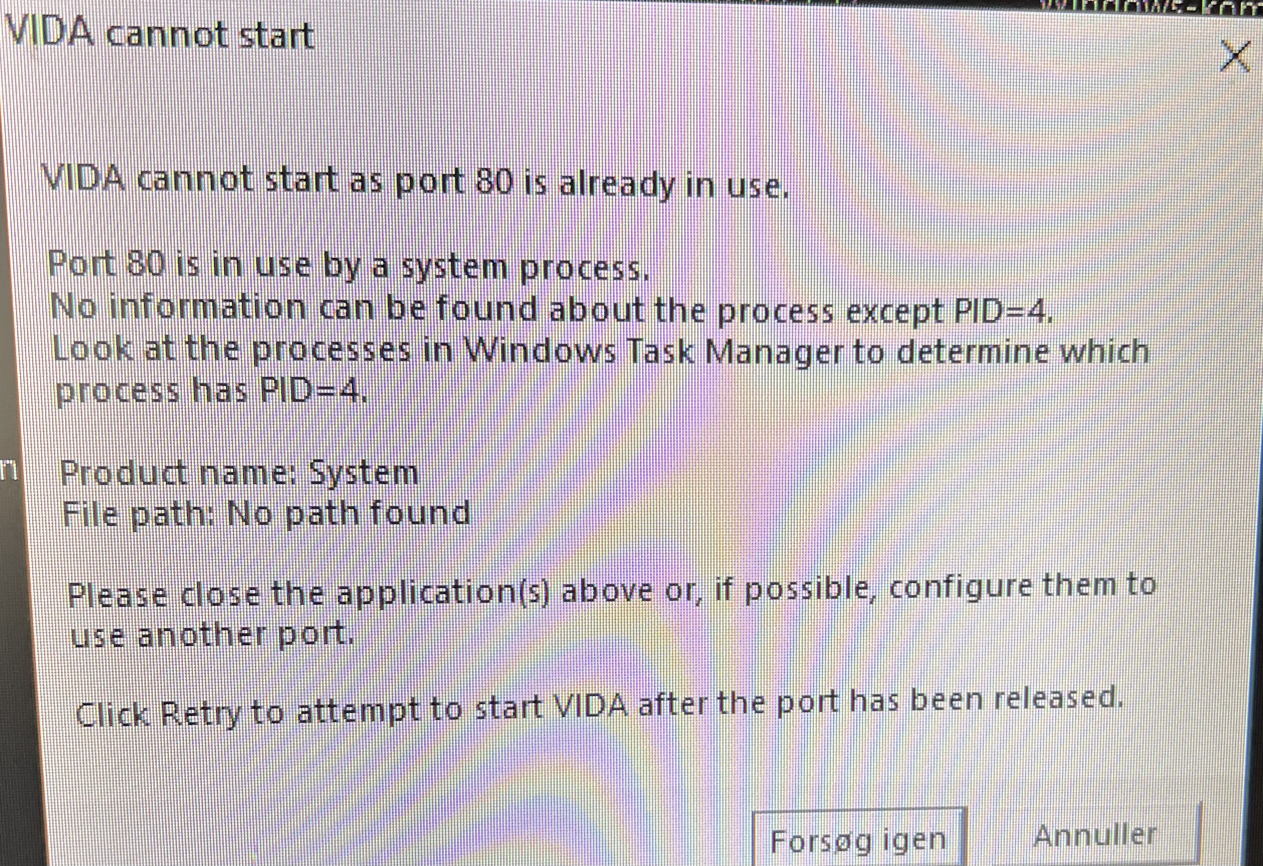

I finally made the install on Window 10, but now have the problem that port 80 normally used by VIDA is used by a windows system ( not able to abort it).
I have uploaded the screen message. Hope someone can help me!!
- RickHaleParker
- Posts: 7208
- Joined: 25 May 2015, 14:30
- Location: Kansas
- Been thanked: 980 times
Turn off Internet Information Services.

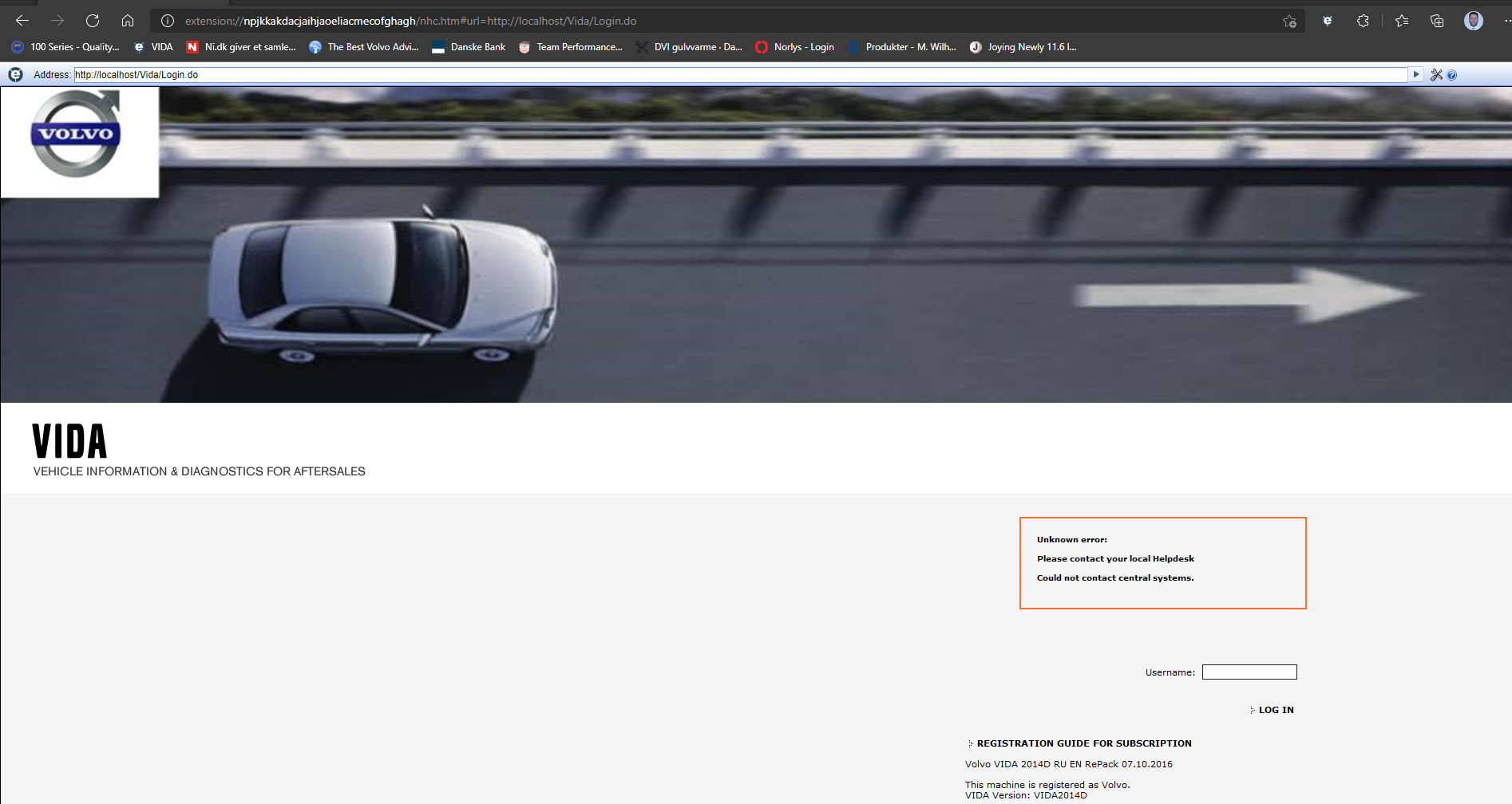

Thank you so much. Worked perfect. But now I ended up with this? Hope you can help? Thanks a lot!
- RickHaleParker
- Posts: 7208
- Location: Kansas
Run the 2099 patch again. Reboot, wait for VIDA monitor to turn green, then try to login.onkelkunckel wrote: 08 Mar 2022, 07:25 Thank you so much. Worked perfect. But now I ended up with this? Hope you can help? Thanks a lot!

Hi Rick
Tried that without luck. Sorry!
I keep getting this error:
The information shown below can be found in the log file,
, located in the C:\VIDA\System\Log\ directory.
Framework35 OK
Security OK
install.doinstall.3pp.components.upgrade.sqlexpress2005
An error occurred while upgrading Microsoft Sql Express 2005 to Sql Express 2008 R2.
VIDA NOT OK
When I install SQL Server 2008 (Windows 10 Home x64), in compatibility with Win 7, the error remains the same.
I also tried to install the SQL server 2005, but the installator ends at SQL server connection issue. Starting server manually didn't work as the 2005 is not installed due to this error.
And second issue, Vida installation and patch installation returned error with VidaMonitor folder not found, so I created it manually in C:/VIDA, so now the error is gone, but the folder remains empty.
Any ideas what to do with the SQL issue?
And how do I get Vida Monitor?
Framework35 OK
Security OK
VIDA NOT OK
- Posts: 14815
- Joined: 14 Sep 2002, 11:03
- Has thanked: 2864 times
- Been thanked: 1332 times
Try this.
- jonesg
- Posts: 3698
- Joined: 16 Jan 2008, 15:25
- Year and Model: 2004 V70
- Location: Northern maine.
- Has thanked: 73 times
- Been thanked: 534 times
vida monitor shows up at the bottom of your screen in the taskbar.
it will be red, then turn yellow, you have to wait until it turns green, its quite small and hard to see .
my laptop is slow, it takes a few minutes until i get the green light.
once you get the green light you can log on.
