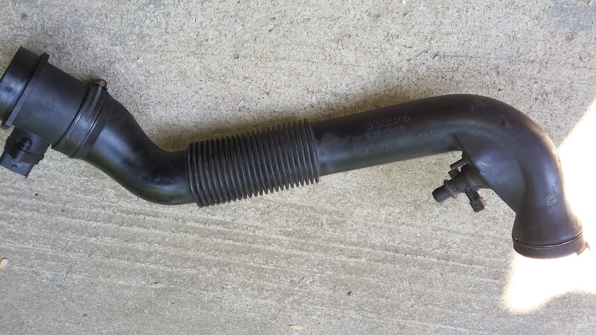

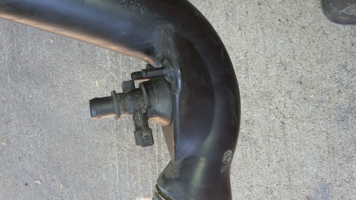

Just that one code P0236...
Do you know what this Sensor is called just be the turbo..? Also how do I remove it, maybe a way of testing it?
What I did Find is the Electric connection was Full of Oil.. 2 months ago I had the oil seal for the rear camshaft go oil ran all down that area.
I wonder if that would give me a faulty reading?
When I 1st seen it I thought it was grease like I put on all my connection, but as I got ready clean this pipe I noticed it was motor oil inside the plug...
Here are 2 pictures I d8nt know why they alway turn upside down....lol
- Posts: 36145
Well. I don't get a peep of pressure out of the red hose at idle or at revs. I used my IPD wastegate adjust valve and a 6mm to 6mm adapter between the red and silicon blue hose, and get nothing
Ill confess I don't see how the wastegate can get opened from standstill without working pressure which would have to be there......
