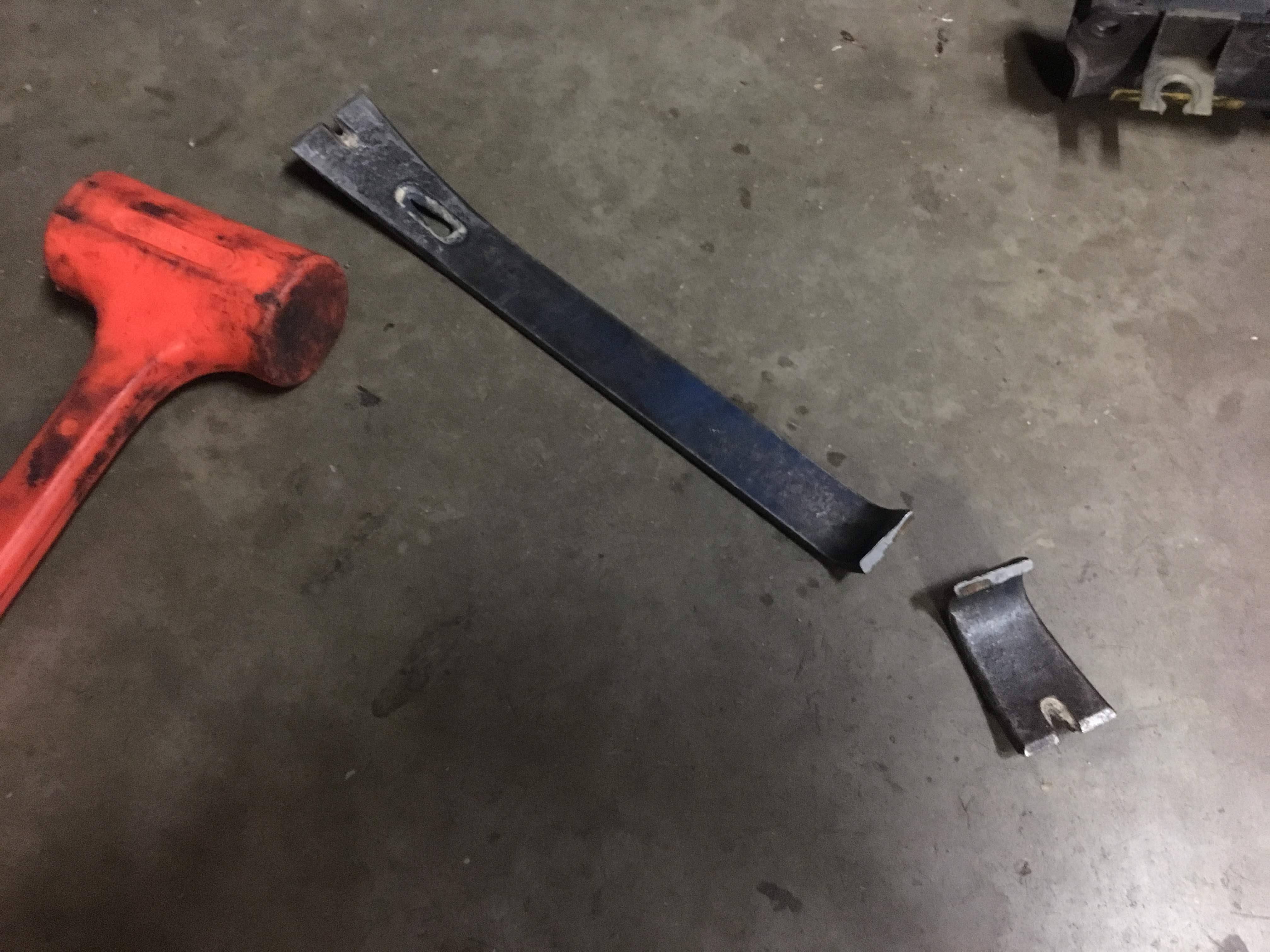

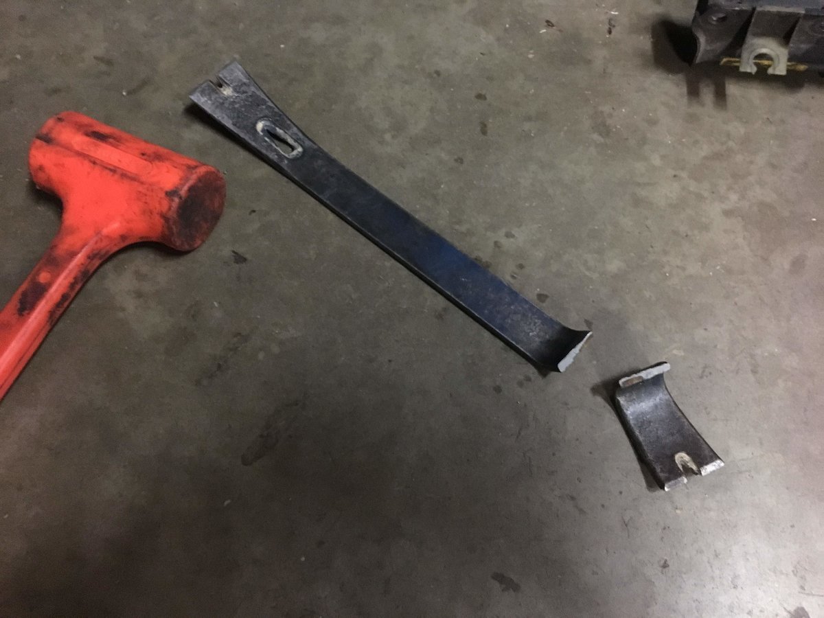

I need M56/AW50-42 axles, I'm actually trying to get rid of a set of those axles as well, haha. Believe it or not my AW55 axle fit better than this cheap piece of junk! Even though it wouldn't engage in the trans.

It has now claimed the trusty old Vaughn Superbar... goes to show just how tight it's in there. Hasn't moved a millimeter!
This axle isn't coming out without a serious fight!

So after my cousin checked it out, we decided to leave it as is. The axle has about 3/4"-1" of shaft between the "cup" and the axle seal, but it looks to be sealed. The axle is fully seated in the hub as well, and it's torqued to spec. Finally took the first test drive up and down the street and it runs and shifts great! No noise or anything from the axle, so I'm going to just keep an eye on it. If it leaks or moves, that's when I'll worry about it.
