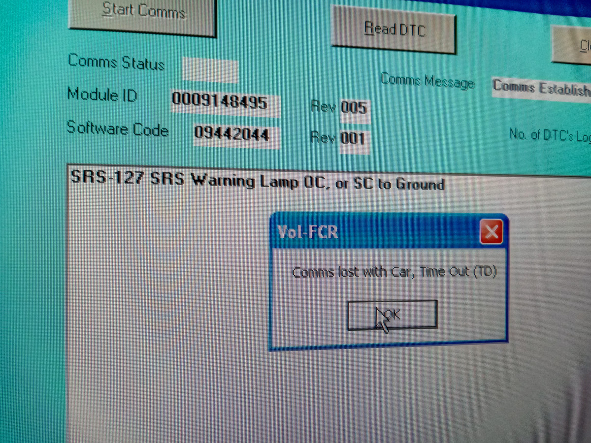

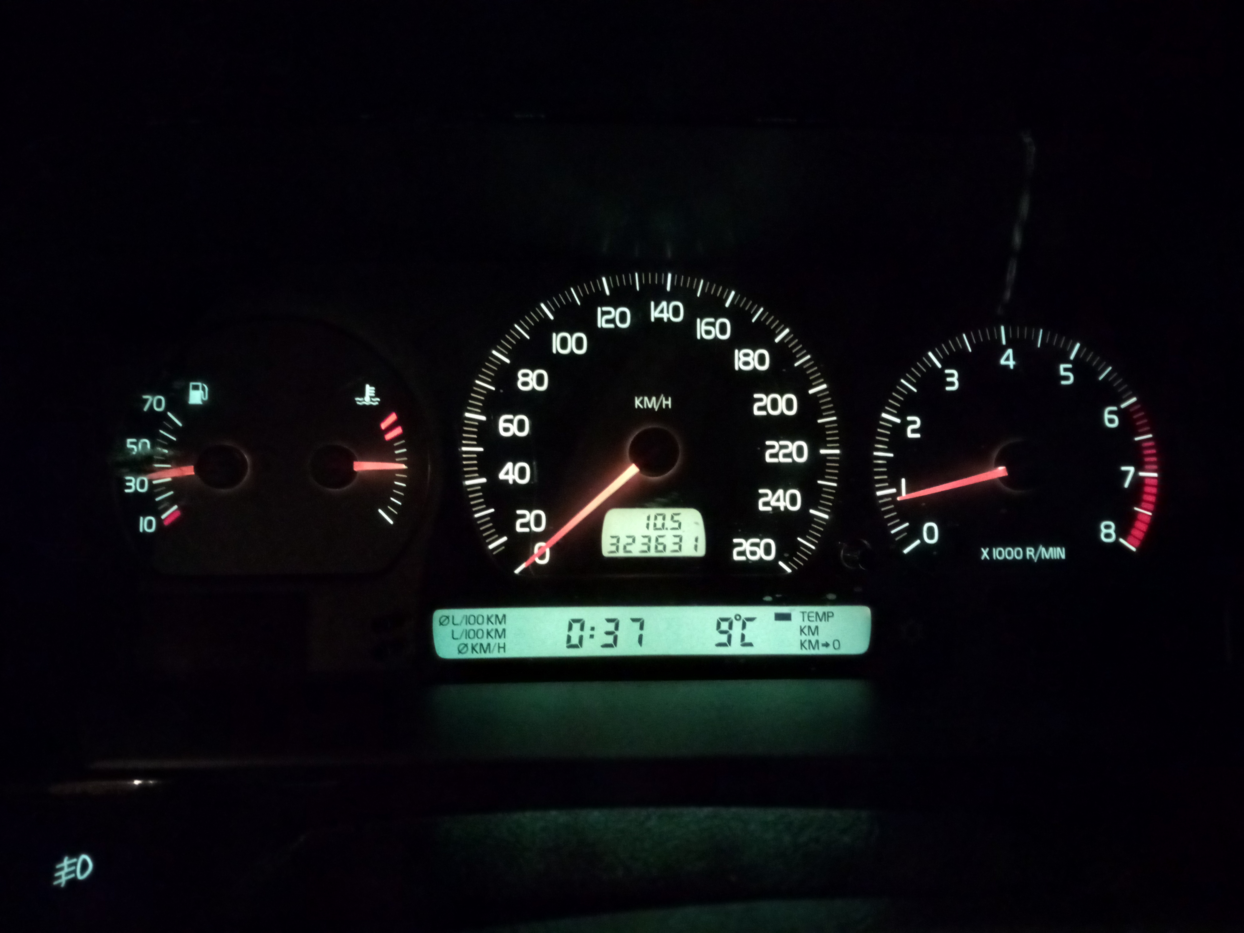

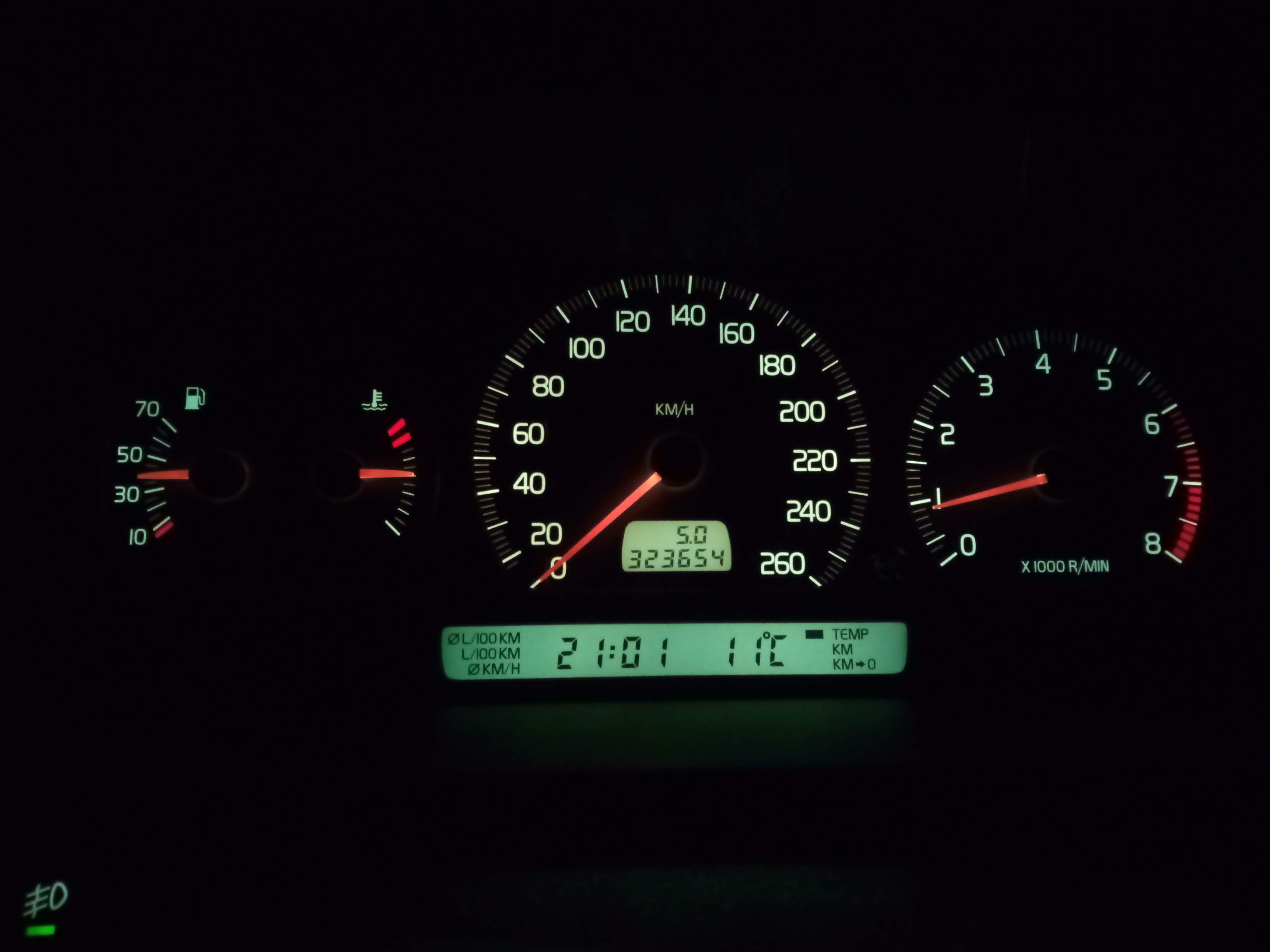

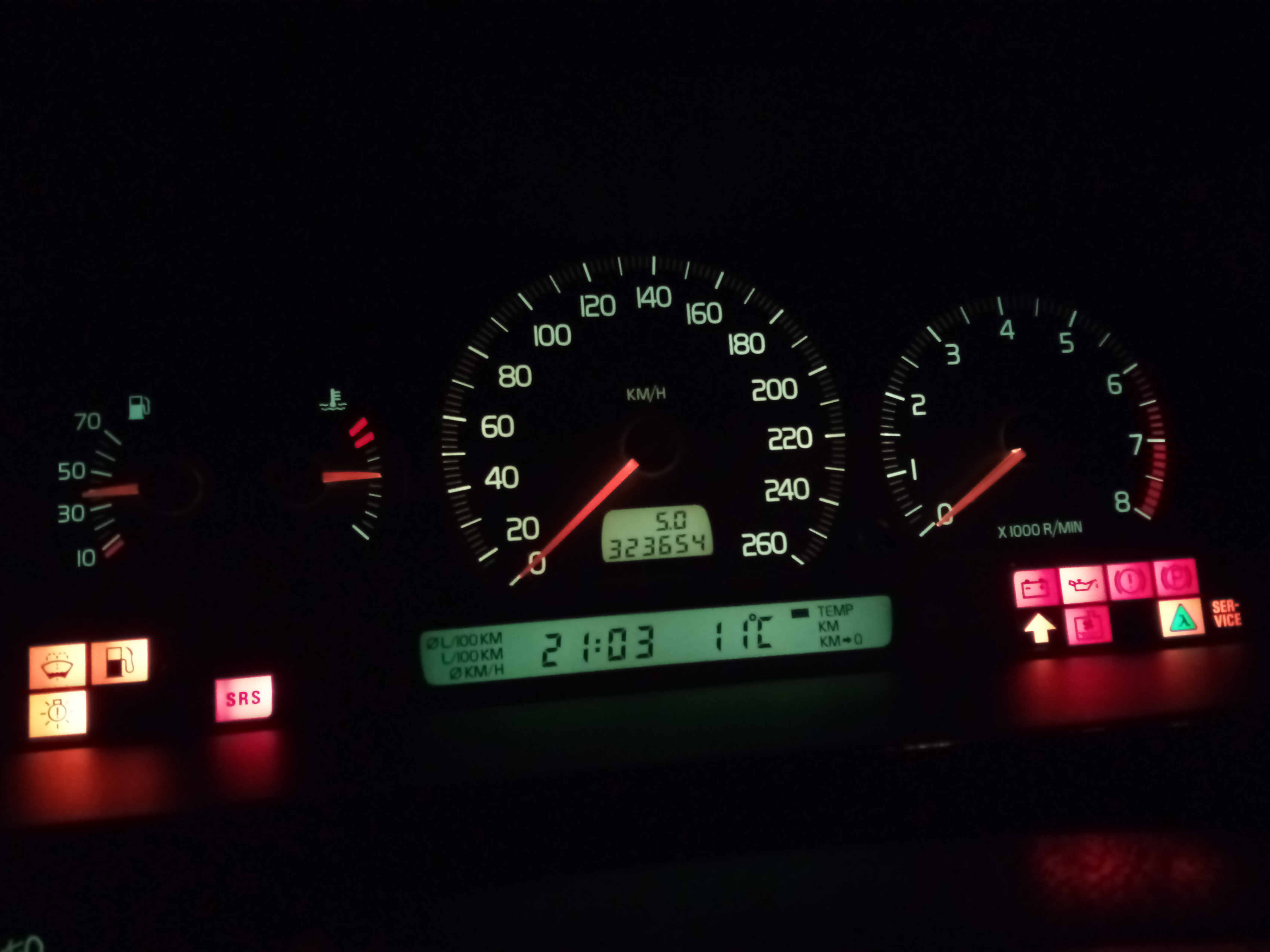

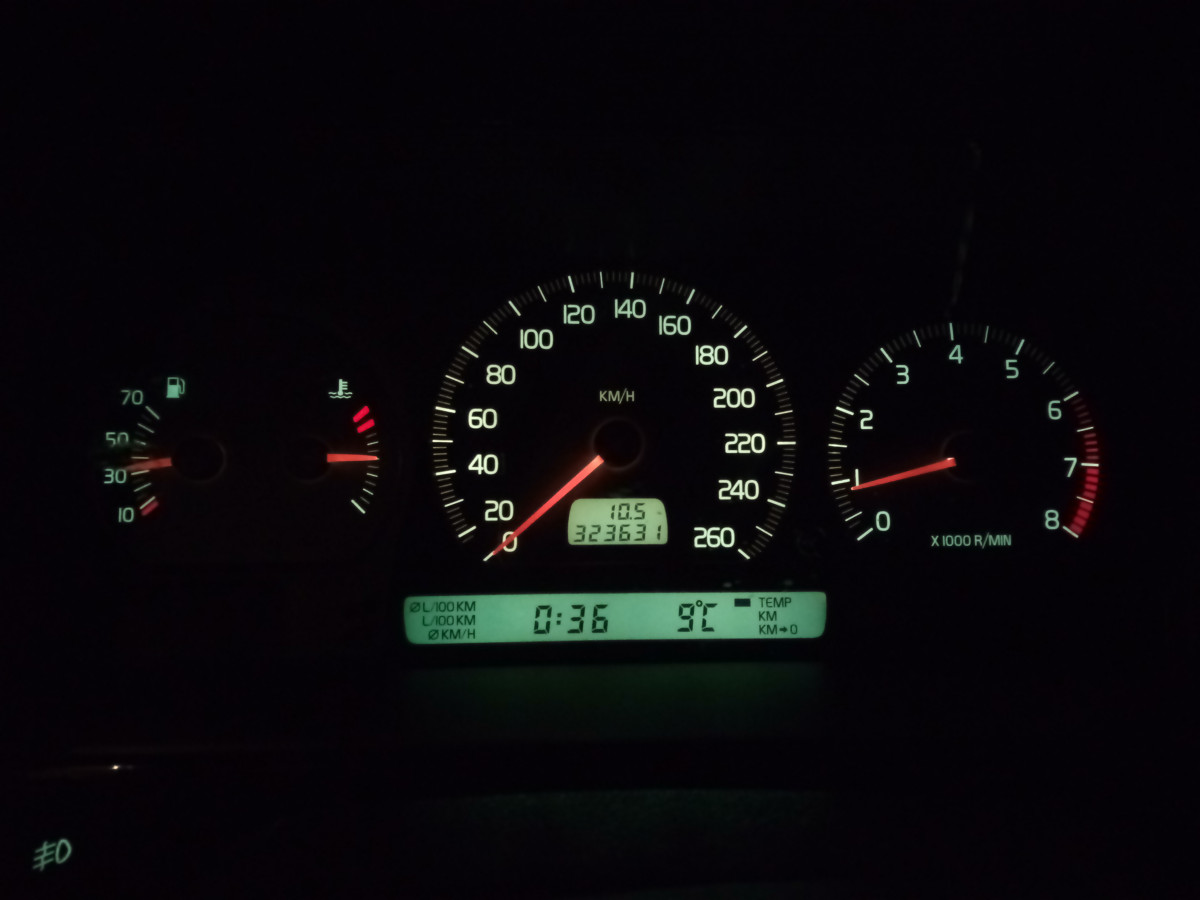

Here are the pics of S,v70 cluster into '97 850:
And here is Vol-FCR SRS scan result:
The problem is abscate...that the light is probably disabled on the circuit board by previous owner.
SRS light is not illuminating with other little lights when key is in pos.II and that is the only SRS code,because of the cluster.
It's not showing any kind of problems with SRS system,but i'm worried can a DTC for SRS warning light OC(open circuit) or SC (short circuit) to ground disable SRS system.
The cluster came from the Volvo junkyard.

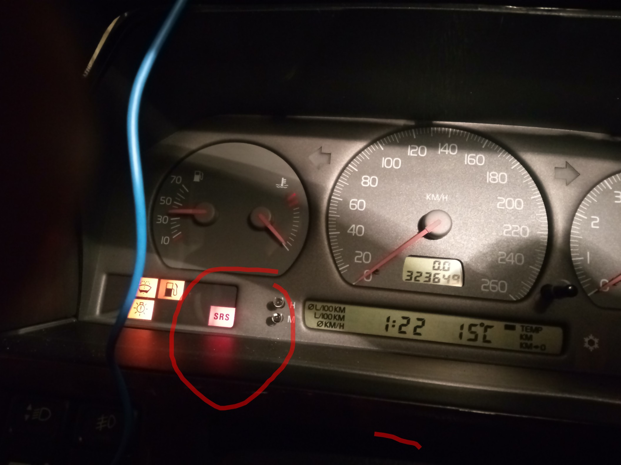

SOLVED!!!
In order to have properly working SRS warning light and no SRS 127 code stored in SRS system,you just need to add a wire from ignition switch(x-supply,yellow violet wire)to connector "B" on pin B5.
B5 is spare in '96 & '97 850.
That's all.
850 broken odometer gears...permanent fix!!!
That's all.
