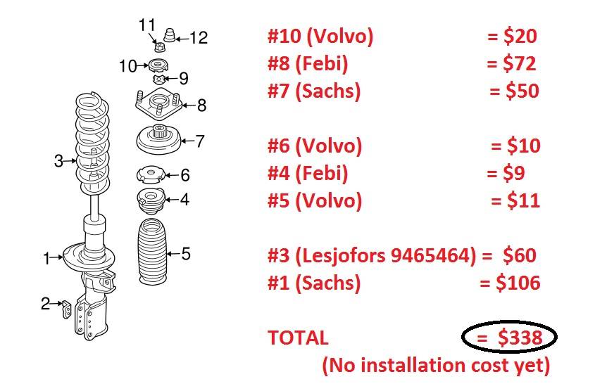

I just did a quick math what it costs me for quality parts (preferably made in Germany or good Euro countries etc., no Chinese stuff).
It is $338 each side, not including installation cost (forgot to factor in the cross nut #9 when I did this photo; $10/each).
If FCP were to do this service (assemble the whole set for the customer), it'd cost even more.
So you can see why Sachs Quick Struts, at $260, have been popular. The problem is: we only know the strut is Sachs, and have no idea where each individual component comes from...

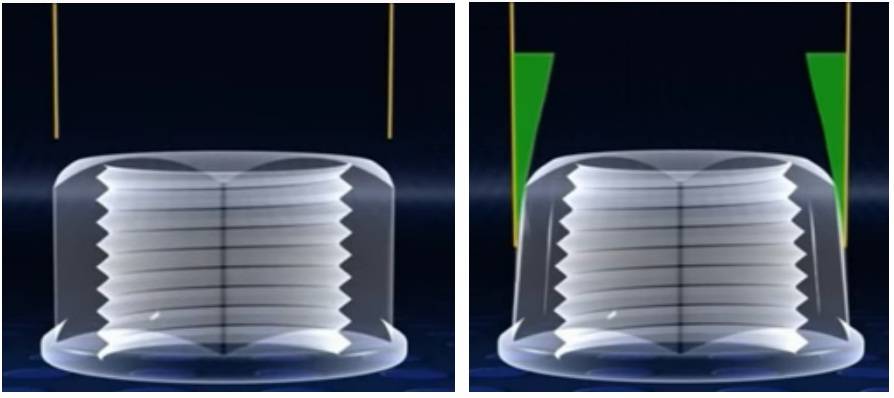

I find out the why the Lemforder End Links have such tight lock nut.
It is called "Stover Lock Nut"...during the mfg process, the top of the nut is squeezed a bit,
creating a conical shape, as you tighten it, once you hit the conical part, it is very very tight.
I only wish they squeeze it less so it is somewhat tight but not tight enough to destroy the Torx
bit used as counterhold!
Anyway, heating just the conical part definitely helps a lot bc it expands the nut.
Even with heat, it was still tight!
Another possible trick is to use a junk bolt with the same thread pitch and just tighten the nut in
and out multiple times to loosen the nut a bit (use oil on the threads).
Or just use a standard nut, just add Loctite when doing it.
Anyway, see the video below to see how a Stover Lock Nut is made...
