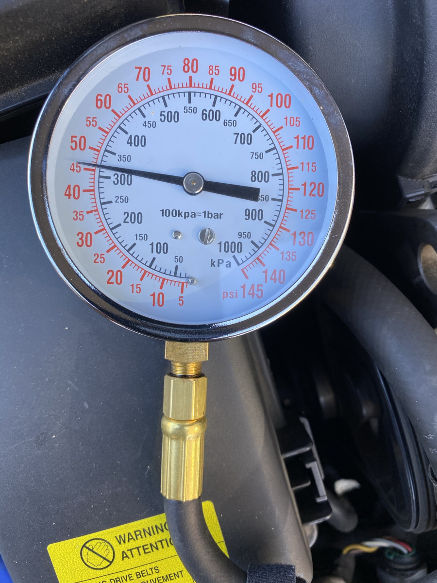

I think it is due to Vida measurements is absolute pressure and the gauge measures relative pressure. This explains the difference of 100kpa/1bar.Rvolvos wrote: 05 Dec 2020, 15:31 Ordered a CTA fuel pressure gauge from Fcp.
Gauge shows 300 kpa & Vida shows 400kpa while idling.
The FPS has been replaced at 175k. Which one is correct?
Vida did not detect any codes.

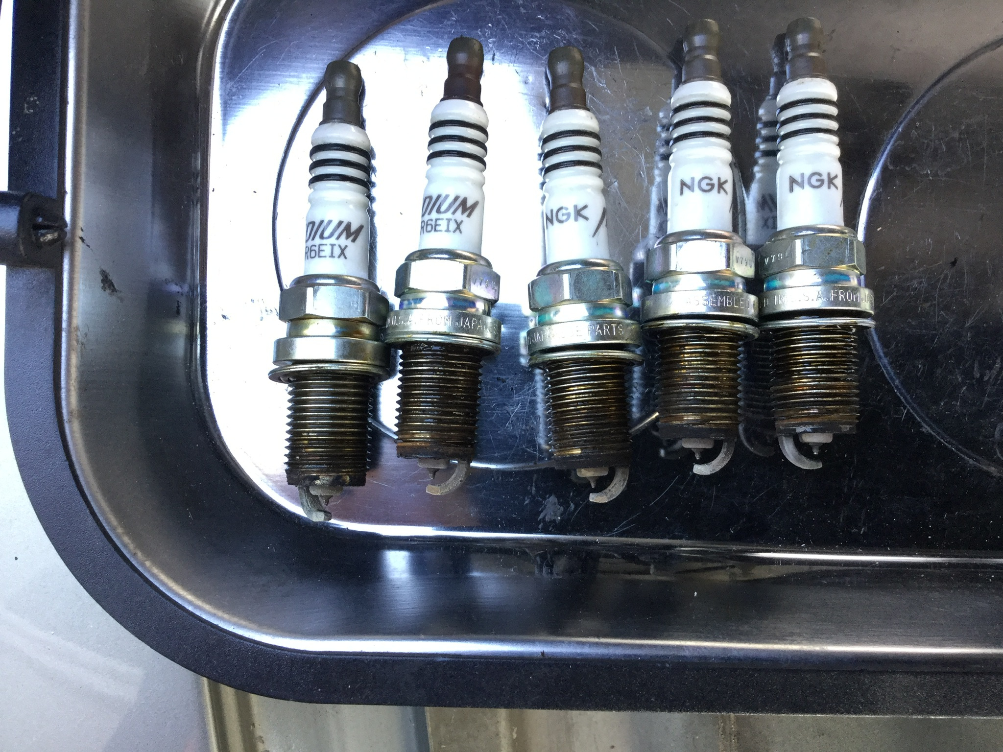

I did a dry compression test on a warm engine. Compression numbers where 165,160, 167,170,165psi
Looks healthy to me @194k.
Checked the spark plug gaps, the where between 0.75-0.8mm. The color of the spark plug looks oké too.
Top of the cilinders have some carbon build up, cilinder one has a shiny spot on the carbon buildup. It’s not gas. Left the spark plug out for 24hours with out a change in color.
Left the fuel gauge connected for 24 hours and still showing 46psi/320kpa.
Next I will be doing the fuel pump test in Vida. And have new antenna ring on order.

Spec pressure 52 psi.

I still don't like that you don't have spec fuel
Pressure
Pressure

For clarification the last picture of the fuel gauge was after the car was turned off for 24 hours and still holding pressure.
I did run the fuelpump test in Vida and the pump was able to follow the whole curve.
