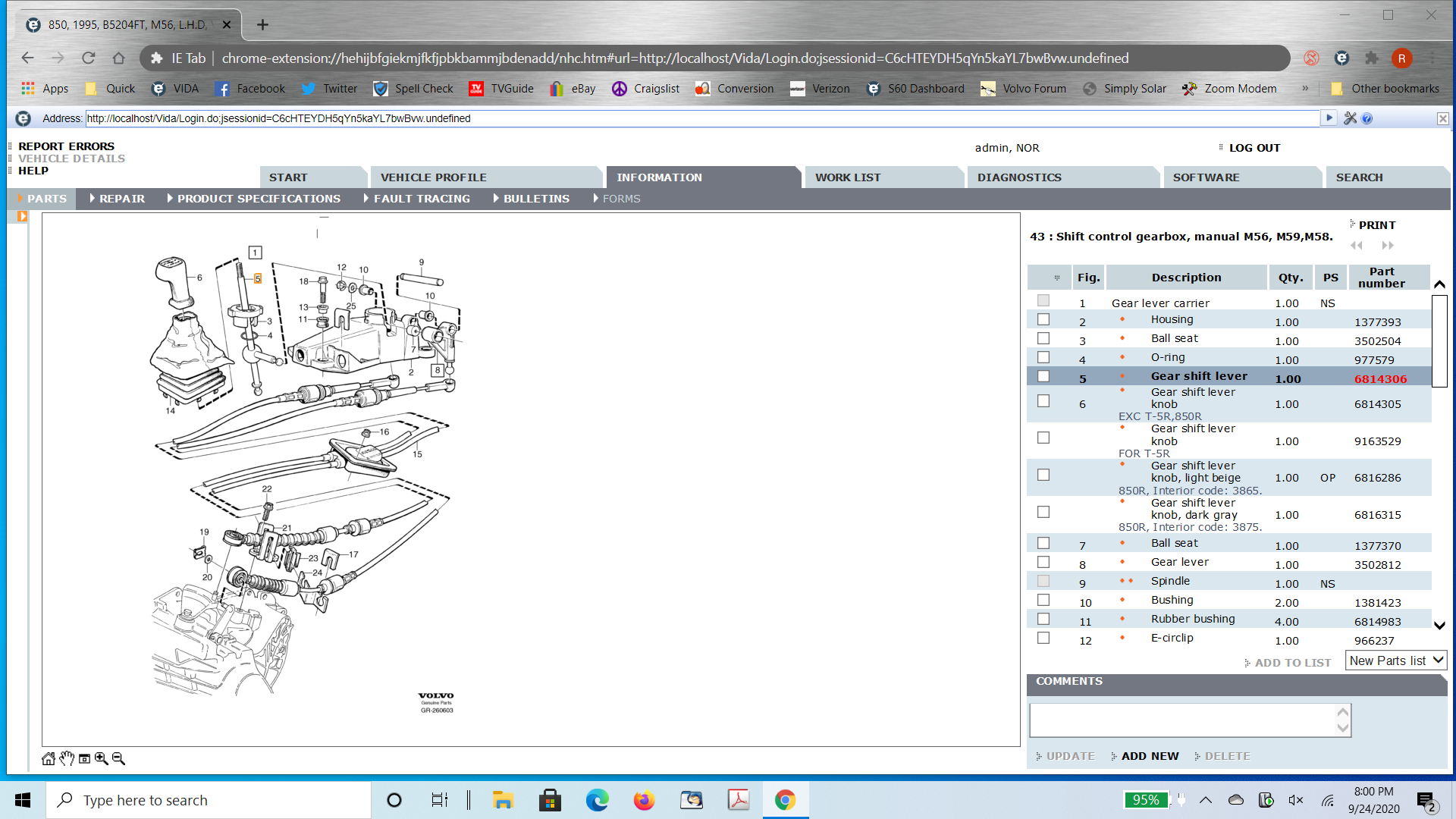

I'll do the test today, however, again, when driving yesterday, downshifting from 3rd to 2nd, it didn't quite want to go in and suddenly I heard a crack.
Now bottom row of gears is basically gone, I can get it into fourth with some ease, but second is wayyy wayyy far down and reverse is near impossible to find.
First, third and fifth are fine.
Gear shifter linkage? What should I check out?

Odds are OK. Evens are not. The linkage is two cables. My first guess is you cracked the plastic shifter base rendering one of the cables inoperable. Have somebody work the shifter as you observe the linkage cables at the transmission.fantajuice wrote: 24 Sep 2020, 09:25 First, third and fifth are fine.
