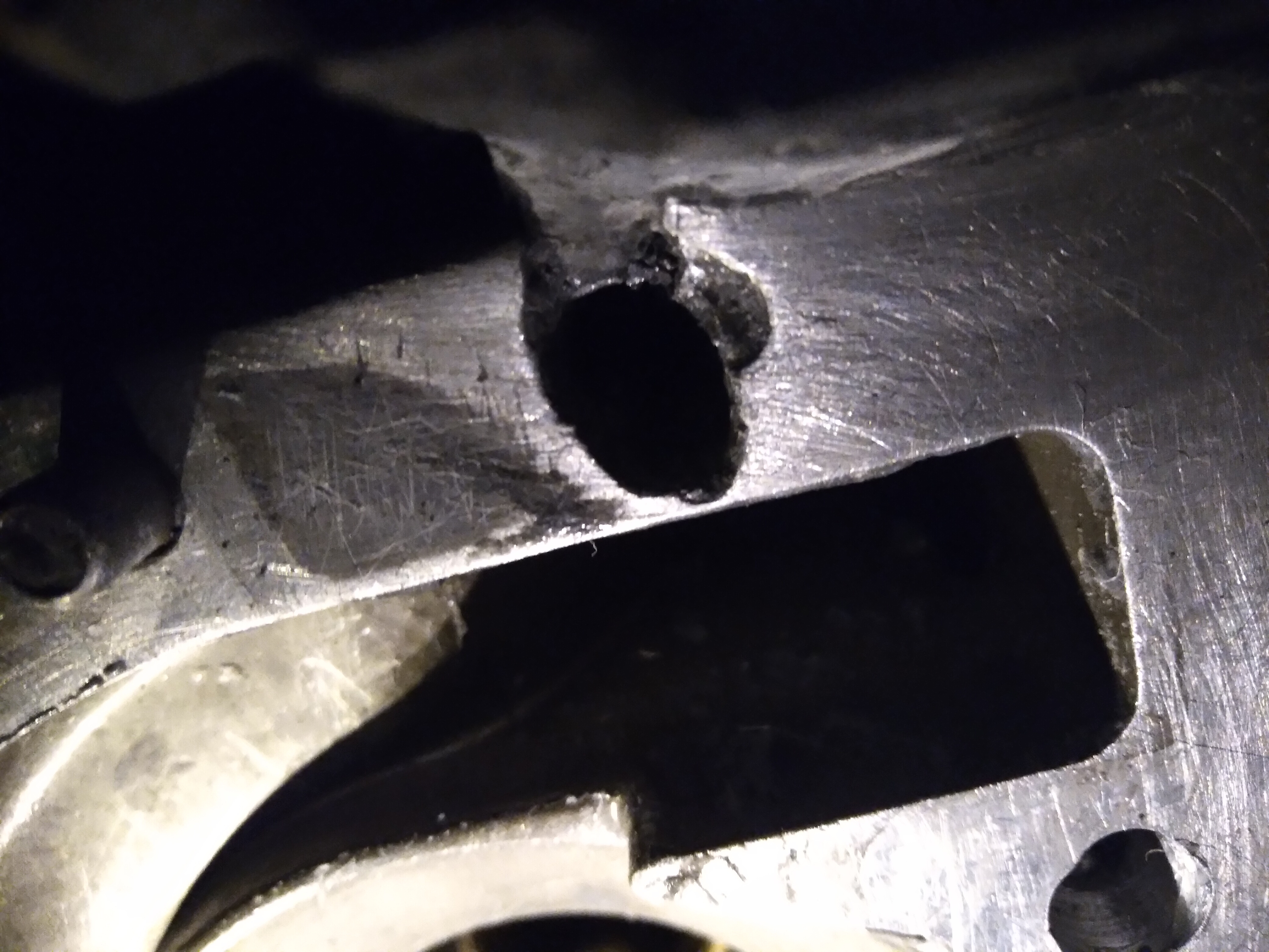

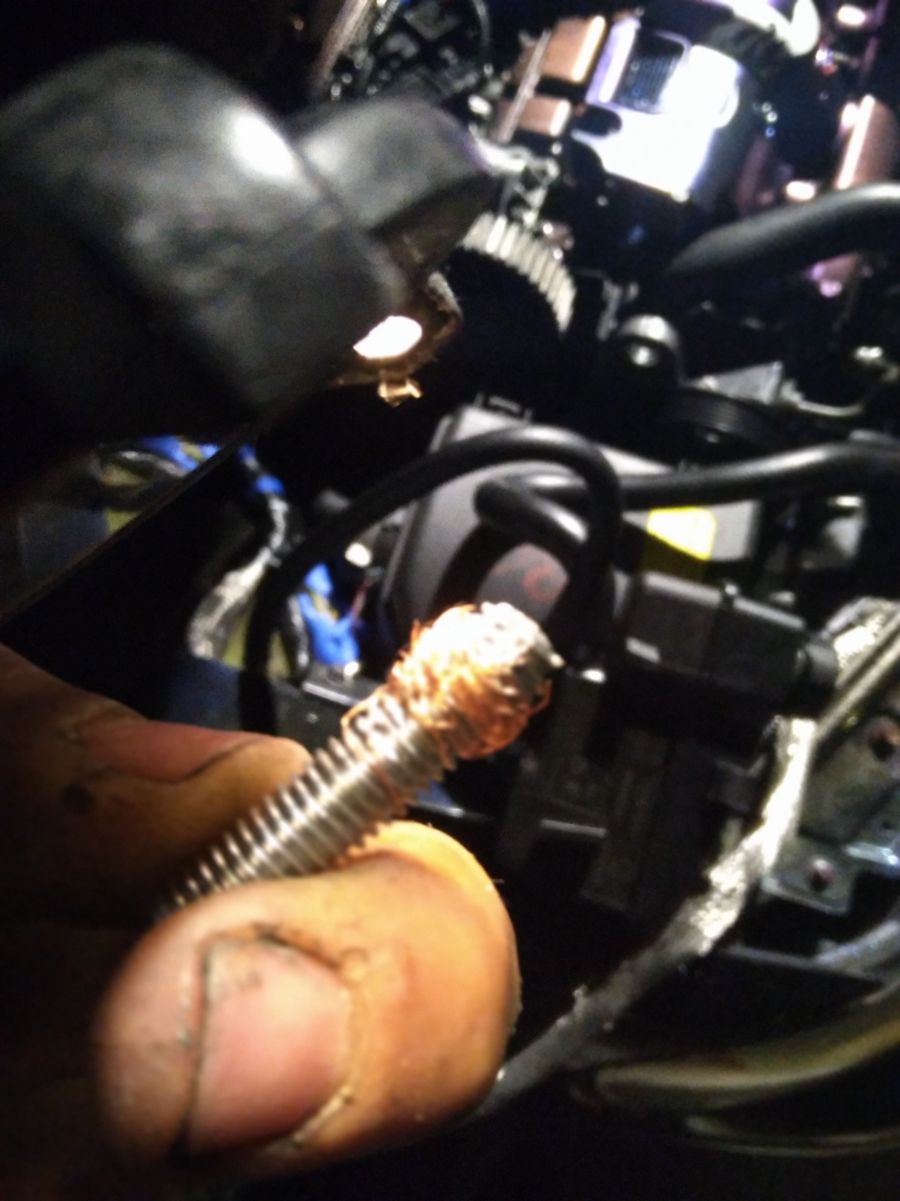

So this is where I'm at. I went and purchased a 100mm length of an 8mm stud and cut off a piece a tad longer than the original bolt. I then cleaned the mating surface around where the hole is.
Smoothed surface
Smoothed surface
I used a piece of copper wire to wrap around the end of the stud where it would be screwed in at in hopes that it would act as a filler to squish into any misshapen crevice inside the hole and possibly provide an extra 'bite' which in all honesty it kinda feels like it did.
wrapped stud with copper wire

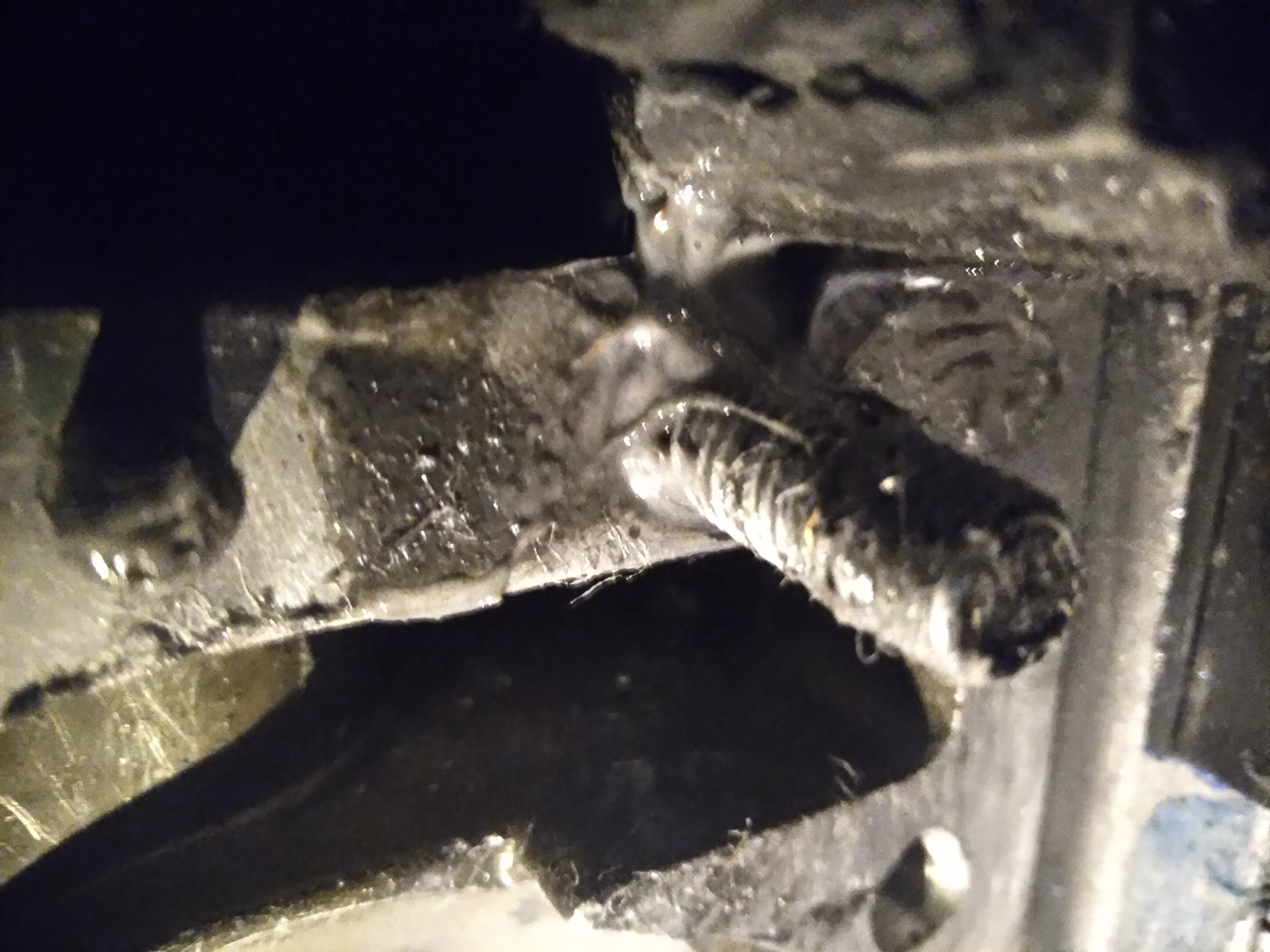

Then, using nozzle tip, i 'injected' the JB mixture into the gouged hole before inserting the copper wrapped stud, copper wrapped side first, in the hole as well, turning it and tightening it carefully with soft ended vise grips to not damage the studs treads.
installed stud in hole filled with JB
I then smoothed out, with my finger any extra goop from the JB. I will now wait overnight and tomorrow will get back to it to sand it down smooth at all the places it will need (mostly where the bolt meets the block. Then once smooth and dry, I will install a green Volvo gasket with an Aisin water pump. Fingers crossed.

It looks like you got JB on the threads ... not good.
If you have some Acetone. Do this before it dries up. Dampen, not sopping wet, dampen a rag with the Acetone and wipe off any excess JB Weld. JB weld has one chemical weakness and it is Acetone. Acetone will will clean off JB Weld but you need to do so before it cures.
If you don't have a can of Acetone. Raid her cosmetics. Acetone is a a major ingredient in a lot of fingernail polishes. Some fingernail polishes are 100% Acetone.
Once cured there are only two ways to remove JB Weld. Heat 600° F or higher or grinding.
If you did not read this in time. Micro torch a spot then brush off with a wire brush. Do a spot at a time. You do not want to get the JB in the hole above 600° F. That would decompose and weaken the JB weld in the hole.

Cleaned stud threads with pure acetone. Threads are nice, clean and shiny now!! Thanks again for the warning.

Get the best, flattest JB weld repair and then use Permatex Ultra Gray RTV sealer part number 82194. It will be about impossible to get gasket compression to seal a paper gasket. Let the RTV cure 24 hours after you bolt it up. I wouldn't worry about that bolt. The rigid RTV sealers are used extensively and often they cut bolt count almost in half for things that aren't structural. The pump acts as timing belt idler but that is not a high load. If you really feel you need that bolt then drill trhough and use a 1/4 inch bolt with nut or 6mm bolt with nut. In either case do not tighten that bolt much. The Ultra Grey will provide a good bond that will carry some load. Do not use too much. a 1/8 round bead between bolts and a smaller anount inside and outside the bolt hole (on the seal surface but mimicking the gasket being to the inside and outside of the flat gasket seal surface of pump) is all that is needed. Too much will risk some getting loose in cooling system.

My hat goes off to you RickHaleParker, your idea worked! The water pump is holding. And thank you to everyone else involved. I do have another , very mild, roadblock still. I am very confused about the way these cams are supposed to be.
