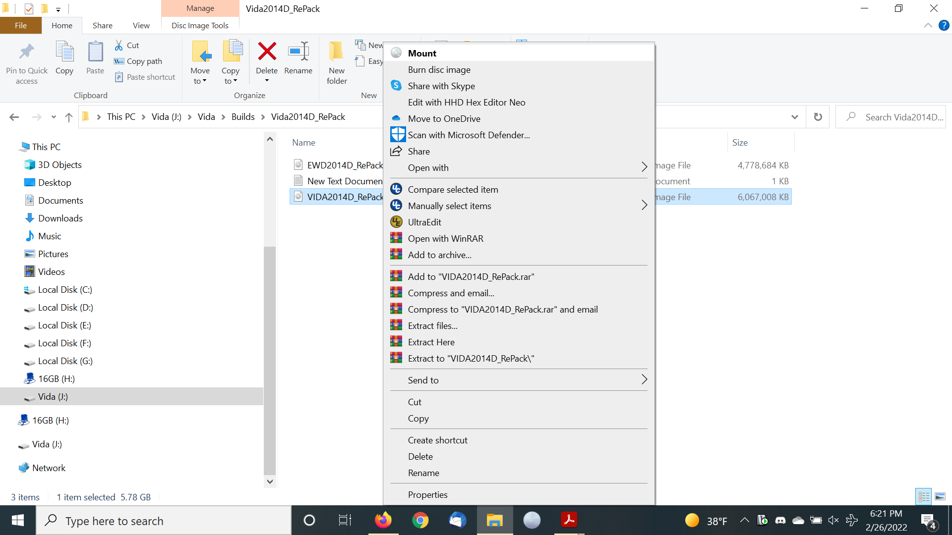

2. In Windows File Explorer navigate to the 2014D_Repack.iso. Select, Left click then Mount
I’m having difficulty with the above term ‘mount’ . I navigate to the iso. I select it … then I’m not sure what to do.

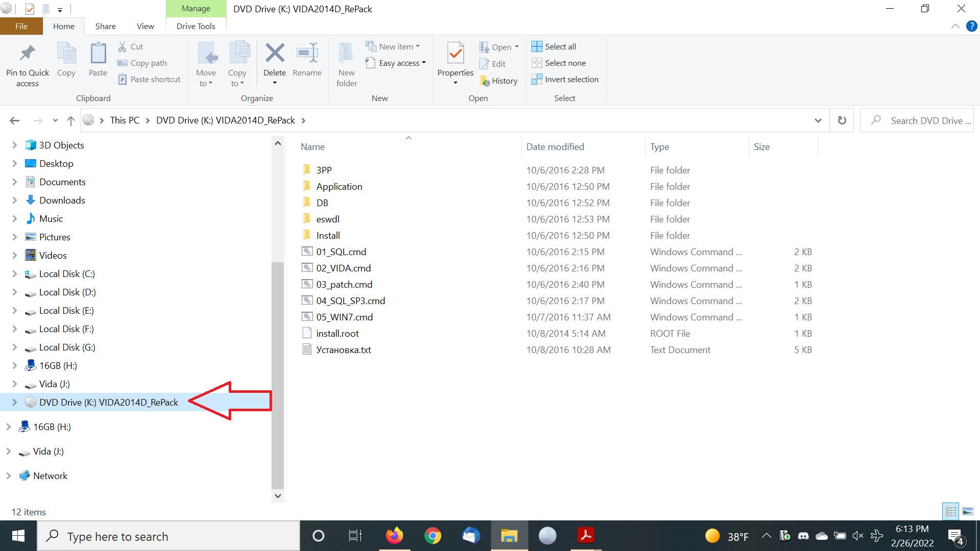

Stu70 wrote: 26 Feb 2022, 15:18 I’m having difficulty with the above term ‘mount’ . I navigate to the iso. I select it … then I’m not sure what to do.
Select the ISO, Left click and select mount from the list
Once you mount an ISO it behaves like a disk in a DVD drive.

Post by Stu70 »
Thank you RickHaleParker - I had to download a mount app. My windows 10 didn’t have that window in your top picture.
