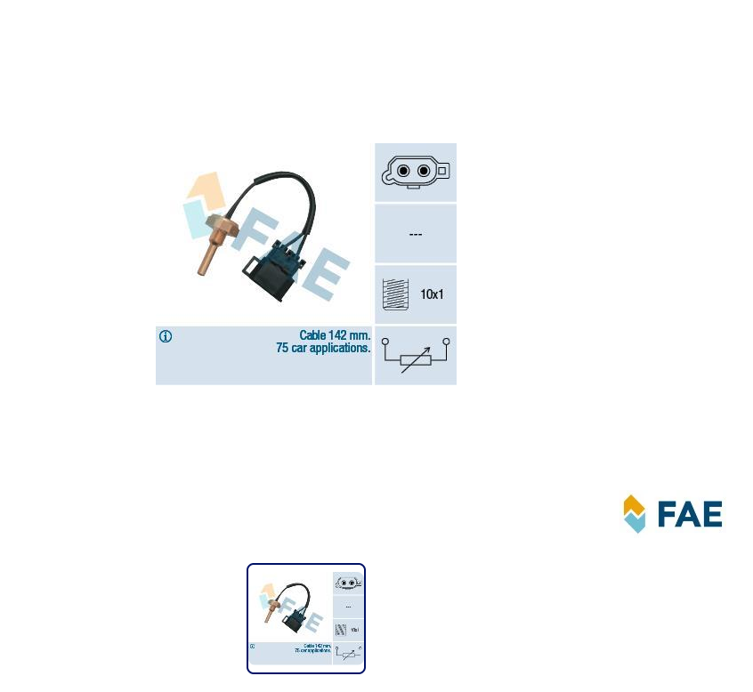

I've replaced it while i was doing the PCV kit. It's true that the issue came just after. I've driven 200 kms before to see appear the trouble... I will test the thing whit the old one.
It's a FAE
Capture d’écran 2022-12-27 à 23.30.00.png (131.45 KiB) Viewed 540 times
Here's my choice (if one is correct...) :
Capture d’écran 2022-12-27 à 23.36.13.png (12.86 KiB) Viewed 540 times
What should i take ?

Post by misha »
Remove it and toss it in the bin!
You are chasing your tail with this crap.
Oe Volvo or at least Vernet.

Post by scot850 »
+1 with Misha on the ECT.

Post by manovlov »
all right Guys. I will order one to Volvo. Thanks.
