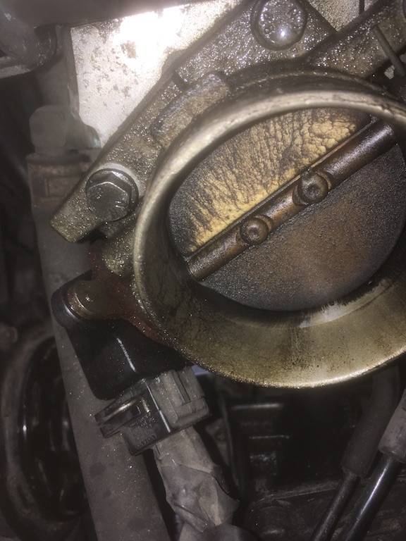

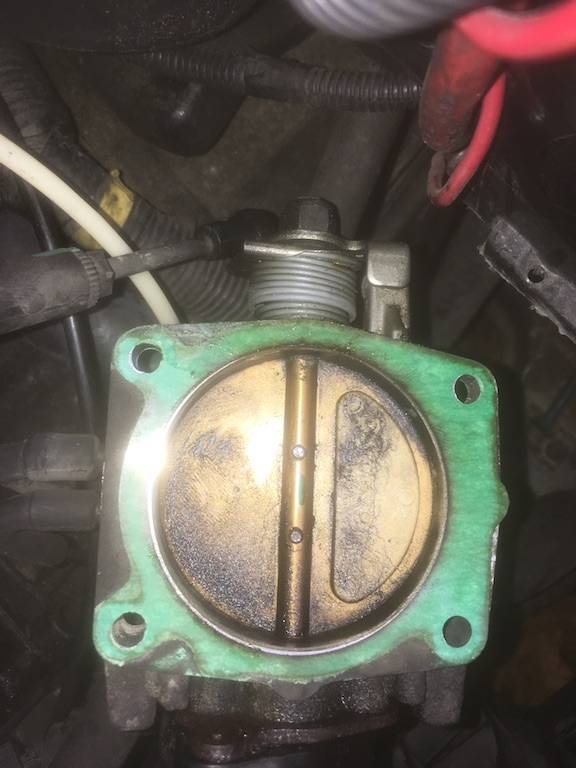

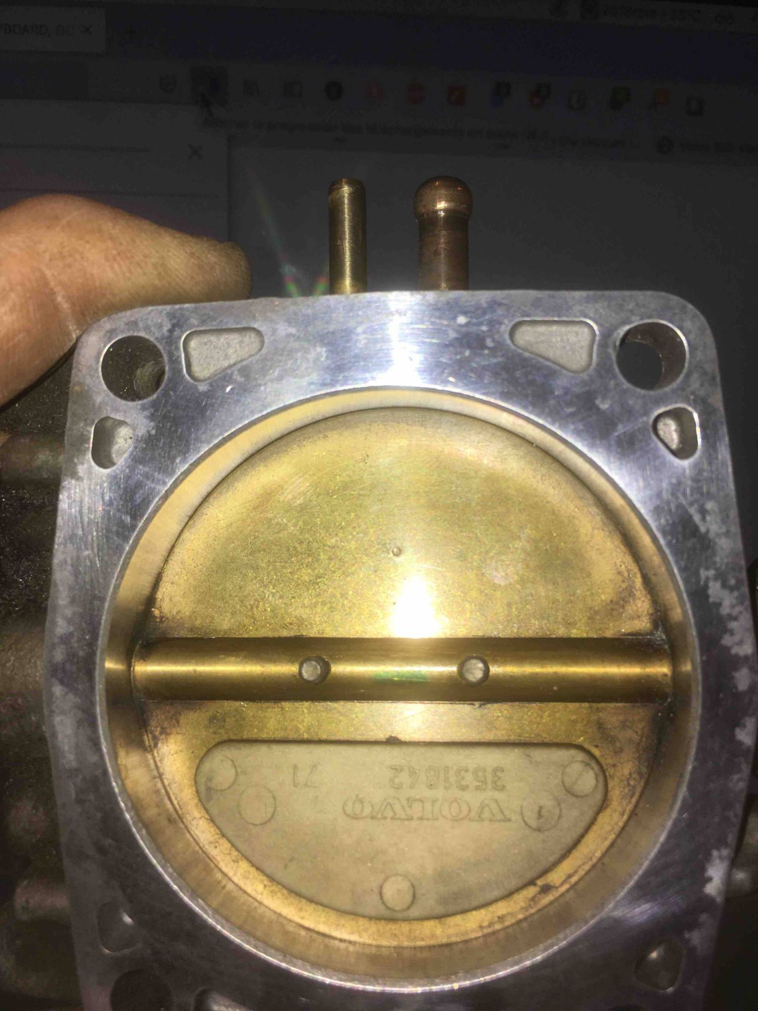

Get that throttle body shiny clean , all that oil and grime should be removed!
