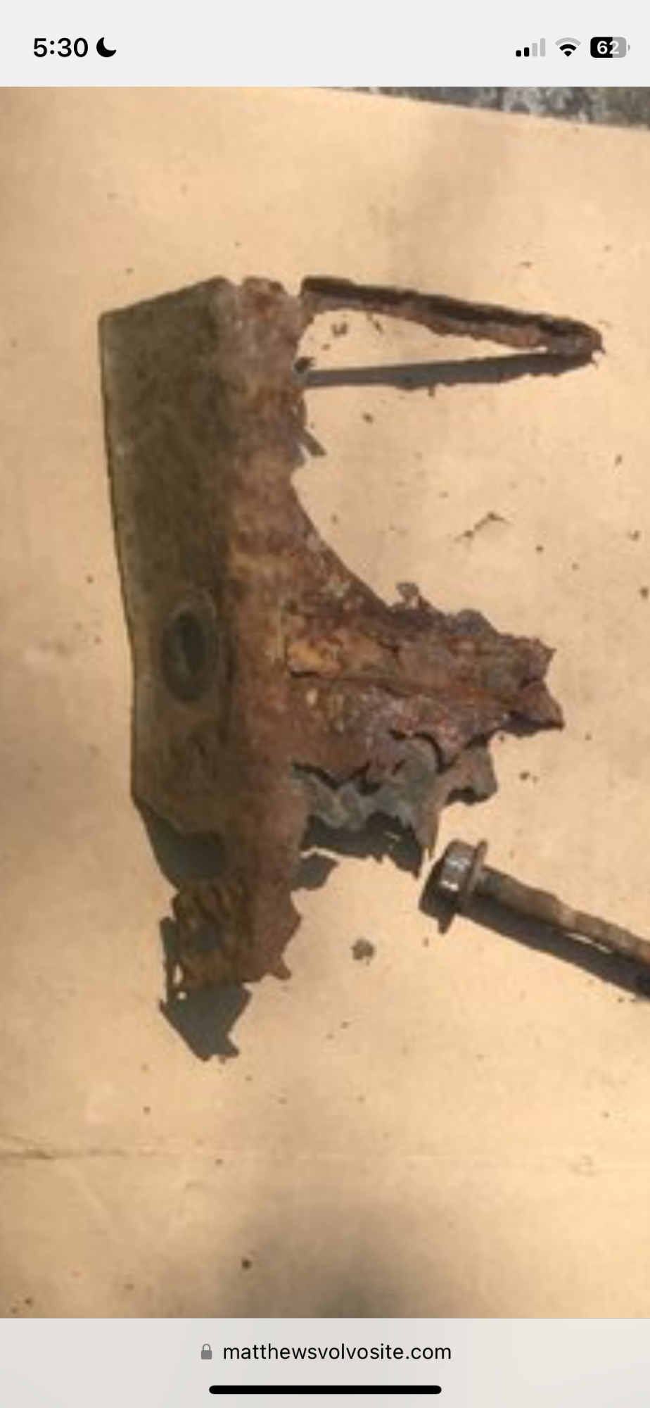

Here’s my entry for Sunday

A rear bumper bracket and bracket bolt?
