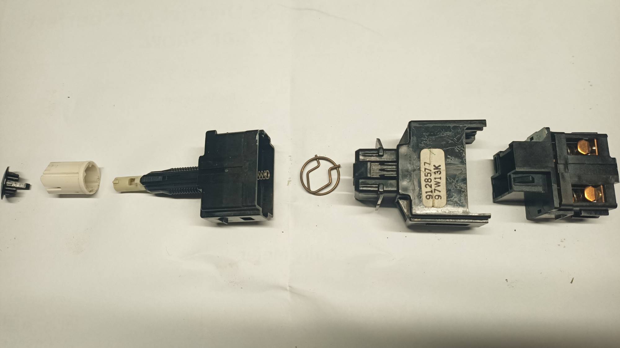

I'm trying to track down the cause of the cruise not working on this thing.
I replaced the brake light switch ($65 official Volvo!!) to no avail.
Turns out it's fairly simple to disassemble the switch and clean the two identical sets of contacts.
The vacuum pump and everything works fine, so I guess I'll check this relay thing under the hood next.

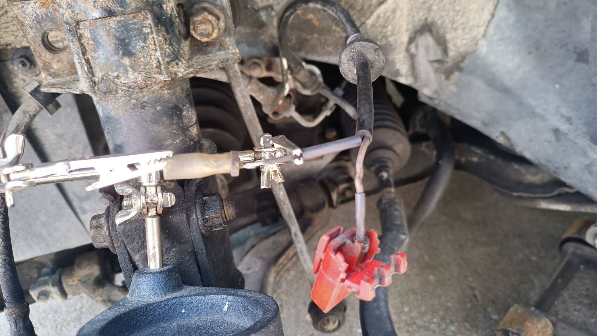

The cruise has never worked. I can make the vacuum pump pull the pedal with some jumpers. The switches on the stalk seem to test fine. Repaired the ABS unit. New brake switch..

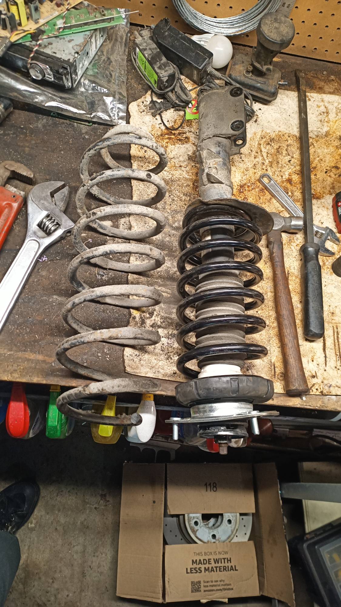

Front rotors installed.
Rear bumper cover had come loose in the past, and the exhaust melted some parts, causing alignment issues. Got that squared away and reinstalled.
Time for the front to go down. New spring versus old.
Strut seemed okay. New strut bearings, top spring cups, bump stops.
Fixed another broken ABS wire.
Current stance. Rear may need to go down just a hair.

Wow, you have been really busy knocking the challenges out. Are those aftermarket lowering springs?

scot850 wrote: 15 Aug 2023, 16:52 Wow, you have been really busy knocking the challenges out. Are those aftermarket lowering springs?
They are, the previous owner had bought a bunch of parts for it, including the springs.
