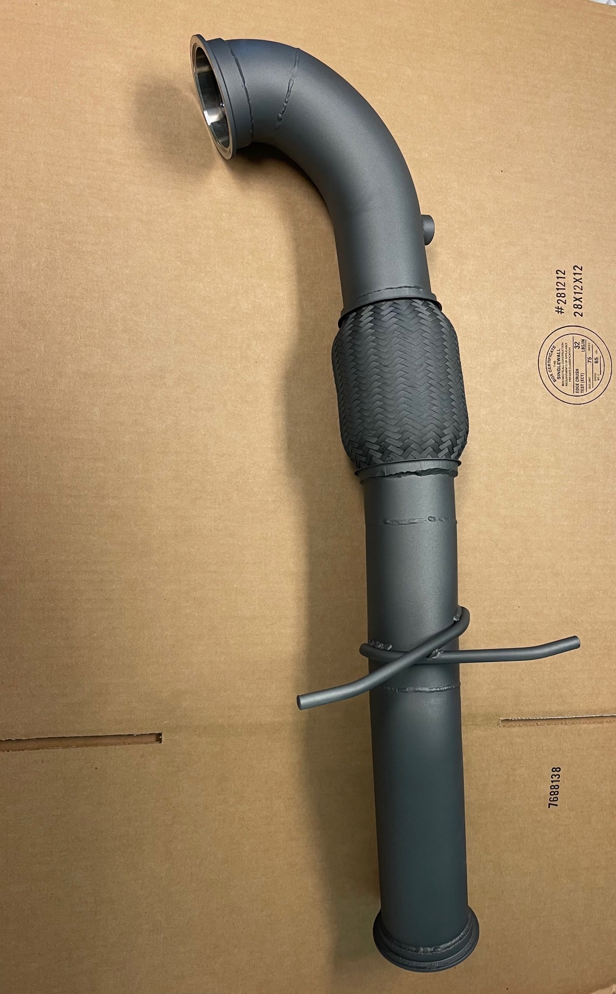

Post by precisionguesswork »

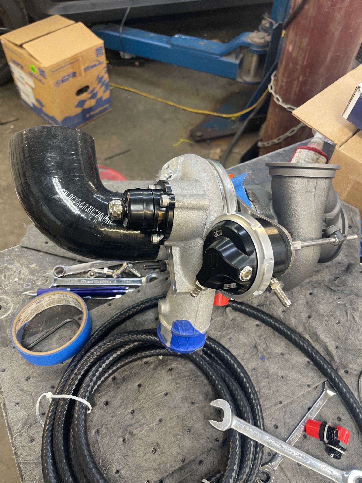

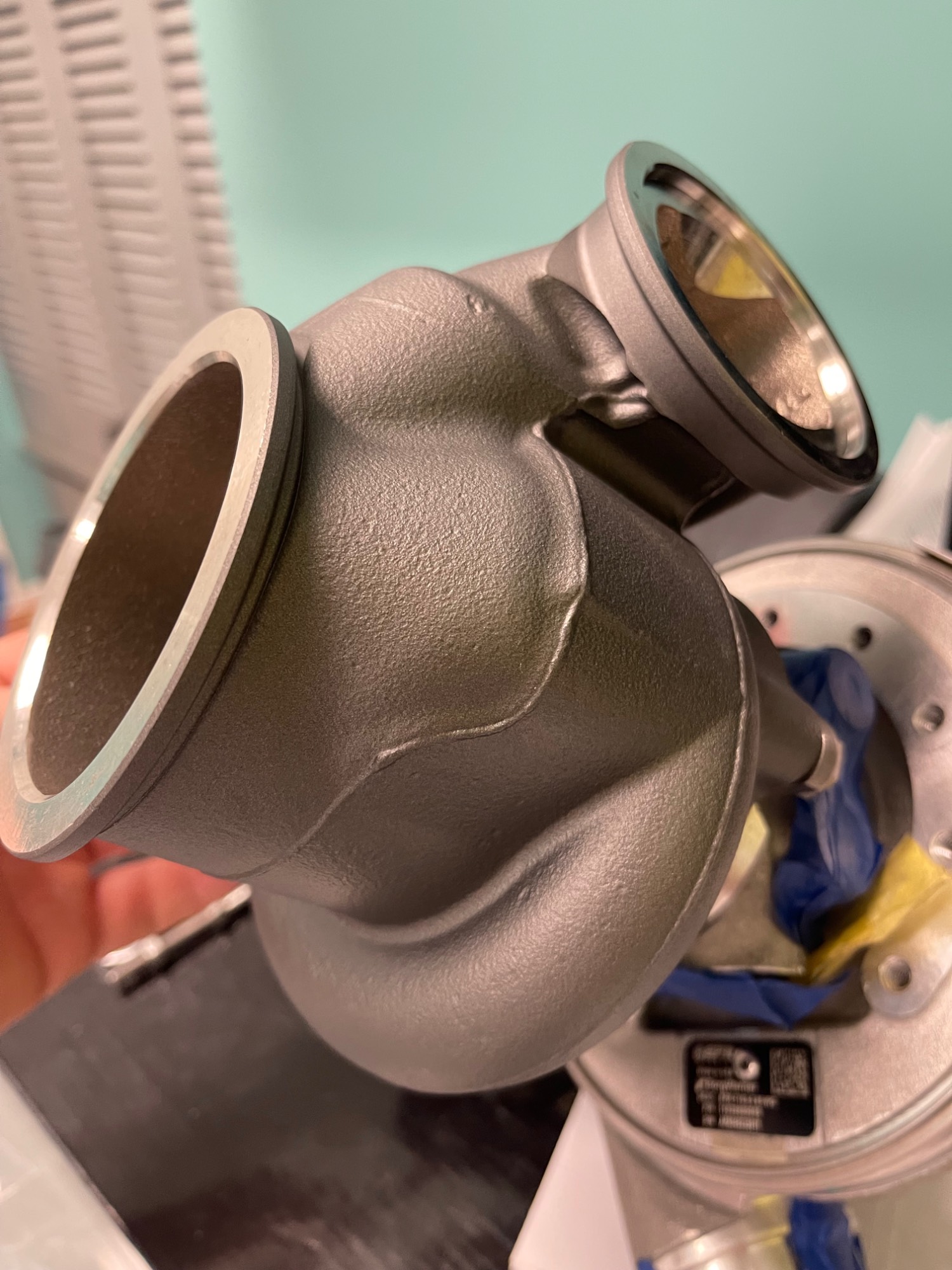

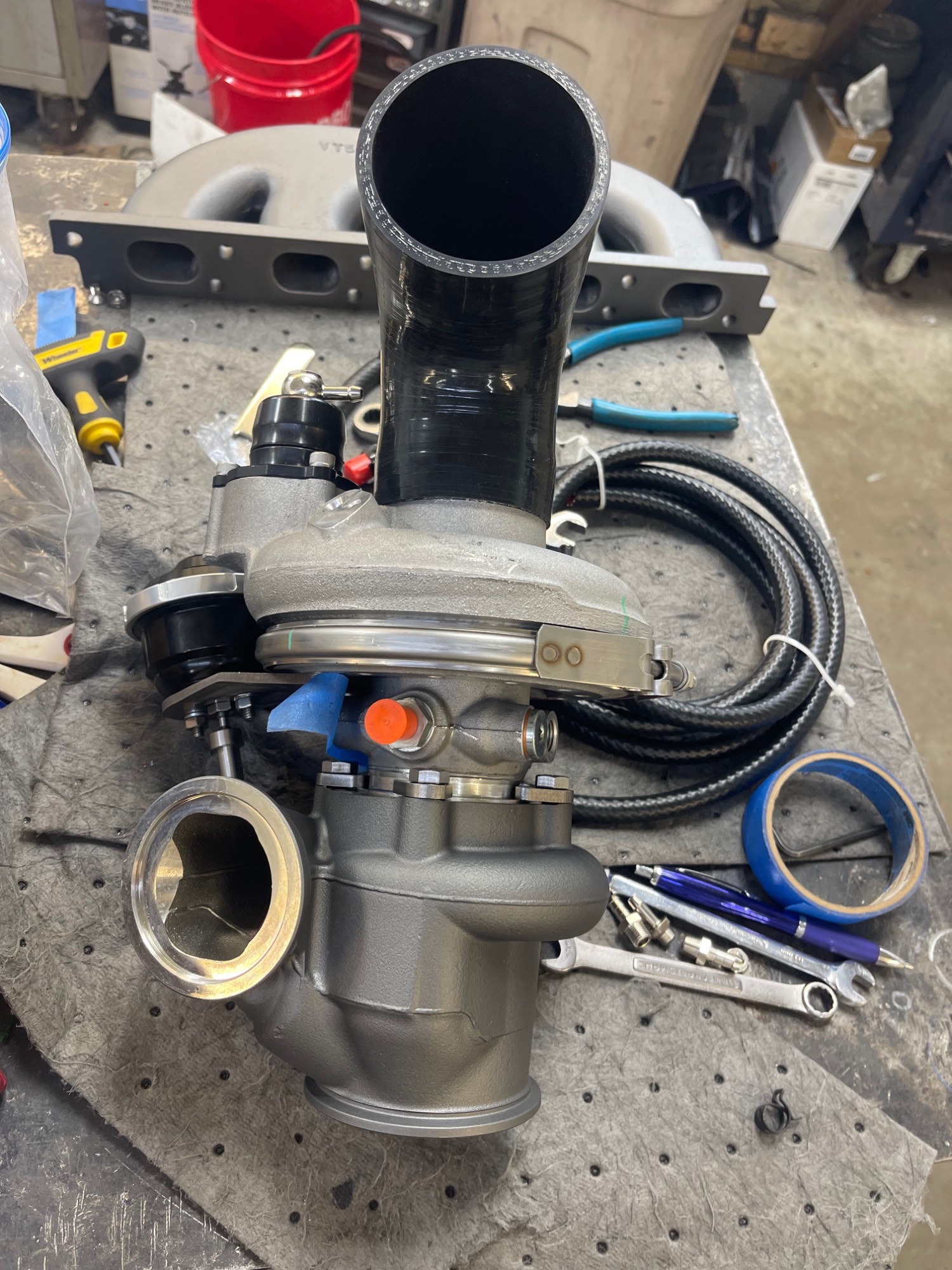

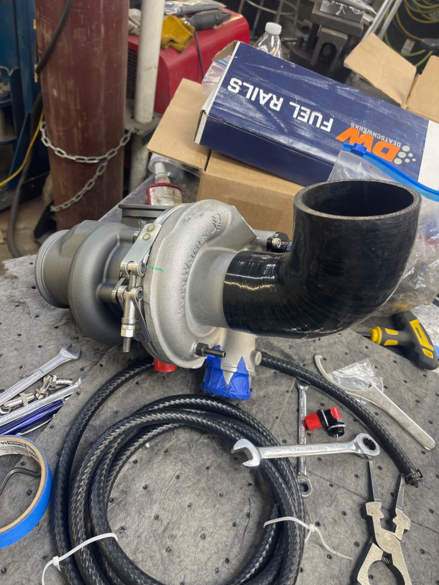

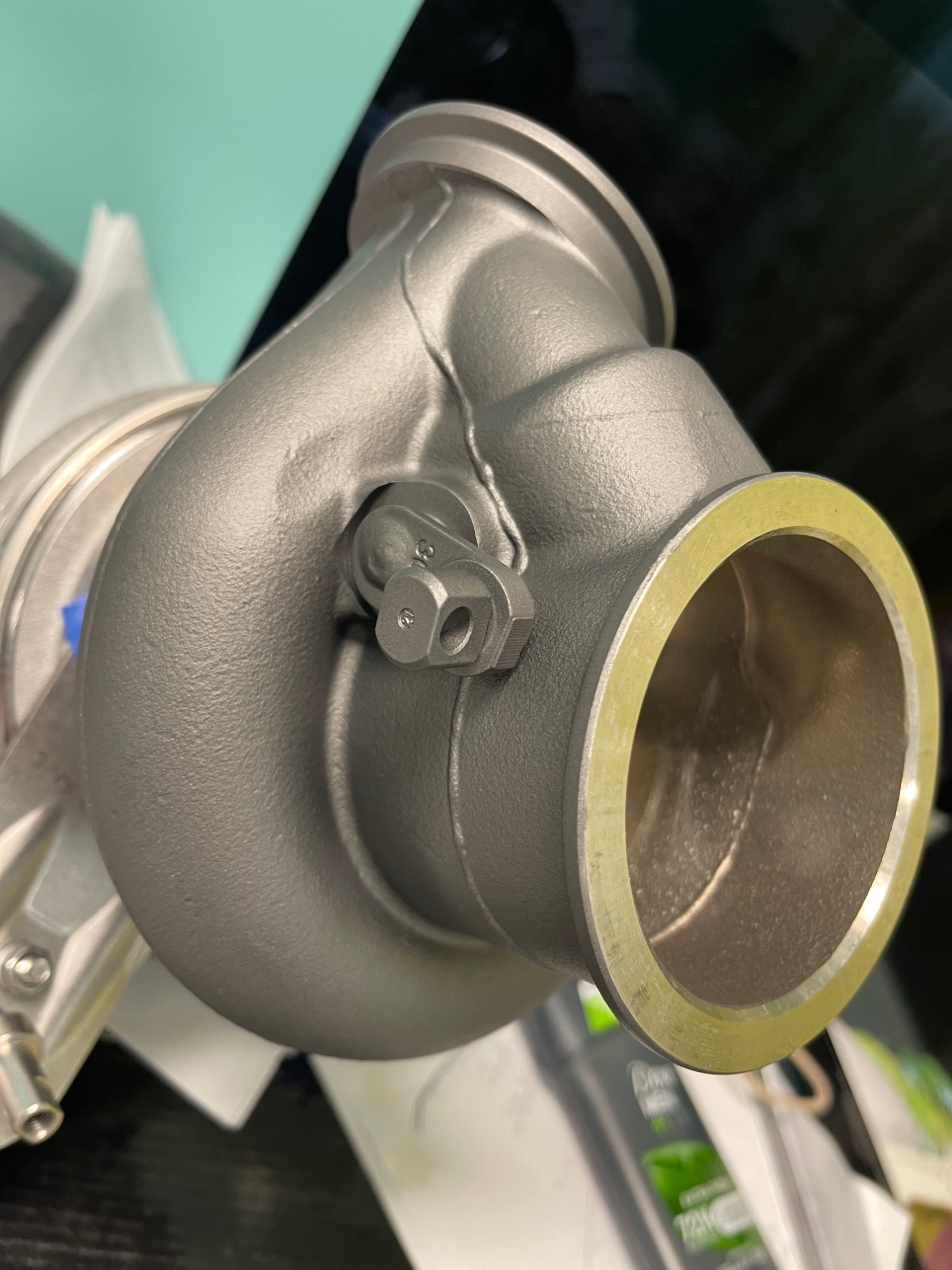

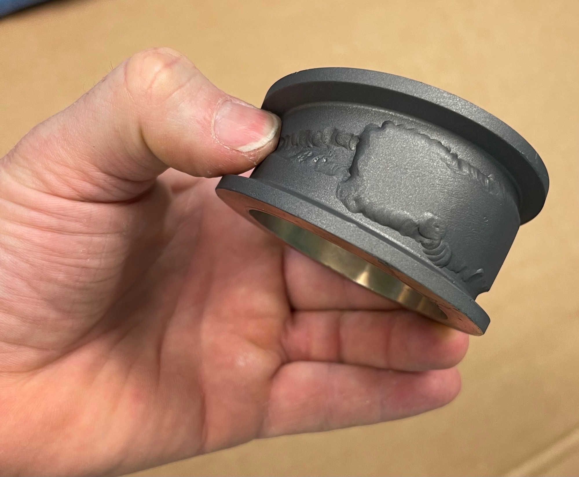

Need to weld a cast 90 onto the compressor outlet to clear the power steering lines. This bit will make more sense once I upload images

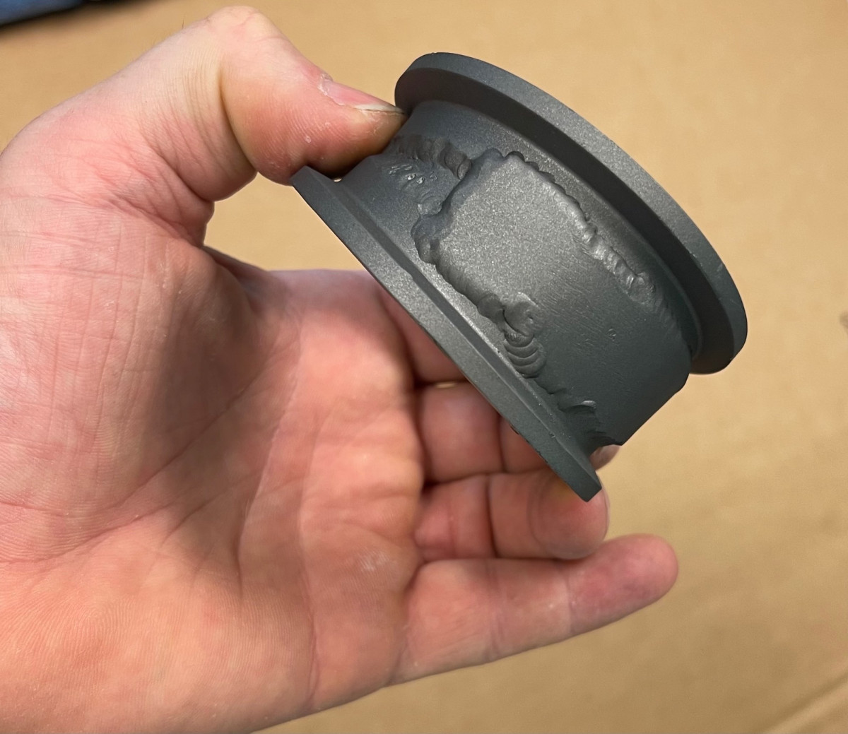

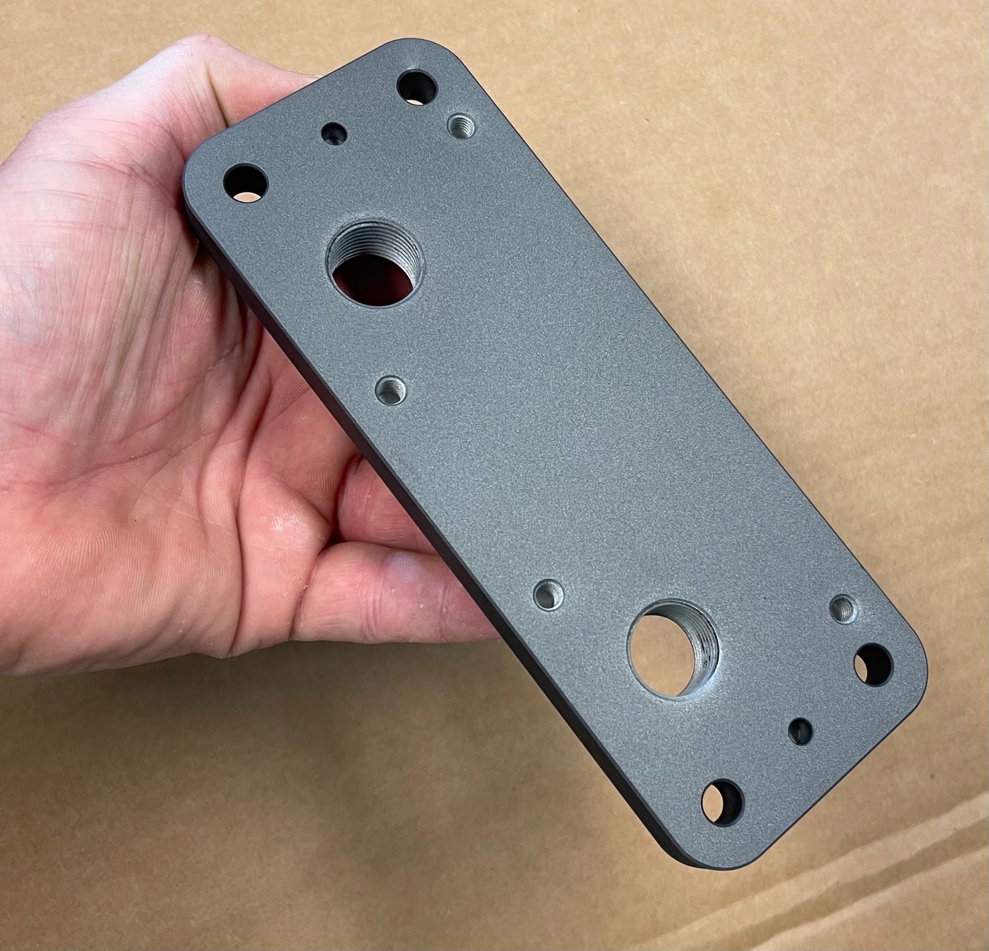

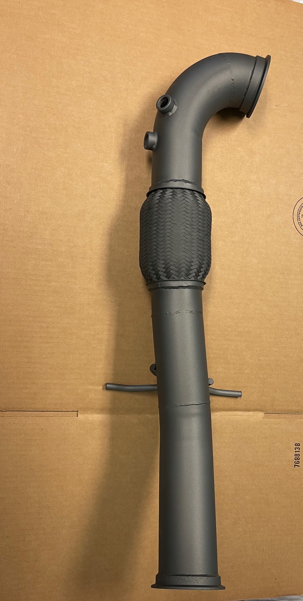

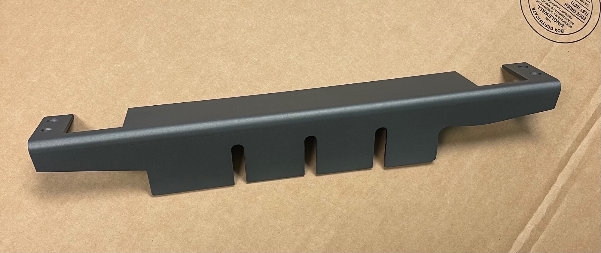

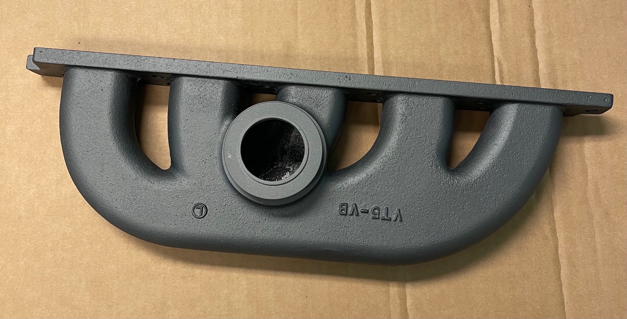

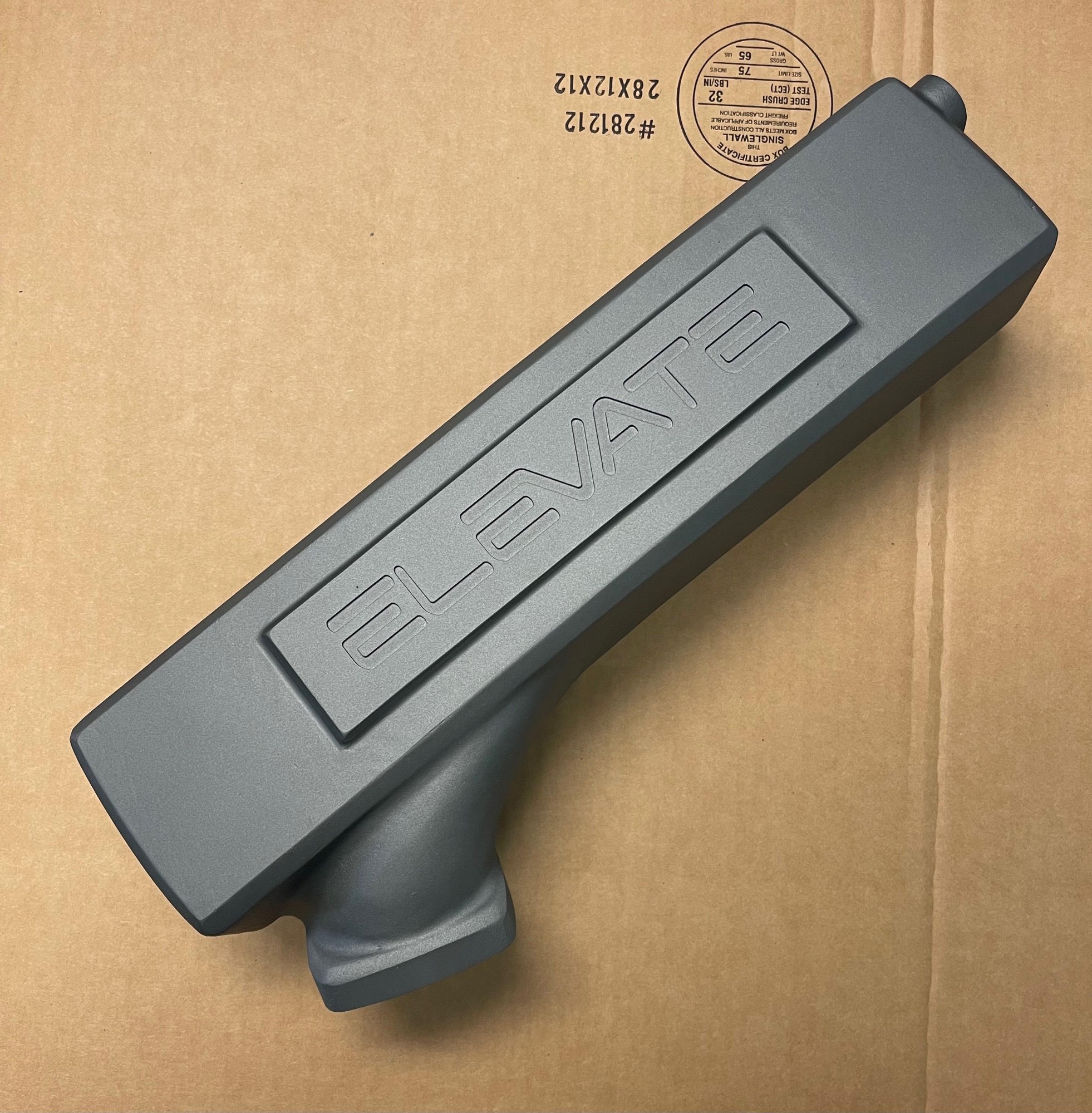

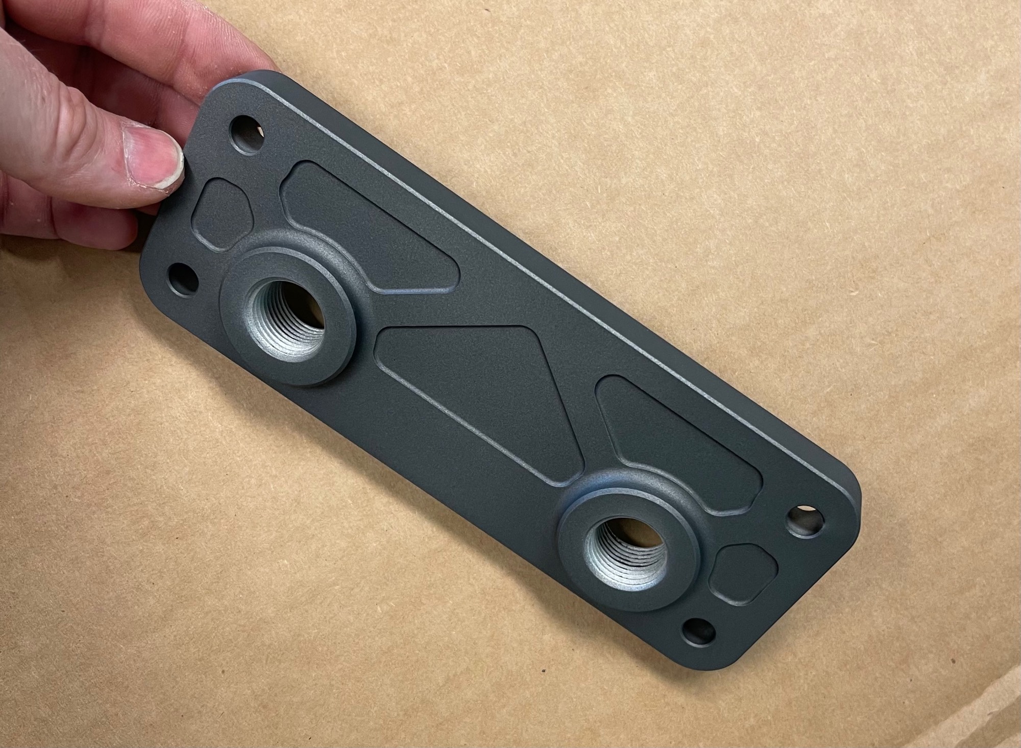

Picking up parts from Cerakote today..
pics to follow

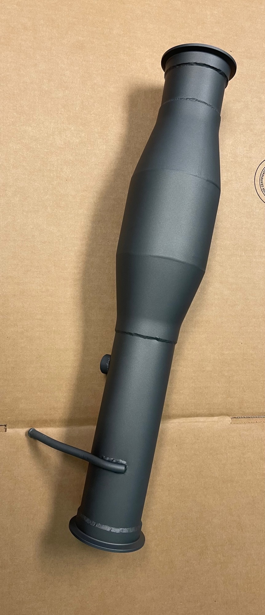

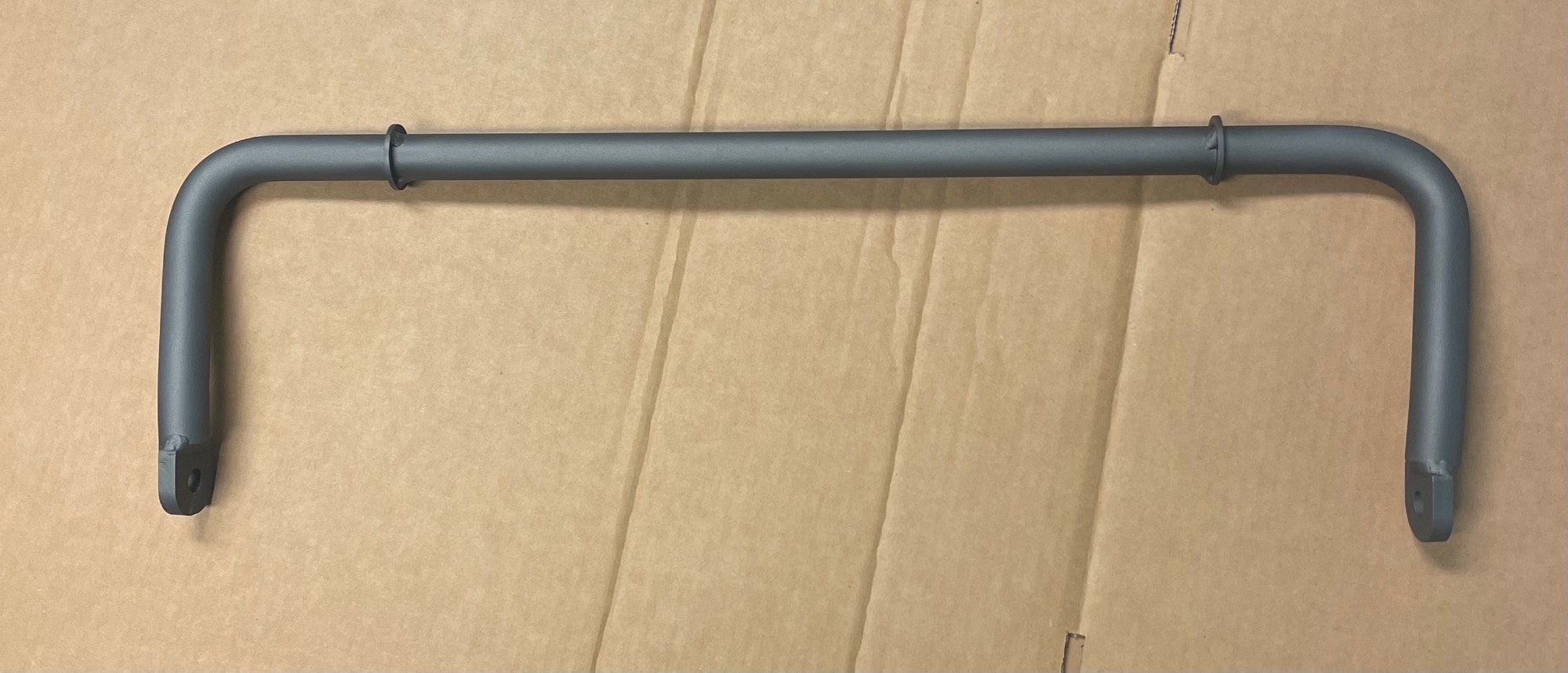

precisionguesswork
Posts: 58
Joined: 22 May 2024, 00:39
Year and Model: 2008 C30
Location: USA
Has thanked: 12 times
Been thanked: 16 times
matthew1
Site Admin
Posts: 14809
Joined: 14 Sep 2002, 11:03
Year and Model: 850 T5, 1997
Has thanked: 2857 times
Been thanked: 1332 times
Post by matthew1 »
Some of those pieces look like they were manufactured on the International Space Station. Just beautiful. Good thing they'll live inside a 3000-pound metal case to protect them.

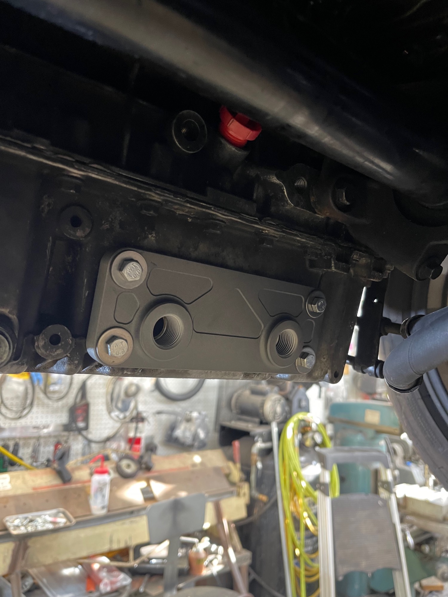

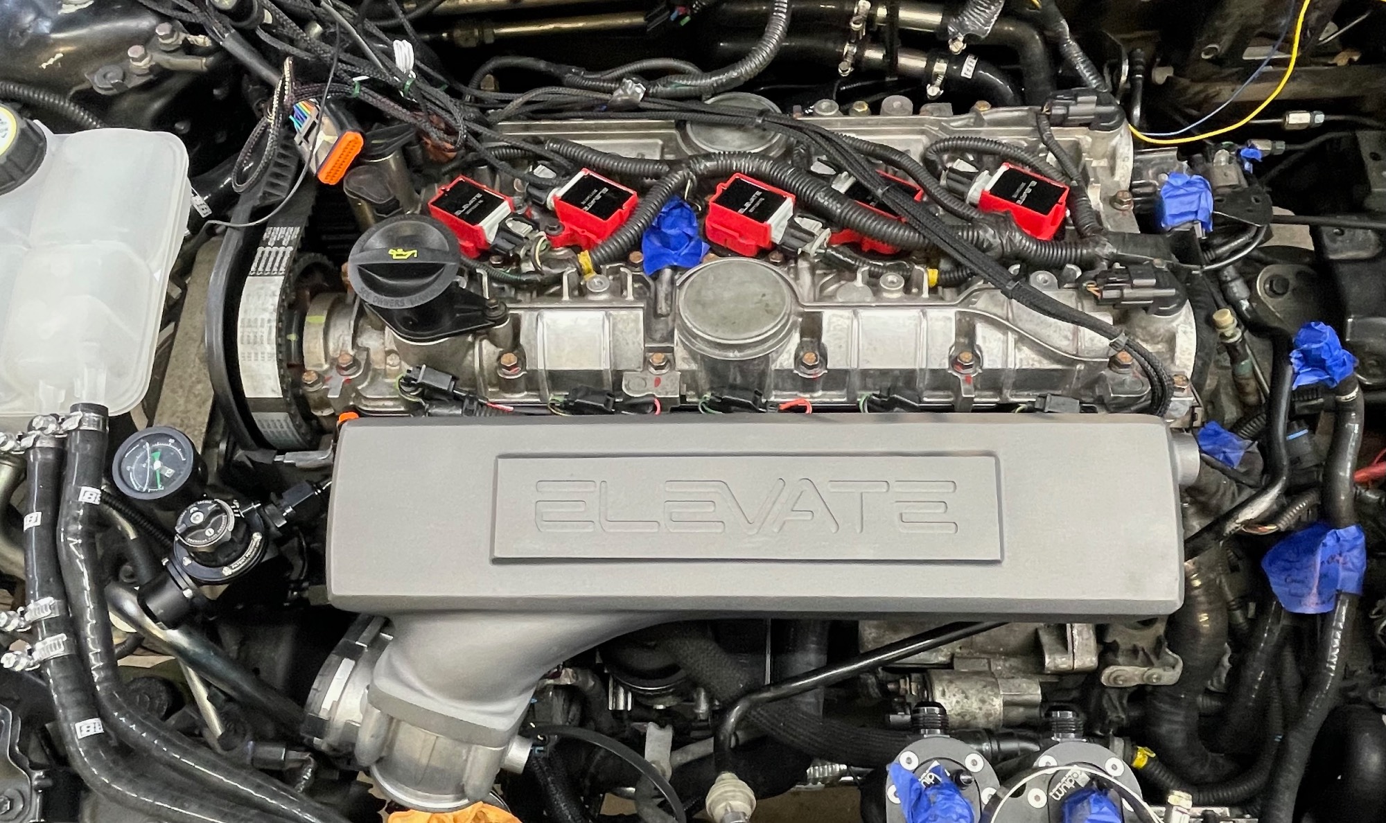

Fuel lines, rail, injectors, regulator, fuel pressure gauge,
eFlexFuel injector harness, flex fuel sensor, Radium parallel bypass, intake plenum, throttle body, sway bar, oil cooler blocking plate are all in. Back in shop today, more to follow.

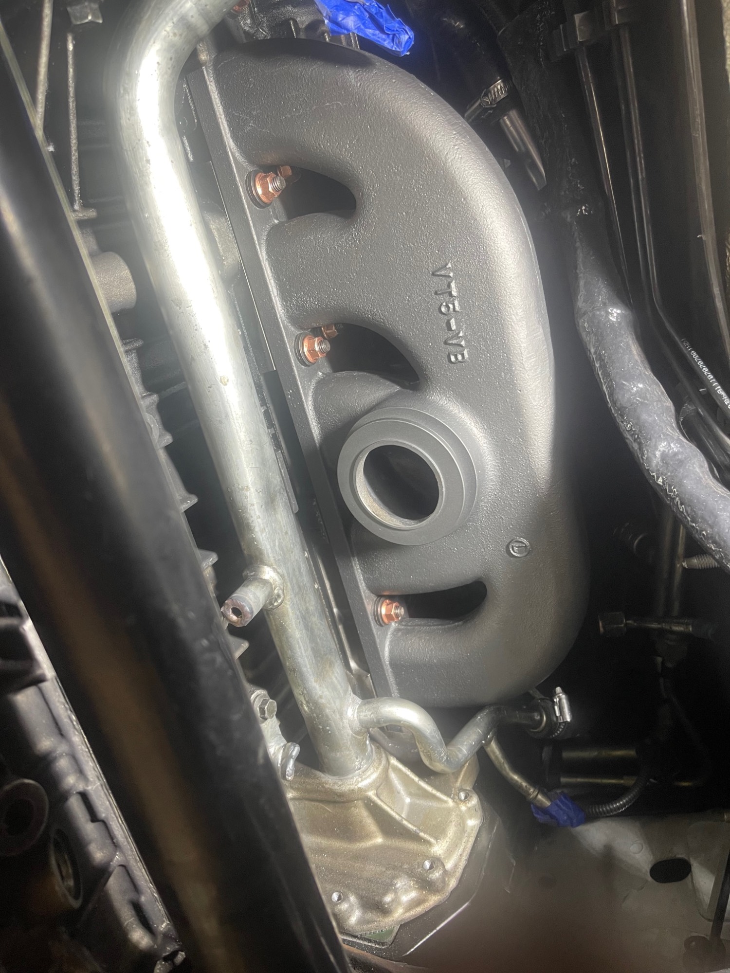

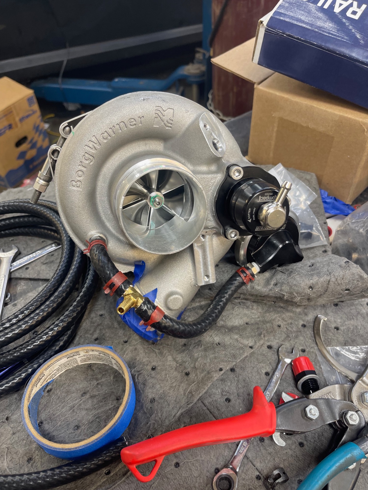

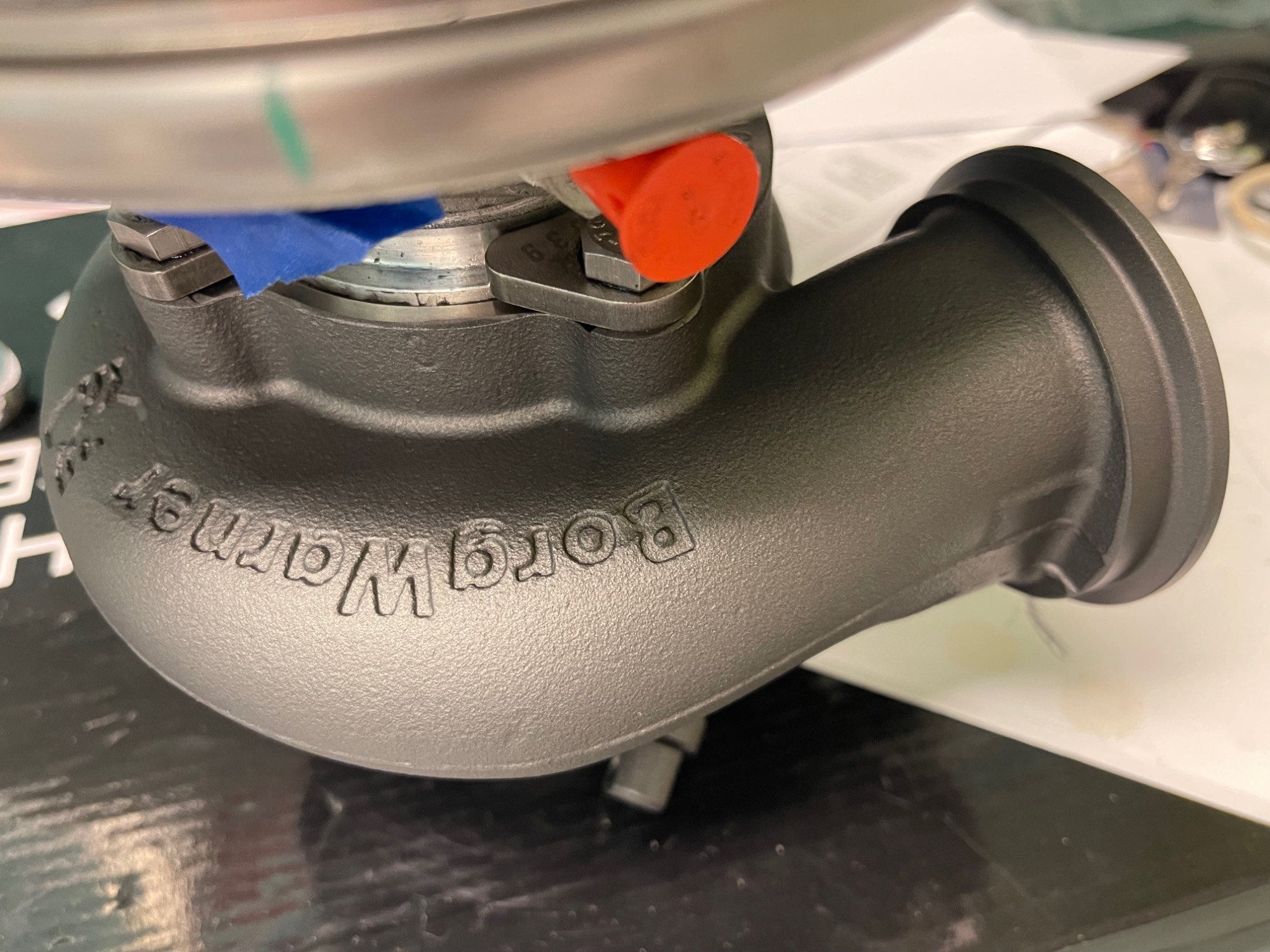

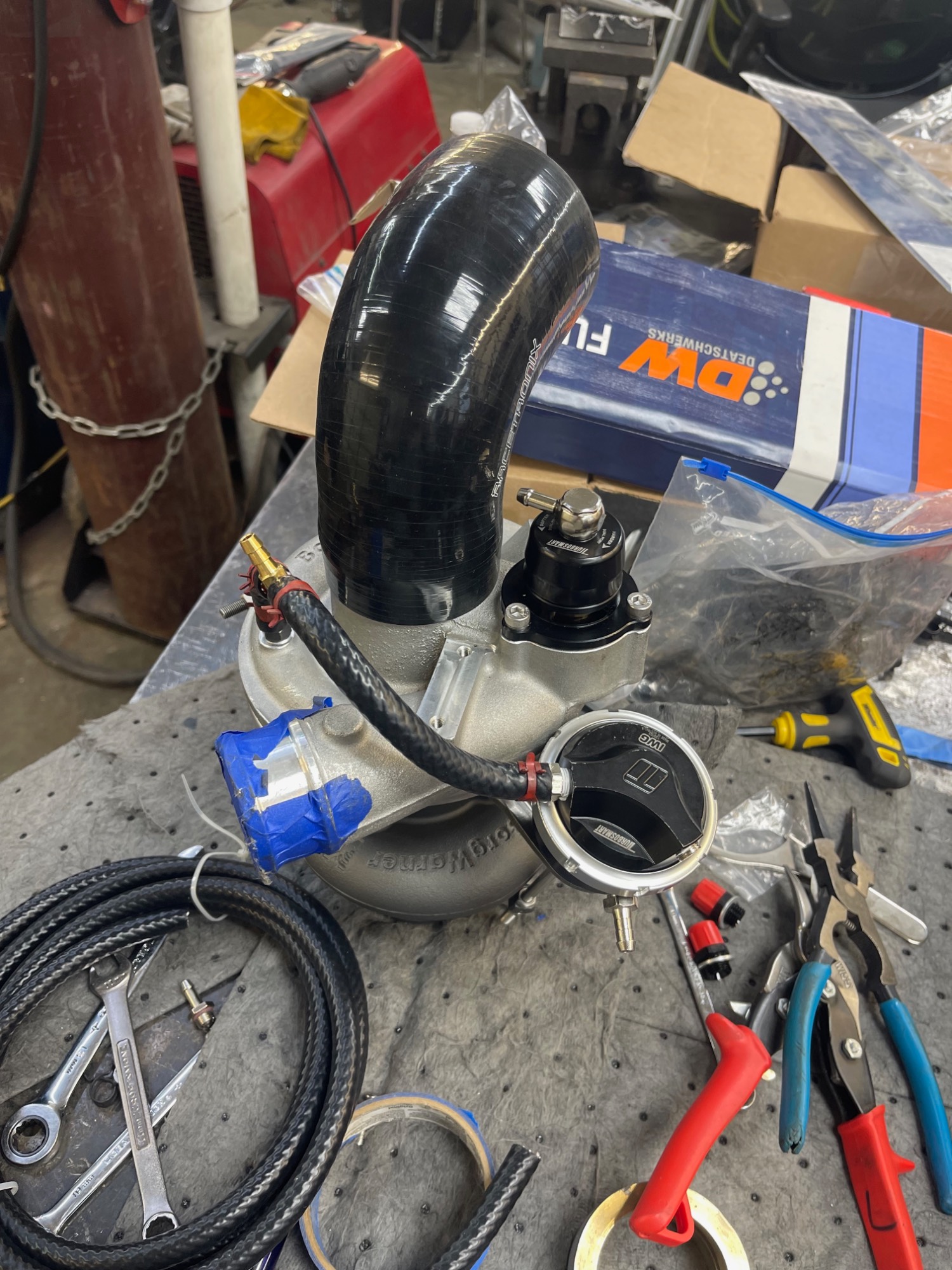

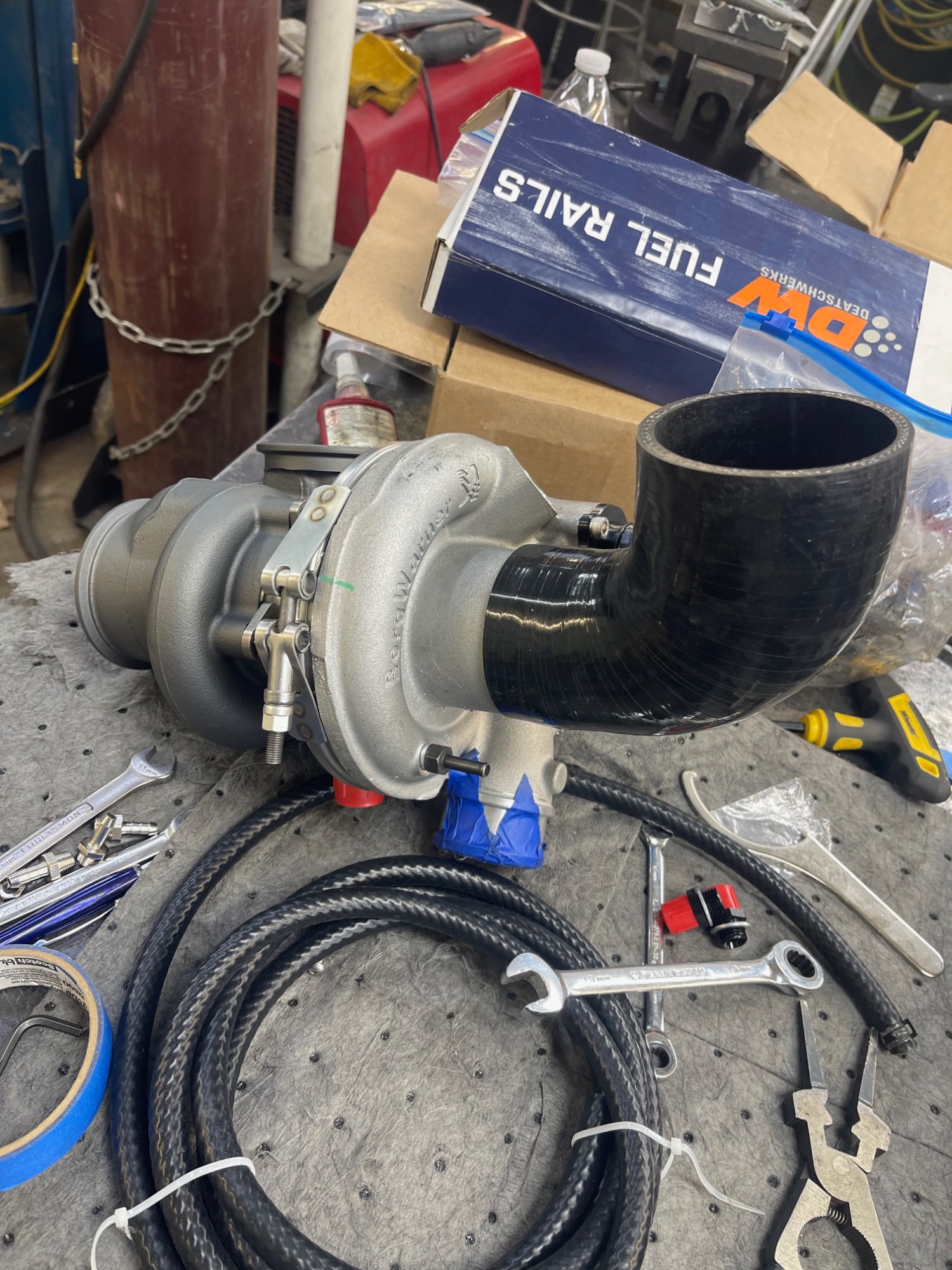

Exhaust manifold is in permanently. Mocked up turbo for vac lines and next project will be, cold side, charge pipe, welding neck onto compressor outlet, and with any luck oil cooler.
sorting out the oil drain, had to grab an ultra low profile oil drain flange as the turbo is now about 2" lower than K16/Stock. Set up fittings on the turbo, less the coolant lines to again verify I'm good on space constraints. All clear.
