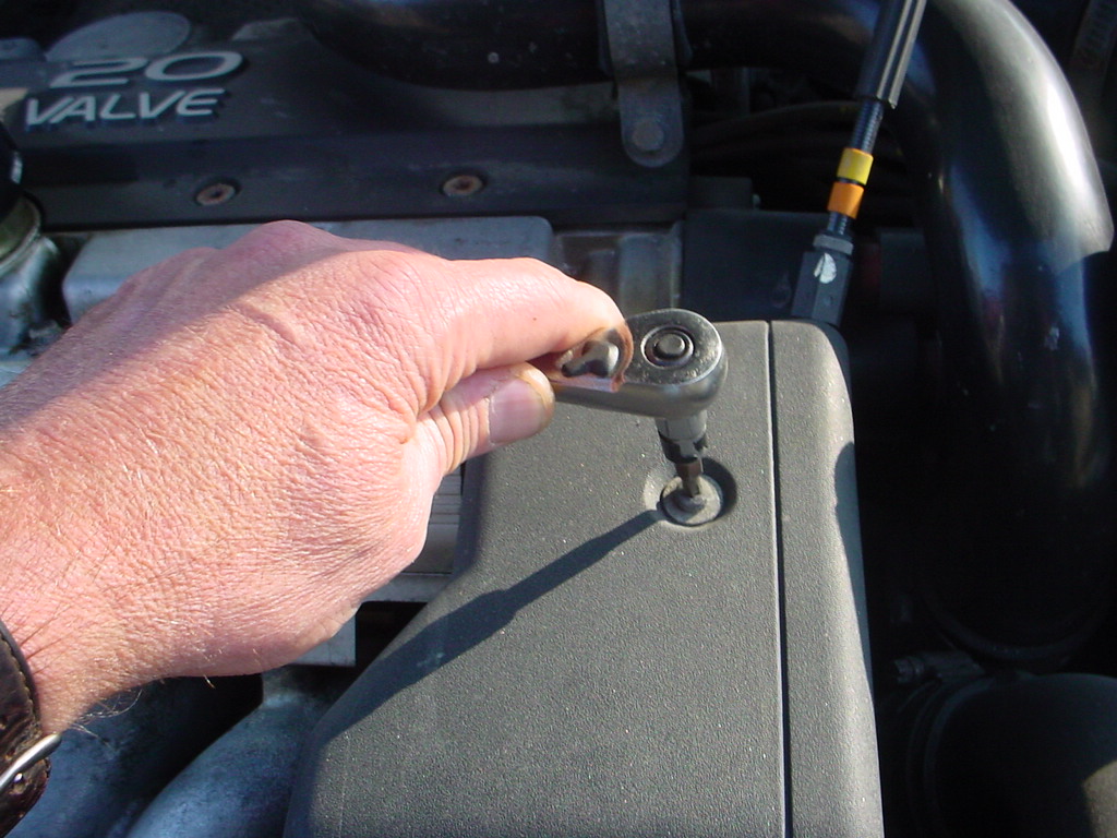

Step 2: Remove the cover over the throttle, it takes a T-25 torx bit.
Removing the throttle cover.

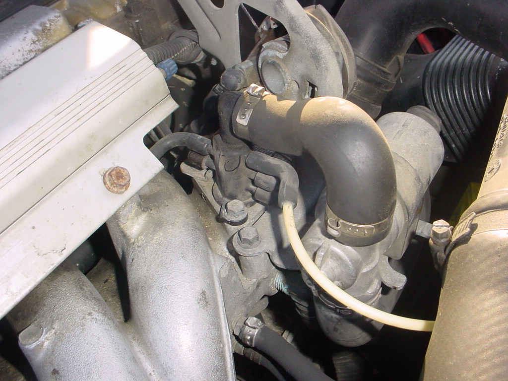

Step 3: Locate the vacuum tree.
The vacuum tree is the plastic piece that the white line leads to.

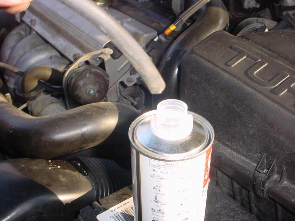

The open end of the added vacuum line to be used to suck in the Seafoam.
