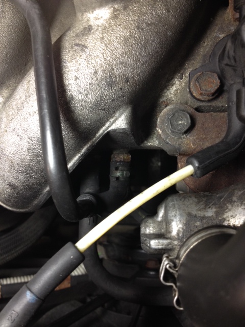

I got the small nipple I lost from the dealer but they weren't sure what the part number is for the 90 deg hose so they gave me some vacuum hose.
The hose they gave me was too big (3/8") so I got some 5/16" hose which is the right size but the hose kinks because it is such a tight radius so I need a pre-bent hose. Can anybody help with the part number, is there a site I can access. I'm sure Volvo sells it, with such a tight radius and close to the heat from the radiator fan it takes a lot of abuse so I'm sure other people have a rotted hose.

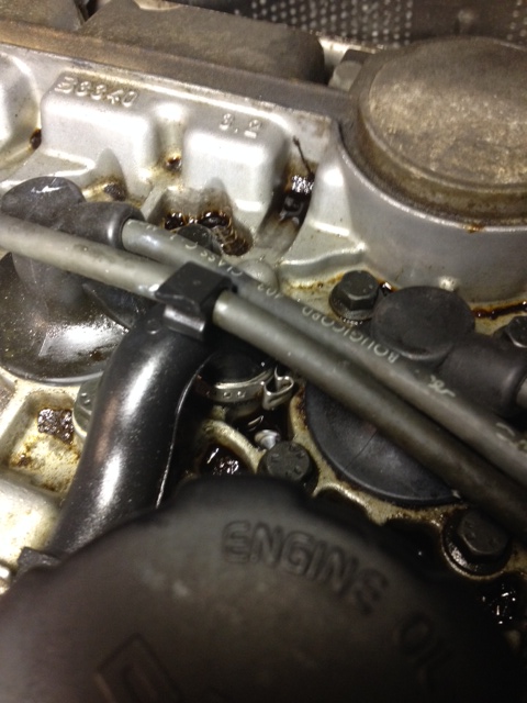

One more thing: the PCV is not building up pressure and was serviced not too long ago and yes I just changed the oil filler gasket but I'm getting oil on the valve cover. I suspect it is from the PCV valve hose on the top.
Is it common for them to leak from this area? Are the Oetiker clamps any good, can you tighten it?
Should I remove it and replace with a regular clamp. Thanks

Not sure which hose or line you are referring to from the vacuum tree on the intake manifold? I usually pull that kind of stuff from the cars in the junk yard when they look newish.
You should clean the top of the motor real good. Drive one day then check it again. No need to put the plastic cover on it. Then look real close to see if the oil is coming off the tube or cap. If off the cap, your cap tabs (or cover receiver) may be worn and a new cap may be in order. If the PCV tube is leaking, you should be able to tighten the clamp. You will need a tool to tighten it.

For all of those vacuum lines, your best bet is to just use generic vacuum hose not the elbows and various connectors. It is no problem to change the path so that the bend is not so tight. You can get silicone hose, it is more flexible than rubber, but you should be able to make rubber work.
Some people love Oetiker clamps, some don't. I would indeed just replace it with a screw clamp, yes it is common for that hose to leak. Beware, if it is old and hardened it may not tighten well.
