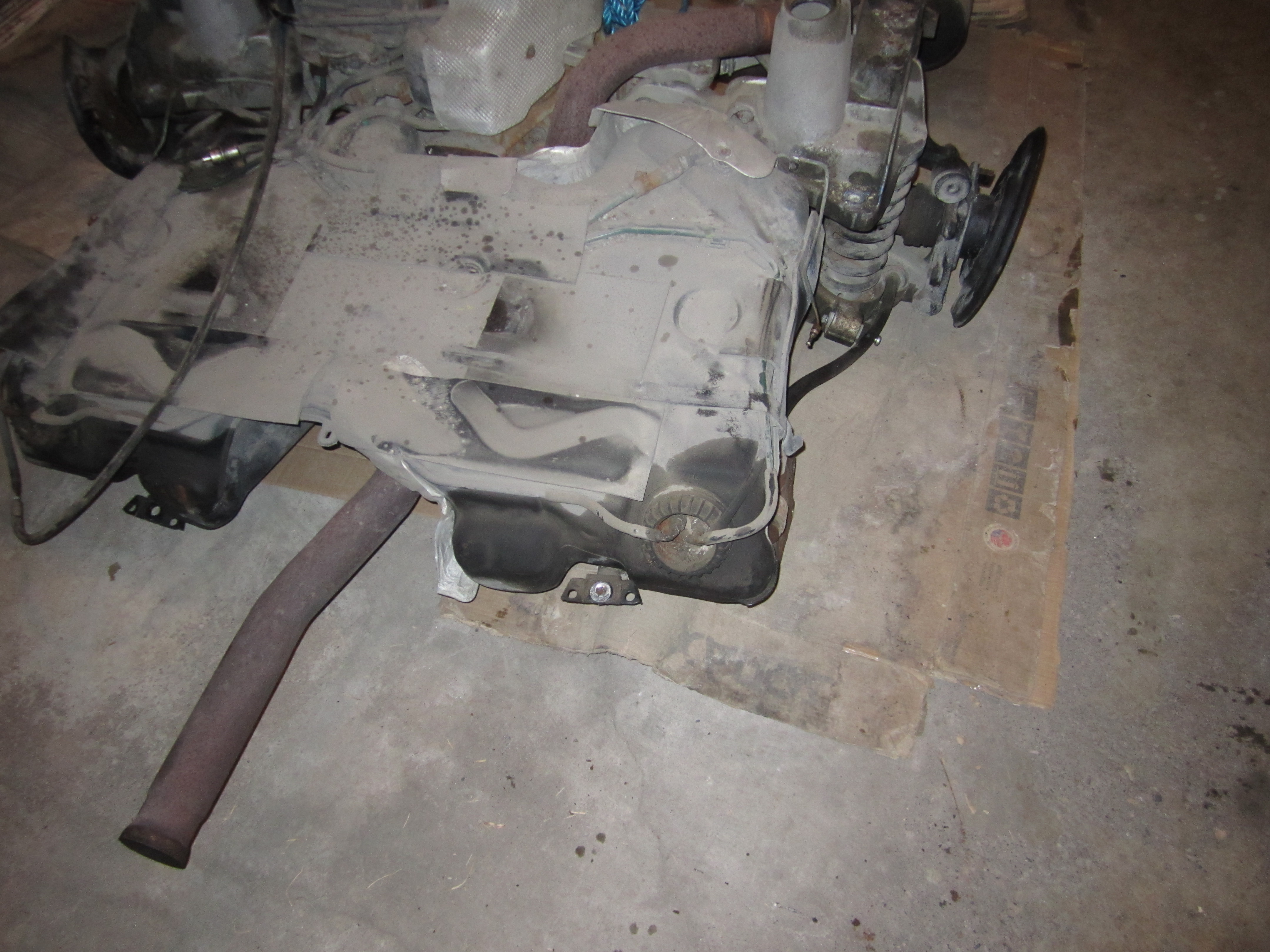

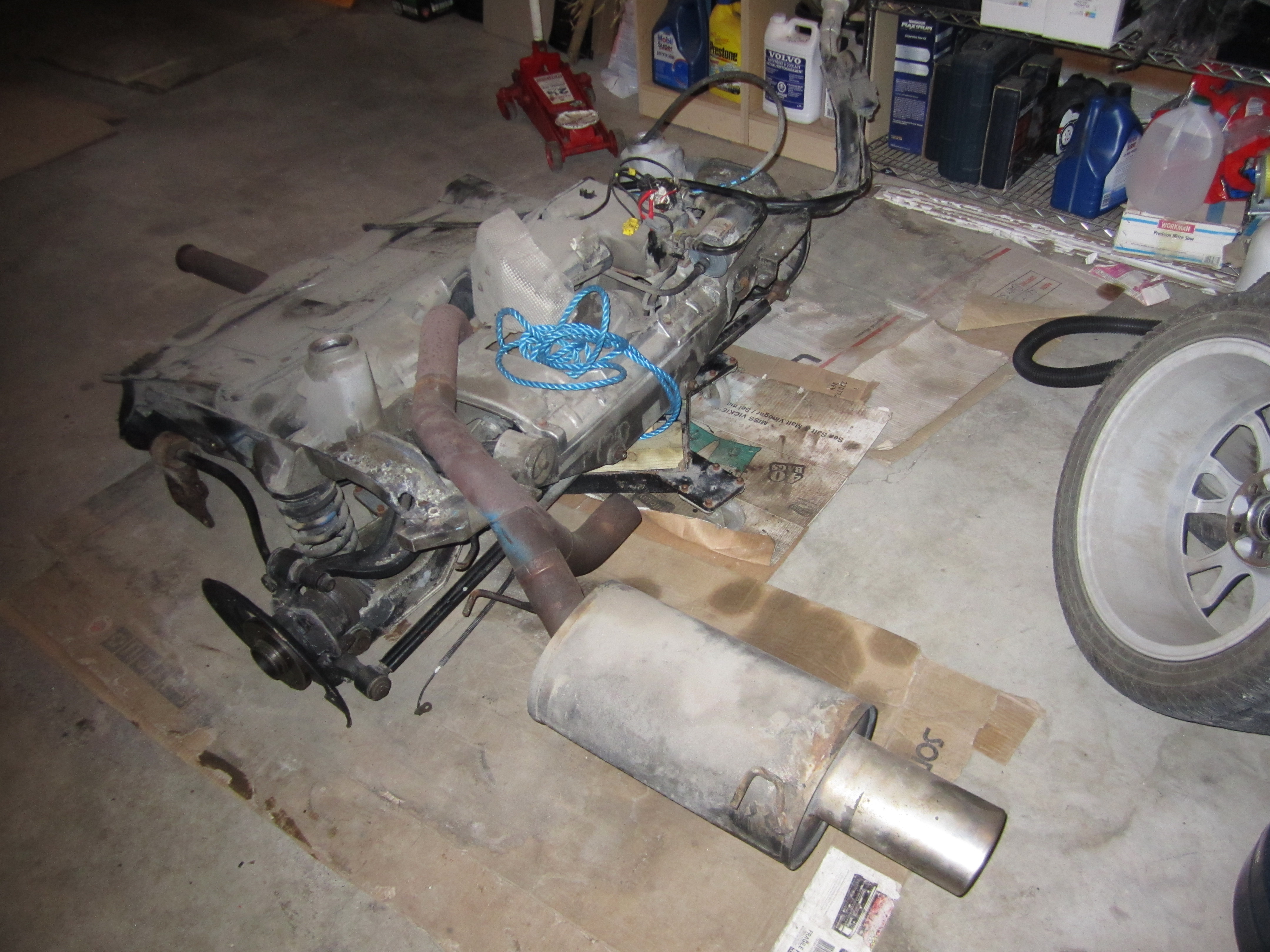

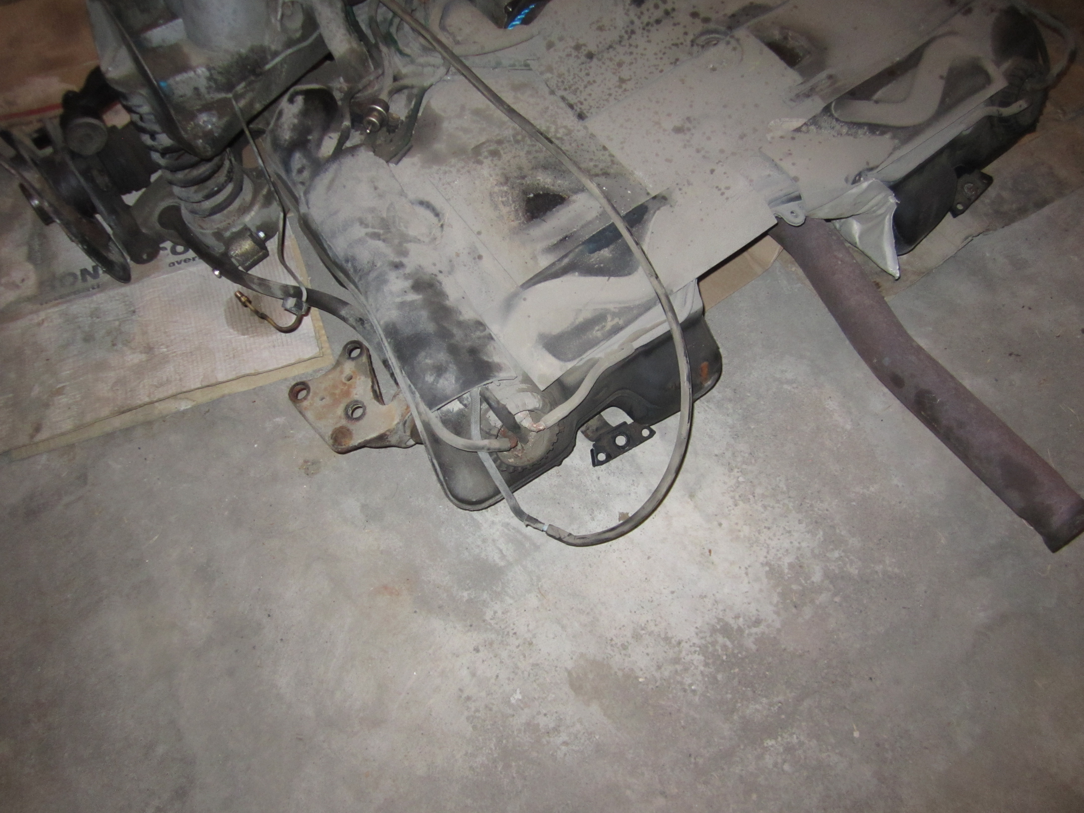

I have now hauled the whole assembly out from under the car. I must measure how much space you actually need in clearance as I had to pull out sideways to get the header fuel tank out. Also had to loosen the fuel filler pipe to rotate it down to give clearance.
I have started a separate thread asking if anyone wants any pictures of specific areas of the frame and fuel tank for reference as I disassemble it to component form.
Now that I have room, the next major issue is to make sure I can get the last 2 mounting bolts out before going any further or ordering parts.

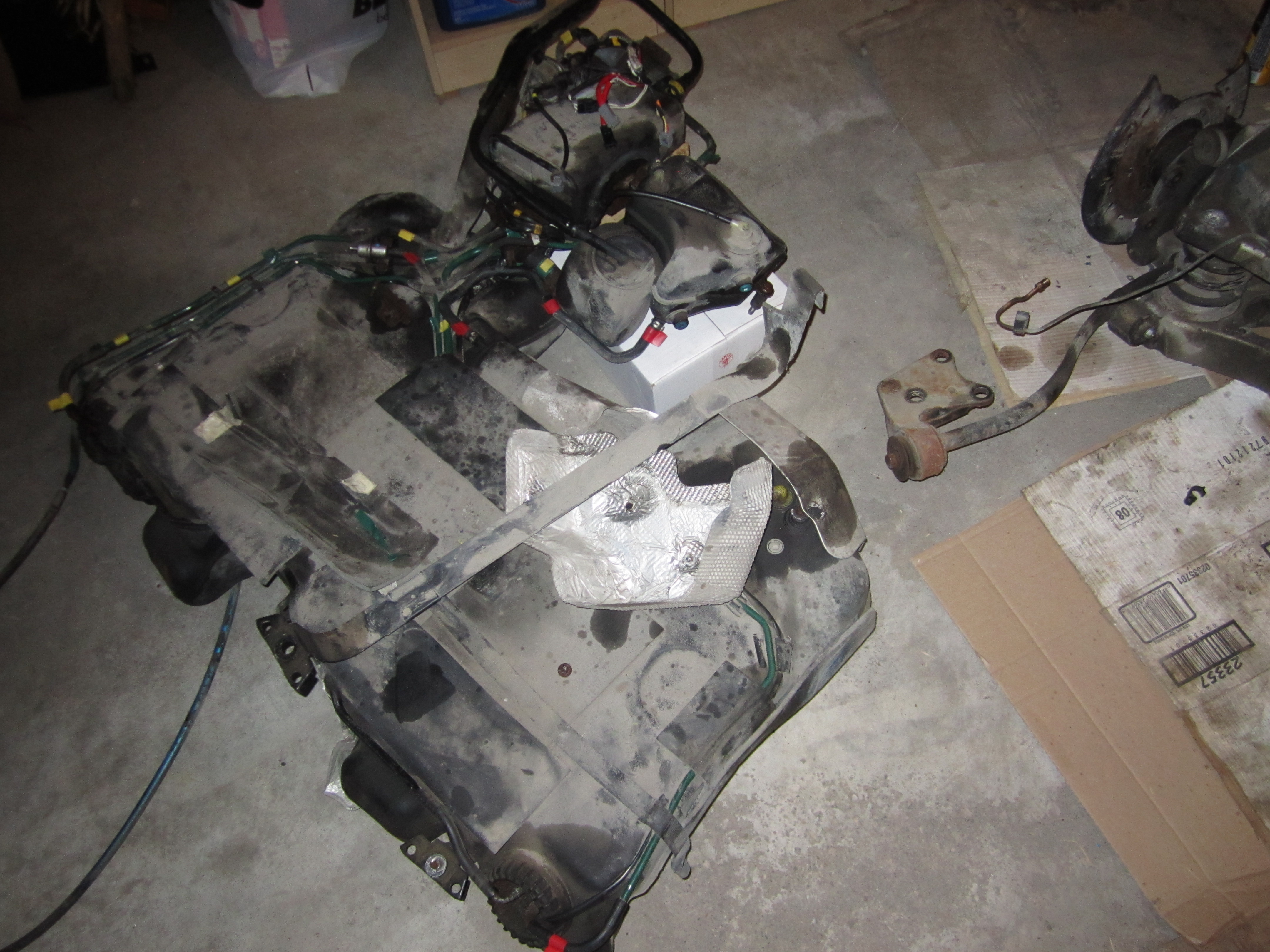

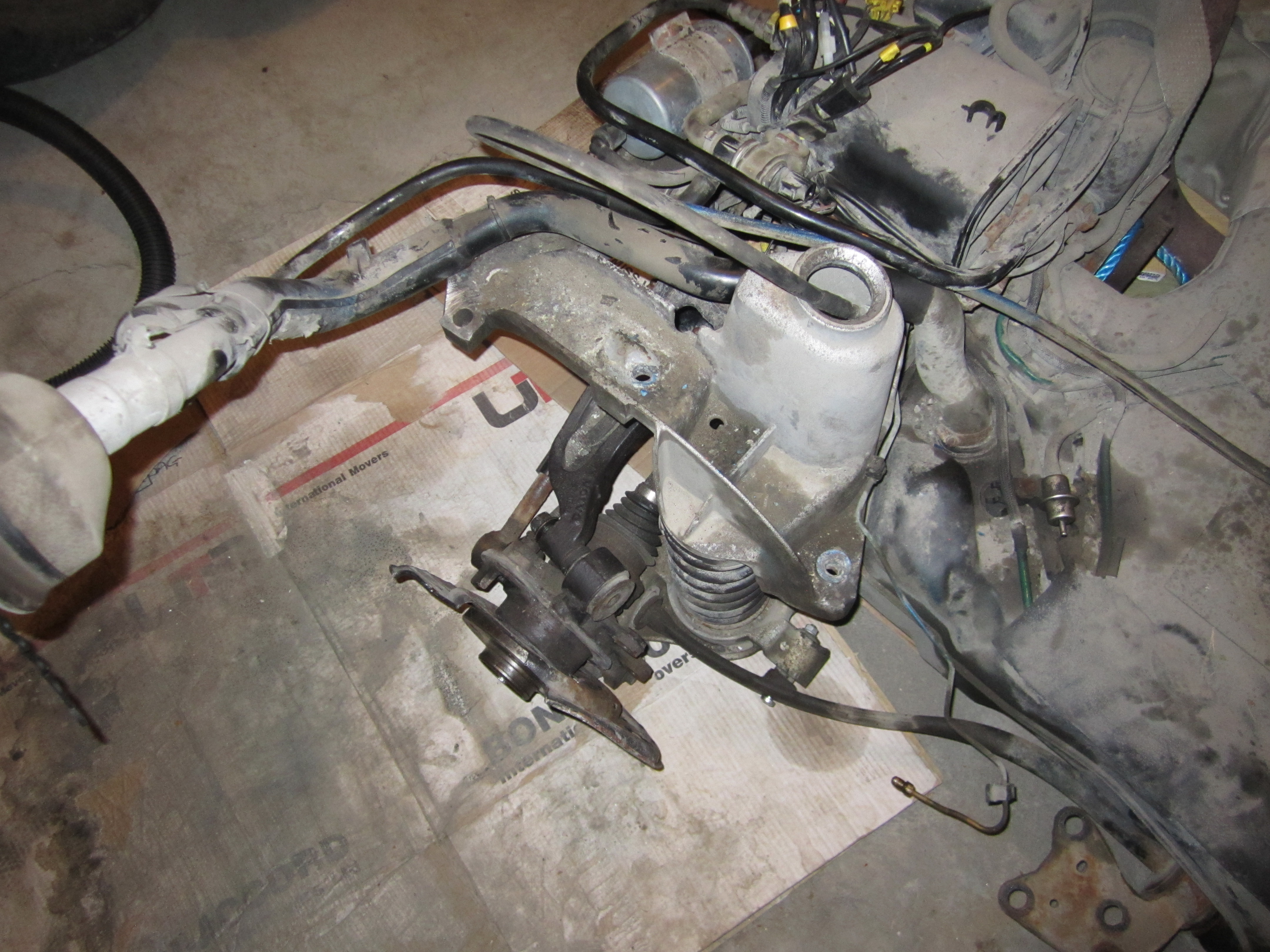

Finally had time to get back to this today. Have now separated the fuel and emissions system from the rear sub-frame. Taken a whole bunch of photos to upload on the piping system as it is hugely complex and stupid, but as the Vida instructions only cover the 98 AWD version (which I believe may have the charcoal canister at the front of the car), I have been taking extra photos for those of us without the benefits of the older car.
Again, there are signs of Volvo engineers endless stupidity. Things like securing the emissions canister with a clamp on the front side making it impossible to remove without dropping the whole sub-frame. They could have reversed the support frame and had the clamp at the rear with all the connections accessible to allow removal without sub-frame dropping.
With my sons help we lifted the fuel tank and system away from the rear sub-frame which now means I can start on the final strip-down. I will wait until I have gotten the 2 remaining sub-frame bolts removed from the underside of the car. No point continuing the strip down if I can't bolt the repaired frame back up!!

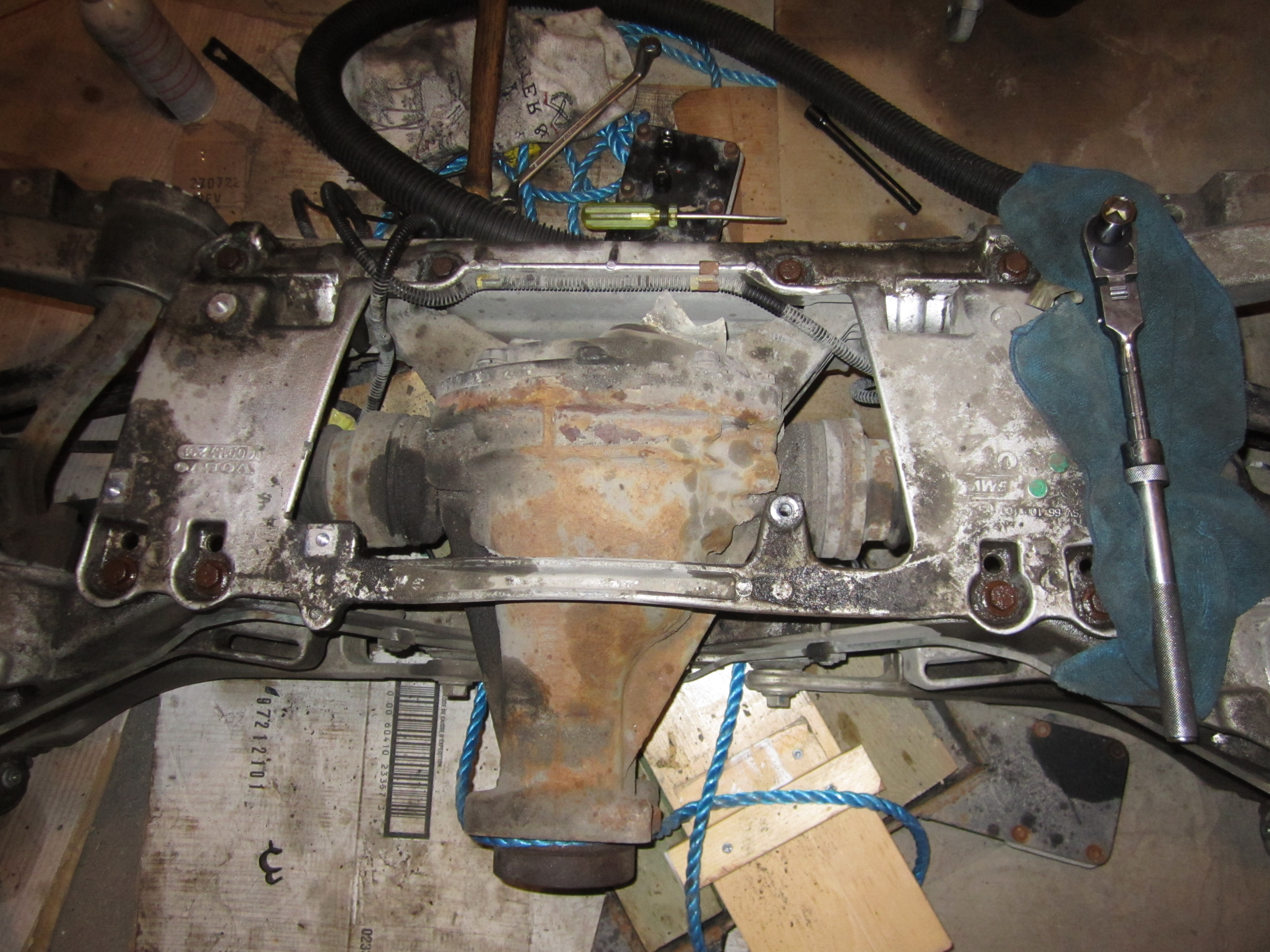

This shows the sub-frame with access to the top clamping frame that sandwiches the differential and rear axle assembly in place. Note again the wonderful design with the bolts on the top requiring the whole frame to be dropped to remove the differential. Marvelous stupidity!

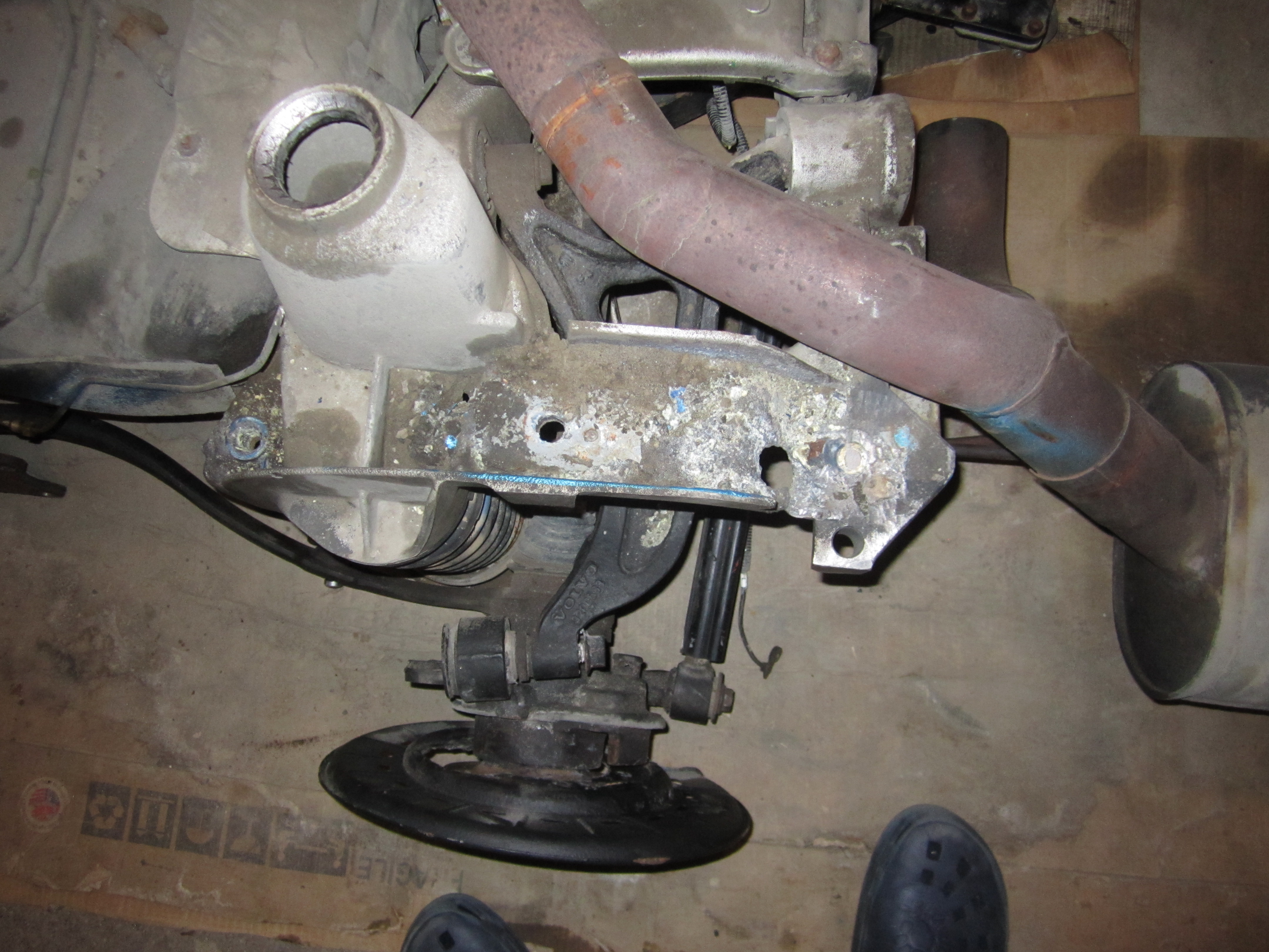

I had thought about having it welded, but the frame is way worse than I thought. The majority of the channel section that runs from the front to rear mounting bolt is badly corroded hidden from sight. I picked up a west coast used frame. It really cost me ($650 CDN) with the shipping, but in fairness, the amount of labour to remove it must have been high if you consider the dealer charges a minimum of 10 hours for removing and replacing. I new one is in the $2500 range.
It doesn't show too clearly, but the whole of the channel section from the right hand side to the middle hole is deeply eaten with corrosion. Add to that I had to cut the bolts off, which meant I sawed off the stand offs on the frame which were also welded to the main car frame.
In my case repairing was not an option once it was removed.
