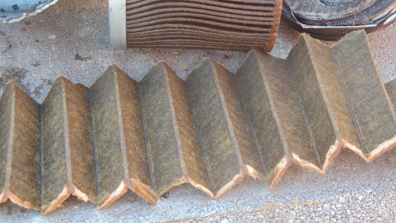

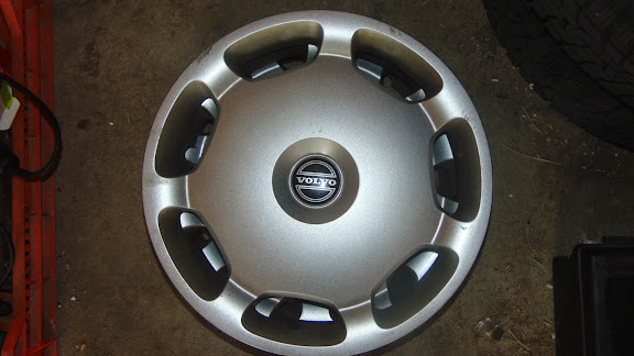

Post by zoli_m13 »
Some minor improvements of today:
- opened up the old fuel filter (OEM VOLVO): very strong metal house and filter material; no any particles found
- painted the set of steel rims for the winter tyres (used ones with VOLVO hubcaps; it was a bargain)
Some photos:
