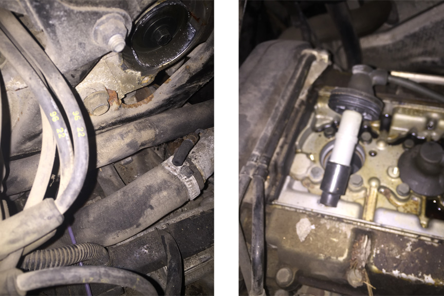

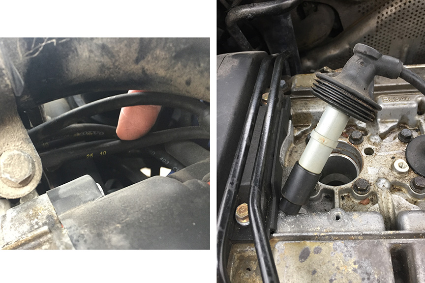

Well this one puzzled me, didn't seem right, so I went and looked at my parts car, which has old wires. Yep, they are year/week (96/xx). Then last night I had the hood open on my V70 - sure enough the date code on them is week/year (25/10).rips wrote:... The date pattern is week/year ...
I wonder if Bougicord changed the date code system at some point? I will look around at some other wire sets, see what I see.
But I'd be interested to know what date codes other people see, especially with older wires.

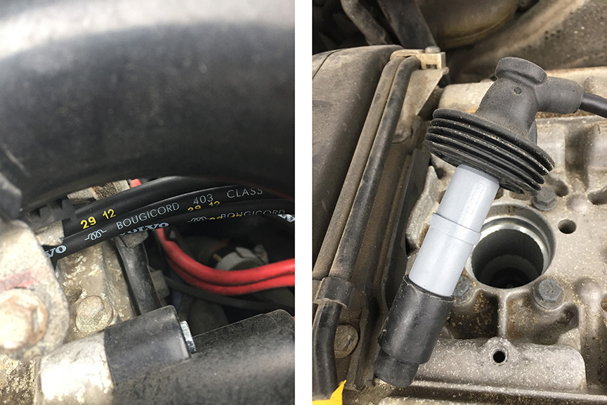

OK so I guess Bougicord changed the date code, and for at least 10 years it has been week-year. So OP Robert was right. But the old way was year-week, my guess they changed it in 2000? I didn't shoot any pics of the old wires, short lunch break, wish I had now ...

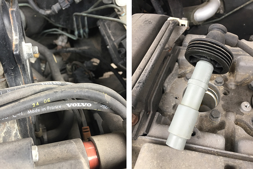

Just to complete the story, here's a pic showing how the cars came from the factory, with reversed date pattern year/week: Does anyone know when Bougicord changed the date pattern?rspi wrote: ... The date pattern is week/year ...

I believe I have seen wires dated 42 02. I do recall seeing the original wires with 93 xx dates.
