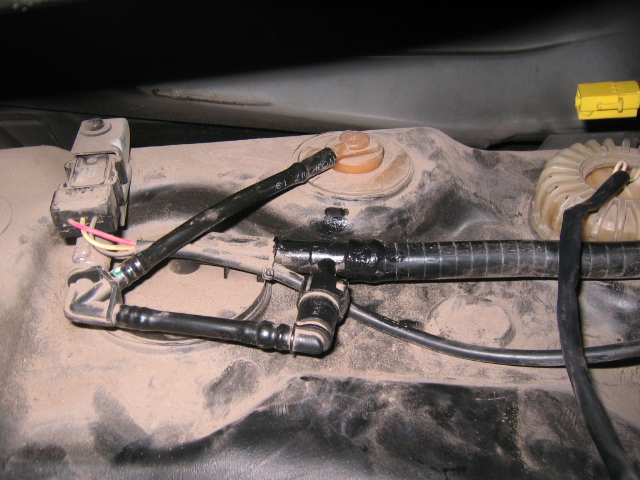

I finally decided to do a tank drop in order to examine the top, hoses and to pull both the fuel level sender & fuel pump to verify both gaskets are OK. I also disassembled the FLS, inspected the internals as it's been hanging up from time-to-time.
I followed the instructions in VADIS. I placed a large roll of carpet under the tank as both a stop & cushion. Here's what I found. First photo shows two plastic T-fittings, all connected by hard plastic pipe that looks shrunk into place. I also found one of those small pinch-to-release-connectors on the right T. Very similar to the one found on the char. can (which I cut off years ago and replaced with silicone tubing.) I disconnected it and turned it around. Inside I found a dried-up brown substance, like grease. I swab'd it out with a q-tip, noticed both o-rings inside appeared to be intact, so I lub'd them with vaseline and reconnected it. I'm still suspicious of it though...especially after 20yrs.
Notice the rigid plastic pipe just to the back...appears to be no clamp on it. Odd that. Could be leaking air there as well. This line is the tank vent line. It runs all the way to the char. can and connects with another one of those push-to-disconnect-inner-o-ring connectors. Might be a good idea to replace the entire pipe with silicone tubing and proper clamps.
Volvo_Gas Tank 001.JPG (183.52 KiB) Viewed 1529 times
Here the first connector has been turned back around and attached.
Volvo_Gas Tank 003.JPG (182.7 KiB) Viewed 1529 times
Notice here just how tight the vent hardline is around the FLS collar. Right there it showed signs of being abraded a bit and well as pinched. I didn't remove it for inspection due to time and not having a suitable replacement, however I'm suspicious of it as well.
Both collars on the FLS and the FP were easy to remove using a cirved oil filter wrench that looks like a pair of pliers. VADIS noted it's important to replace these collars soon after removal to prevent the tank necks from expanding. I found the FLS gasket a bit grey and dry but no signs of rot. I cleaned it with Mequiar's VLR and reinstalled and tightened. Ditto for the FP except I used ReGrip instead. VLR would be fine as well. I also lub'd the FP connector o-rings with vaseline per VADIS before re-installation.
BTW, this is the tank/vent filter that's tied to the fuel intake line. I didn't bother taking it apart.
Volvo_Gas Tank 006.JPG (153.7 KiB) Viewed 1529 times
Lifting the fuel tank into place was eased by the roll of carpet. I also used a long 2x4 as a lever to raise the tank. I had better luck with a simple floor jack. The two rear tank bolts were a pain to line up as the weight of the tank had bent the steel tank straps, changing their connection geometry. A bit longer bolts would have really helped.
I buttoned it all back up, reconnected the batt. terminals and drove off the rear ramps. No leaks. Time will tell if this did anything to solve the P0-455 DRAGON.
Anyone else replaced all of these pipes & hoses in an attempt to slay the dragon? I suppose I could drop the tank, then smoke it and observe for leaks.
Volvo_Gas Tank 002.JPG (207.92 KiB) Viewed 1529 times

Wow, thanks for posting this update! This is such an overly complicated system. Hopefully your P0455 will disappear after doing this!
