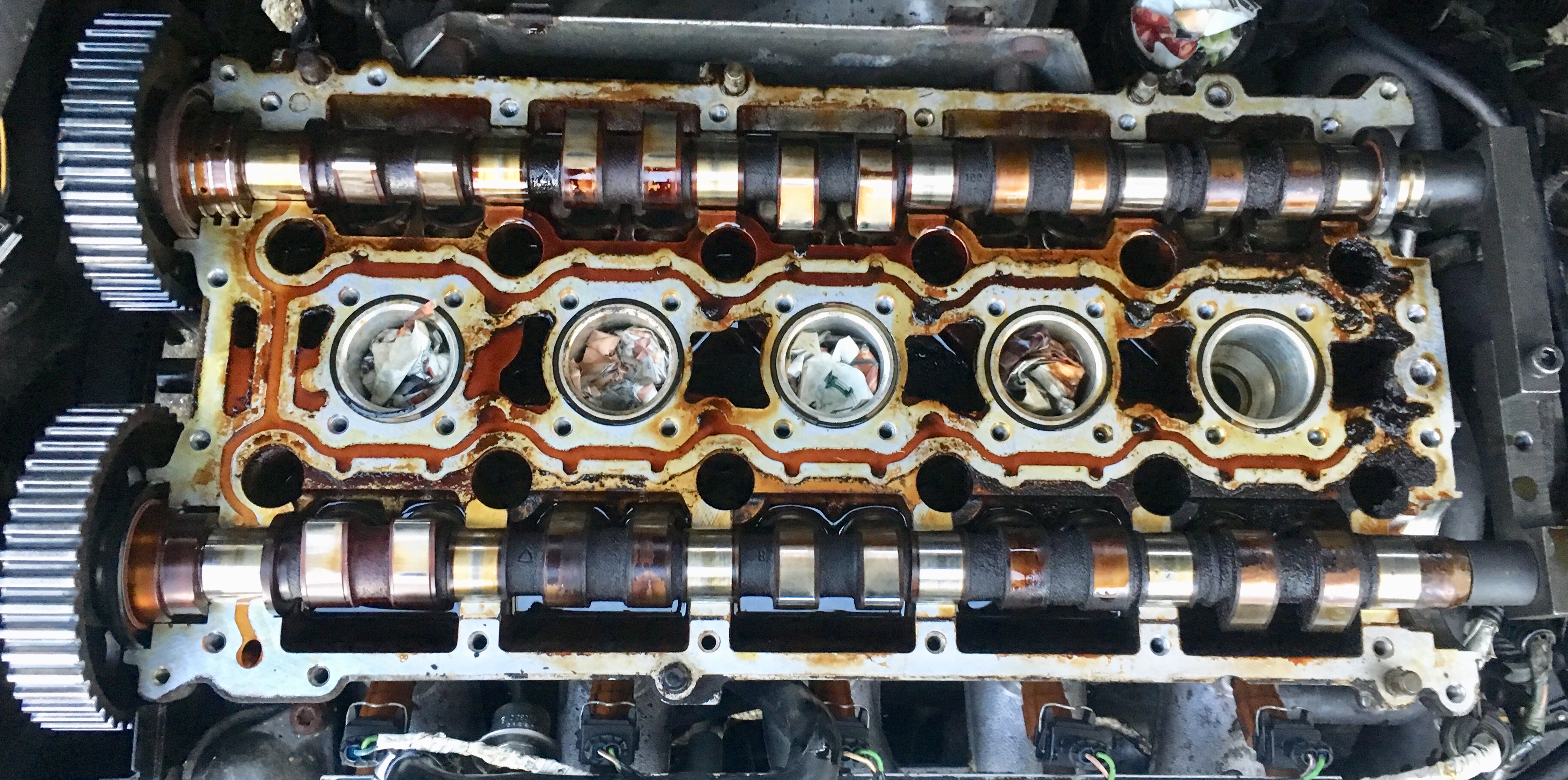

2001 V70 2.4T Oil pooling in the wells around ignition coils, Permatex 51813 cam sealer Topic is solved
- Posts: 35283
- Has thanked: 1502 times
- Been thanked: 3813 times
Re: Oil pooling in the wells around ignition coils
Mike..what about that sealer blocking those big ports partially at the head end? Are those just oil returns so that that really isn't an issue?
- prwood
- Posts: 689
- Joined: 2 October 2015
- Year and Model: 2001 V70 2.4T
- Location: Salem, Massachusetts, USA
- Has thanked: 9 times
- Been thanked: 22 times
No. I had just purchased the cam holding tool when I replaced the cam seals. At the time I didn't realize I'd soon need to crack open the head.precopster wrote: ↑21 Nov 2017, 01:43 Great pics!! I see you got some cam holding tools. Do you also have the wing nut pressure tools?

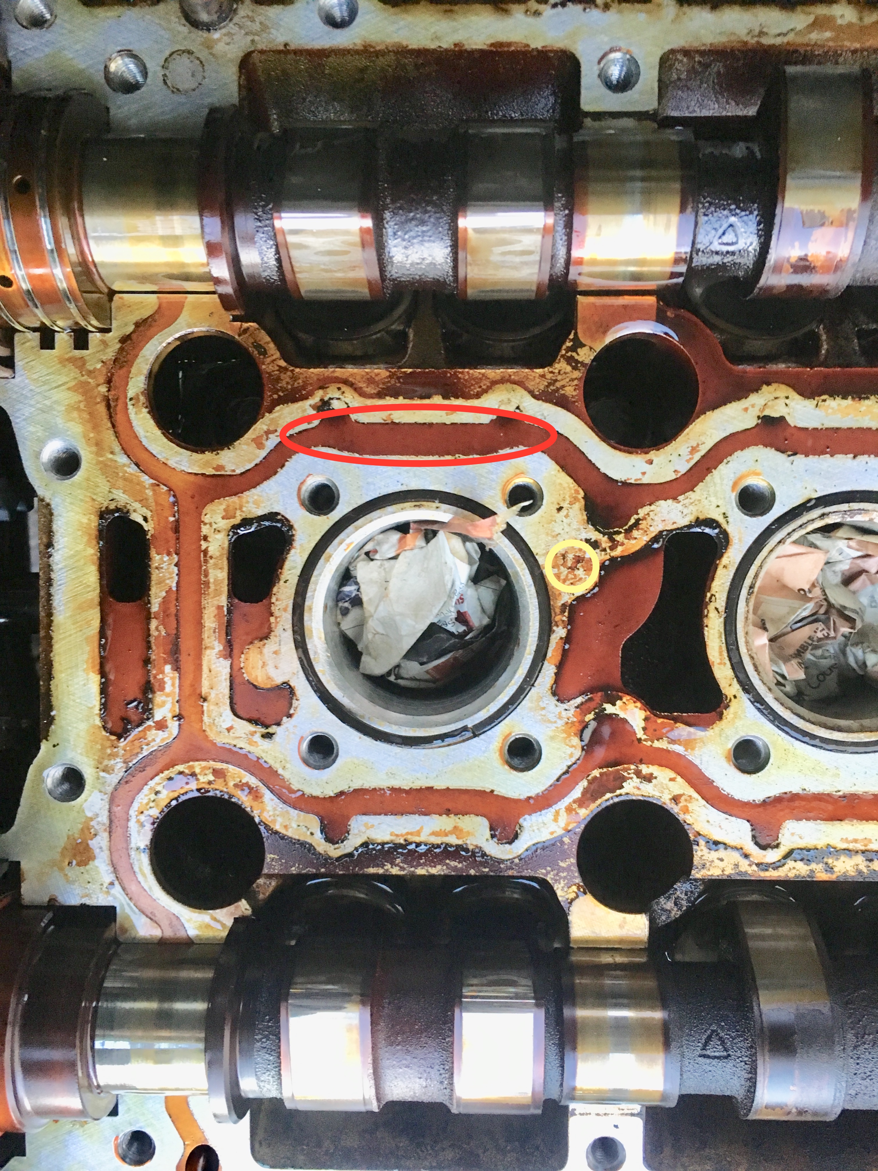

Question about that - when you refer to the dark orange lines, do you mean the ones like the one I've circled in red here, or the ones like what I circled in yellow?precopster wrote: ↑21 Nov 2017, 01:43 The residue from the old chemical gasket are the dark orange lines you see; the anaerobic sealer dries to a very thin film.
The reason I ask is that the ones circled in red seem to line up with the oil channels cut into the cam cover, which I'm assuming wouldn't (or shouldn't) have had gasket residue on them... I had figured those were stains or scorching from oil as a result of that surface being the bottom of the oil channels.
Is it safe to use degreaser on the cylinder head? I was considering using that to get out the crud from the recesses in the cam cover. On the other hand, is it strictly necessary to clean off surfaces that aren't part of the gasket mating surface?precopster wrote: ↑21 Nov 2017, 01:43 Other than the obvious crud and carbon (quite a lot of it there indicating multiple missed oil changes and/or use of mineral engine oil throughout its life) which must be cleaned off with a chemical stripper and use of scrapers nothing is really out of the ordinary there. Most people prefer to use a plastic scraper to avoid damaging the surfaces. I'm not so patient and will use a steel blade very carefully on a very obtuse angle.
Do you know if a "Goof-off" type of household gunk remover can be used for removing gasket material, or does it have to be a specially-made gasket remover?precopster wrote: ↑21 Nov 2017, 01:43 If you use a chemical gasket stripper you can use water pressure to clean off the upper half of the valve cover. Of course you'll need to dry it off quickly to avoid corrosion. Compressed air comes in handy here or a hair dryer.
With the lower half you'll need to be more careful of course. Whatever you knock down into the oil ports will mix with your clean oil so I would flush a couple of litres of cheap oil into the oil filler then drain that out. Some pipe cleaners would help knock that carbon down the oil ports. Don't worry about that crud blocking the oil filter as these oil ports lead straight down into the crankcase below the pistons.
https://www.amazon.com/Goof-Off-FG653-P ... B002MPPYYS
vs
https://www.amazon.com/CRC-05021-Techni ... B000M8IE6W

The circled in red areas are the oil channels. They turn this color when oil passes over the sealer. There was a little too much sealer applied there as some are blocked with it. Yellow areas are just crud. Clean it all!! Trust me the red areas will be a lot more work.

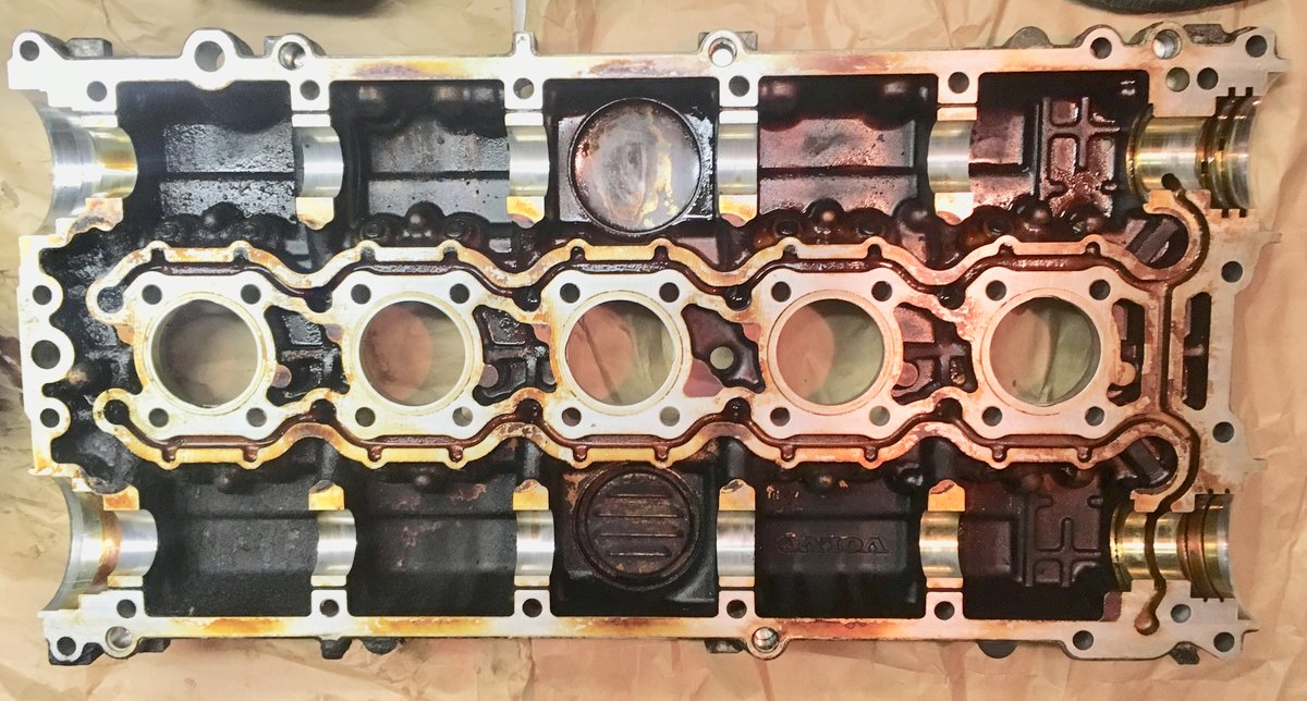

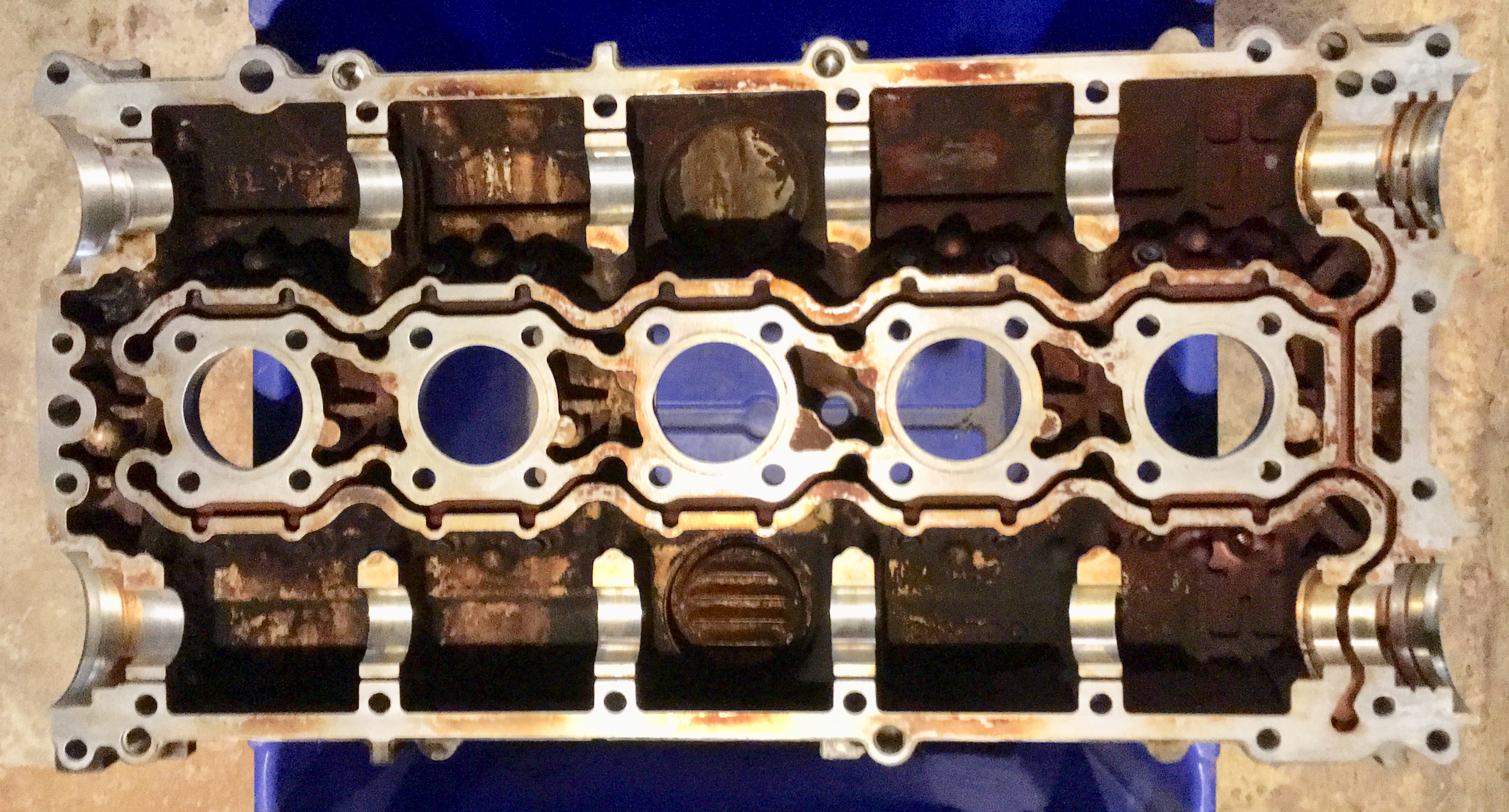

The weather was great last night, so I seized the opportunity to spend some time examining, experimenting on, and cleaning the cylinder head parts. Here are my notes, observations and questions. P.S. Feel free to correct any of my terminology... this is a learning experience for me.
1. I poured oil into the camshaft wells to see how/if it drained. I found that it drained differently on the intake and exhaust sides. On the intake side, oil drained through notches cut into the big oil drain holes just above the tappets, and also over the edges of the well where the camshaft would normally site. Put enough oil in and it runs out of either end of the head where the oil seals would normally be. On the exhaust side, oil drained through tiny holes just above the tappets (more or less in the same place as the notches were on the intake side), as well as over the edges of the camshaft well.
2. All that being said, on the exhaust side, the oil was definitely not draining through the drain holes. I used a small nylon pipe cleaner to give them a good scrubbing and then poured oil in again. This time it definitely drained down to a lower level. It didn't completely drain out, but definitely lower than it had been before I cleaned the drain holes.
3. Given the above, it seems that under normal operation, oil would drain more quickly from the intake camshaft than it would from the exhaust camshaft. I'm assuming there's some engine design reason for that?
4. After spraying with chemicals, I used a plastic scraper held perpendicular to the surface to scrape gunk off of the cylinder head. I found that holding it this way scraped more effectively than holding it at a lower angle. I'm thinking bread bag clips might work well too, because they're even thinner which would be an advantage.
5. I am not nearly finished with cleaning, but I think I have a pretty good start. I feel like I have a good method now and just need to keep working at it. However I'm always open to suggestions for improvement.
6. I have a set of nylon bristle pipe/tube brushes of various lengths and diameters mounted on hex shanks for use with power drill/drivers. Was thinking about using these to get the cam cover screws and screw holes really clean, as well as clean down any drain holes on the cylinder head. Any thoughts on this?
7. Am I correct in thinking that before I apply the liquid gasket and replace the camshafts and cam cover, I need to remove not only all surface grime, gasket material, etc, but also all other stains? I ask because with some of them it doesn't even seem like there is anything on the surface that I can remove, either by chemicals or scraping. In the photos below there are some places where it's obvious that I didn't finish the scraping process, like on the right side of the cylinder head... and those aren't what I'm referring to. I'm more talking about the blemish-like stains here and there along the outside edge of the cylinder head. They feel completely smooth. Is literally everything that doesn't look like shiny brushed aluminum a surface stain that can be removed?
Here are some photos of my progress.
Thanks to everyone for your help, advice, feedback and comments! It is all appreciated!

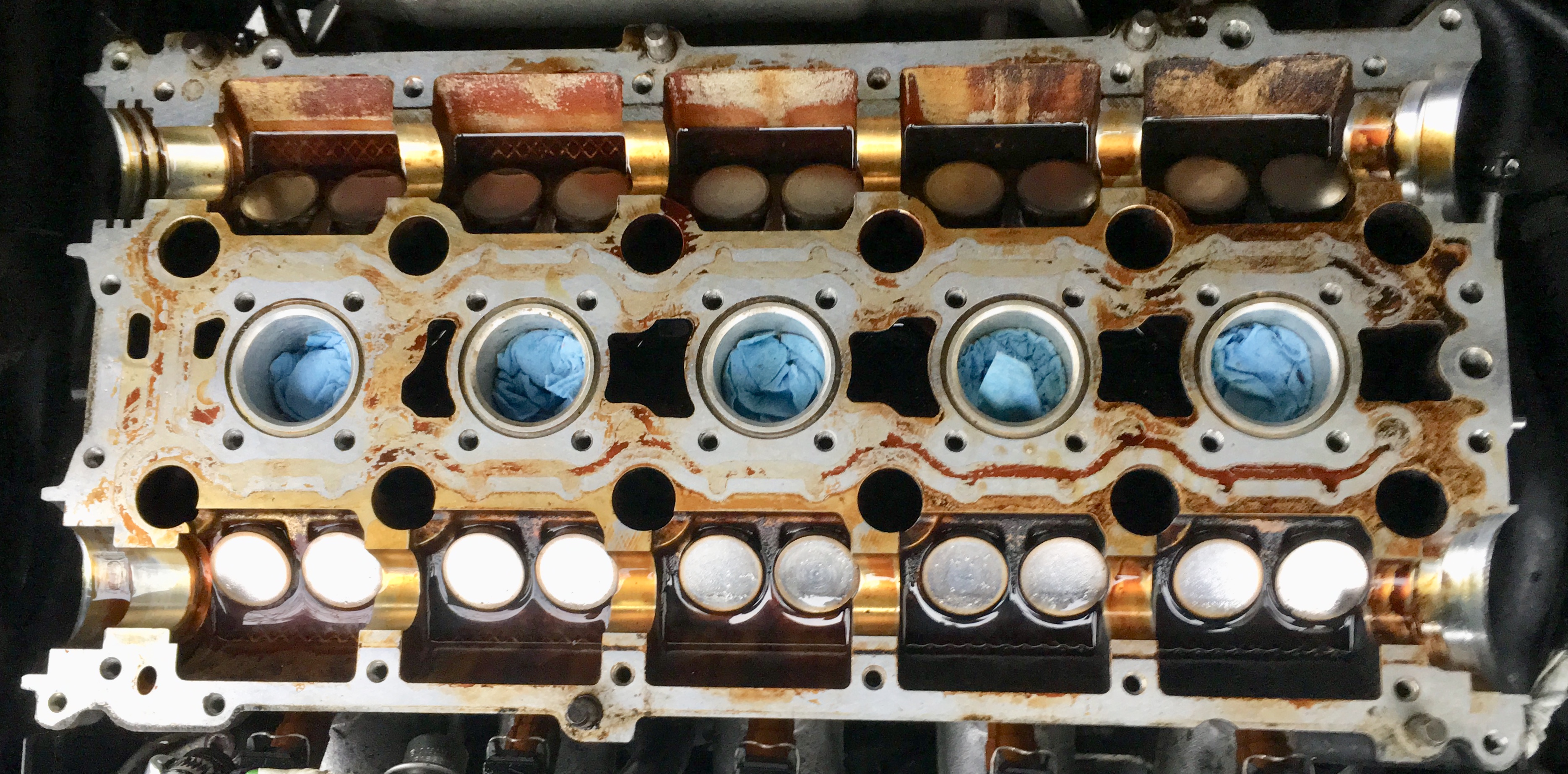

Did a bit more scraping today. I tried a razor blade with a very light touch and it was very effective at removing the very thin deposits. I couldn’t get them off any other way.
