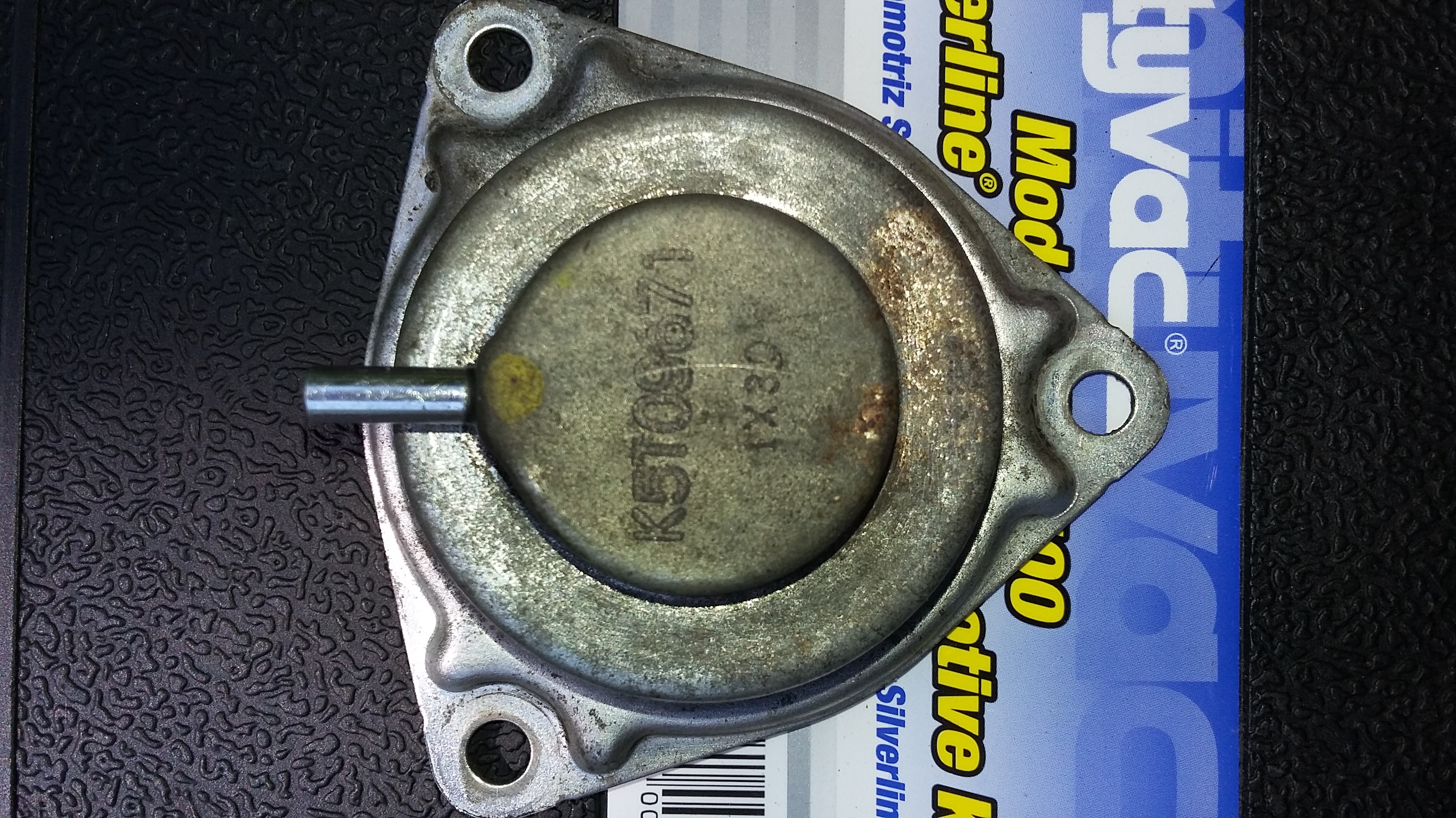

That picture above is just the PTC Nipple - lots of words to describe a hole.
The electrical connector is not a valve, its just a heater to keep the hole clean of scrunge. Thats swedish for oil and grease. You are supposed to clean this orfice every 60,000 miles or so ,I think
Vacuum to turbo. Waste gate?

lol. Thats what I thought too...
I tried with the engine running got it up 3000 Rpms , put in drive gave gas just over 2000 rpms and nothing...
Ok if thats just a heater that should explain the higher resistance 9.3 ohms
Thanks for input.... I pretty much at a lost here...so far all the duct work seems fine all but one 5mm vacuum line had a tiny leak..

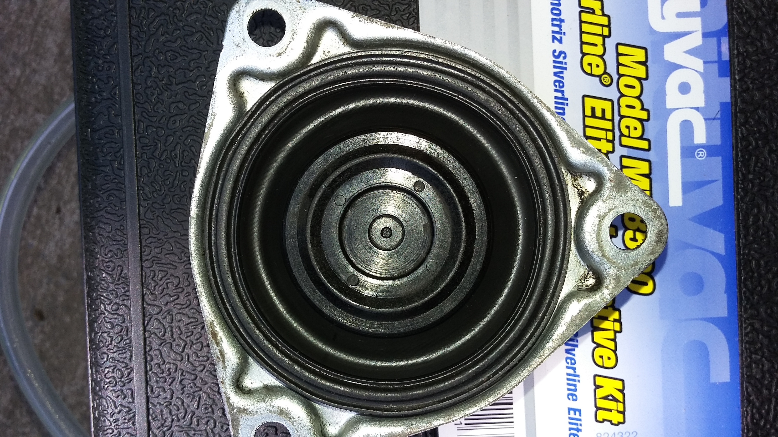

Pop the diaphragm out and see I find there are holes or cracks in it

Sounds like the diaphragm is working if when assembled it will hold the vacuum.
I would say you have a leak somewhere in one of the hoses. Can you build a smoke tester? Maybe unhook every line and try pulling a vacuum capping one end.

Hi Abscate
I did exactly that stretched it flexed it rub my finger all around it just like we were going on a date..
No cracks No dry areas almost seems New... I laid it flat applied vacuum and it help while I made coffee....
