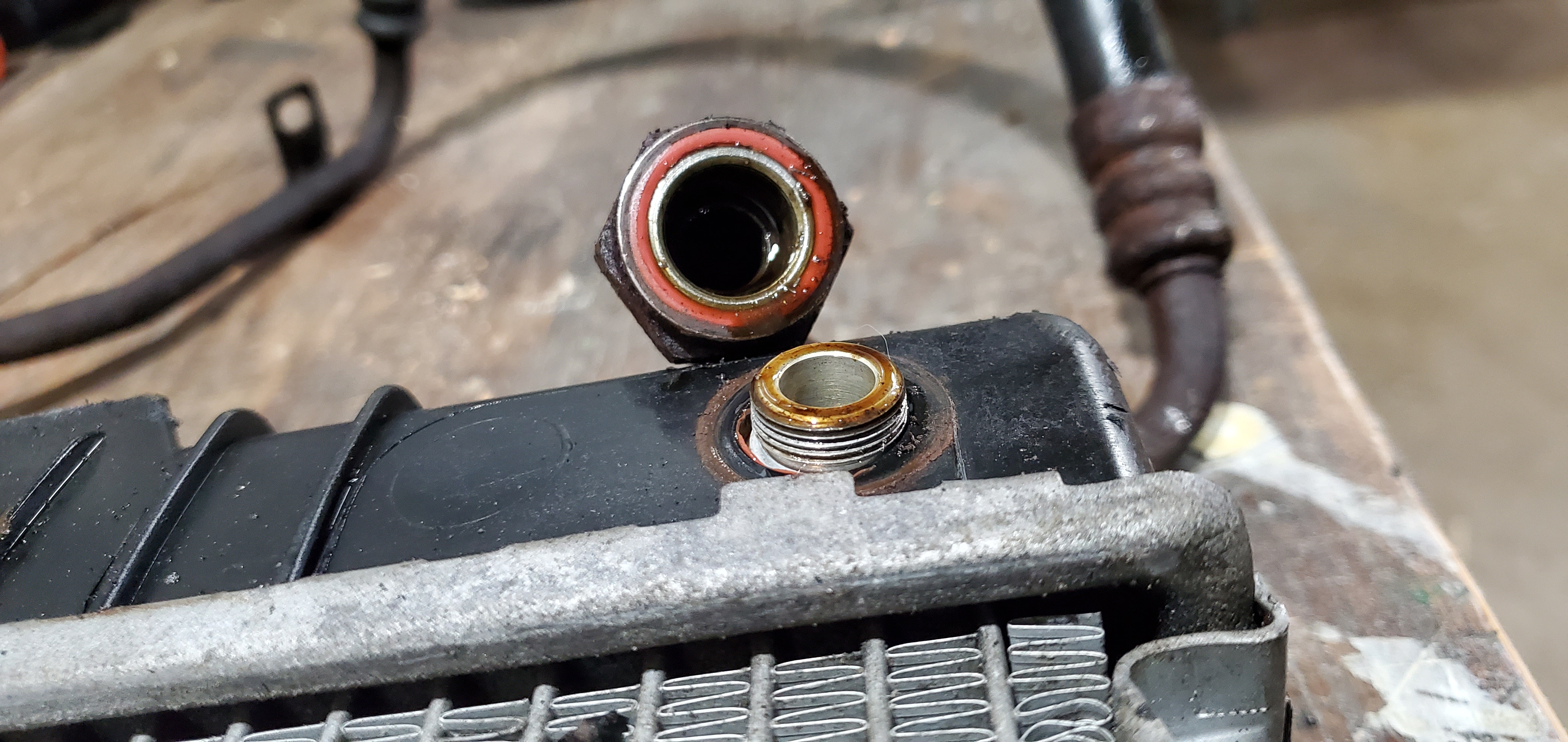

Any tips to get lower oil line off the radiator?

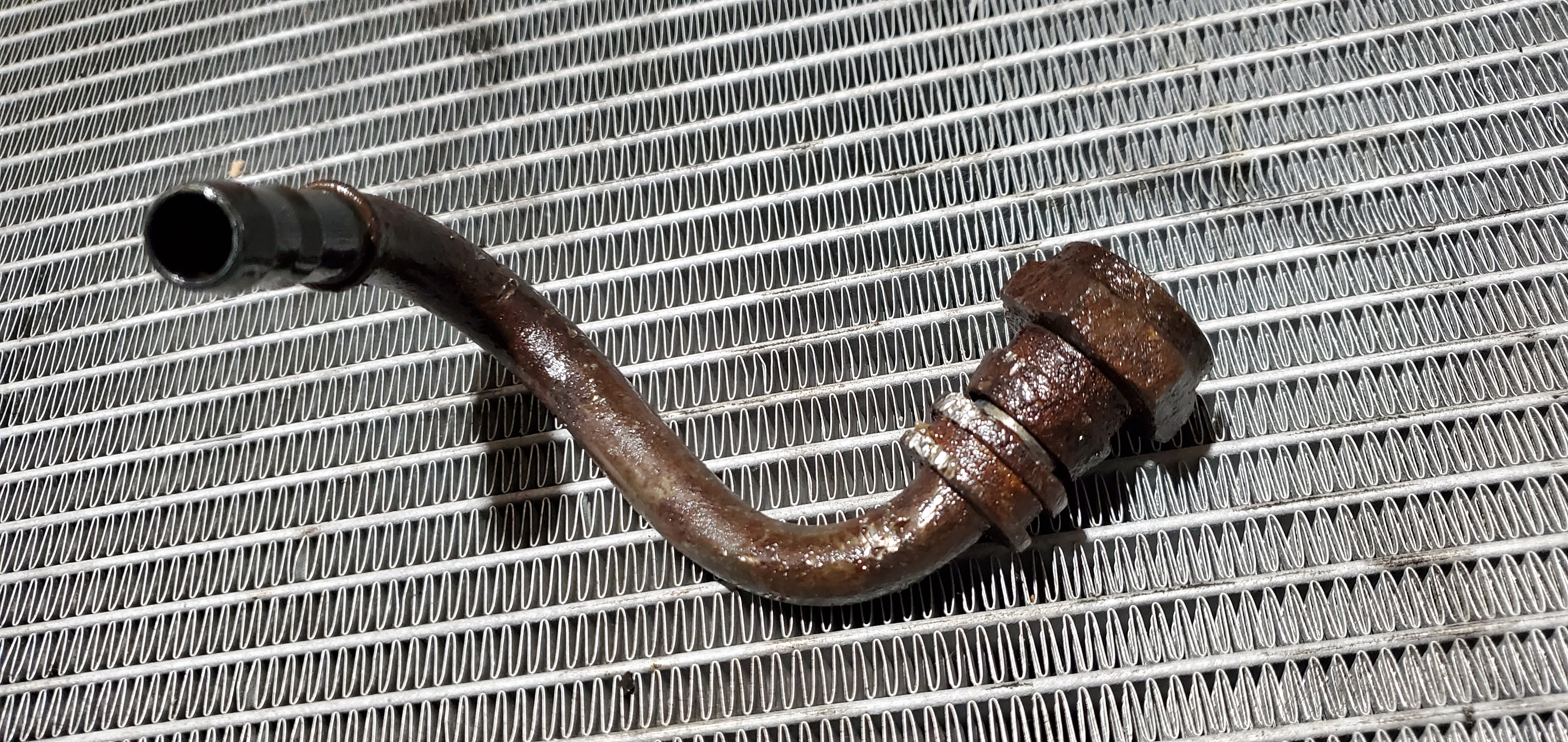

The part in the radiator is ok, but you need to get the line out of the attachment which threads on.
Wow. Maybe a new oil line is needed. You might have to cut that piece to get the line off
That looks the same as my spare Nissens , I can send you that piece. New oring and you should be good to go.

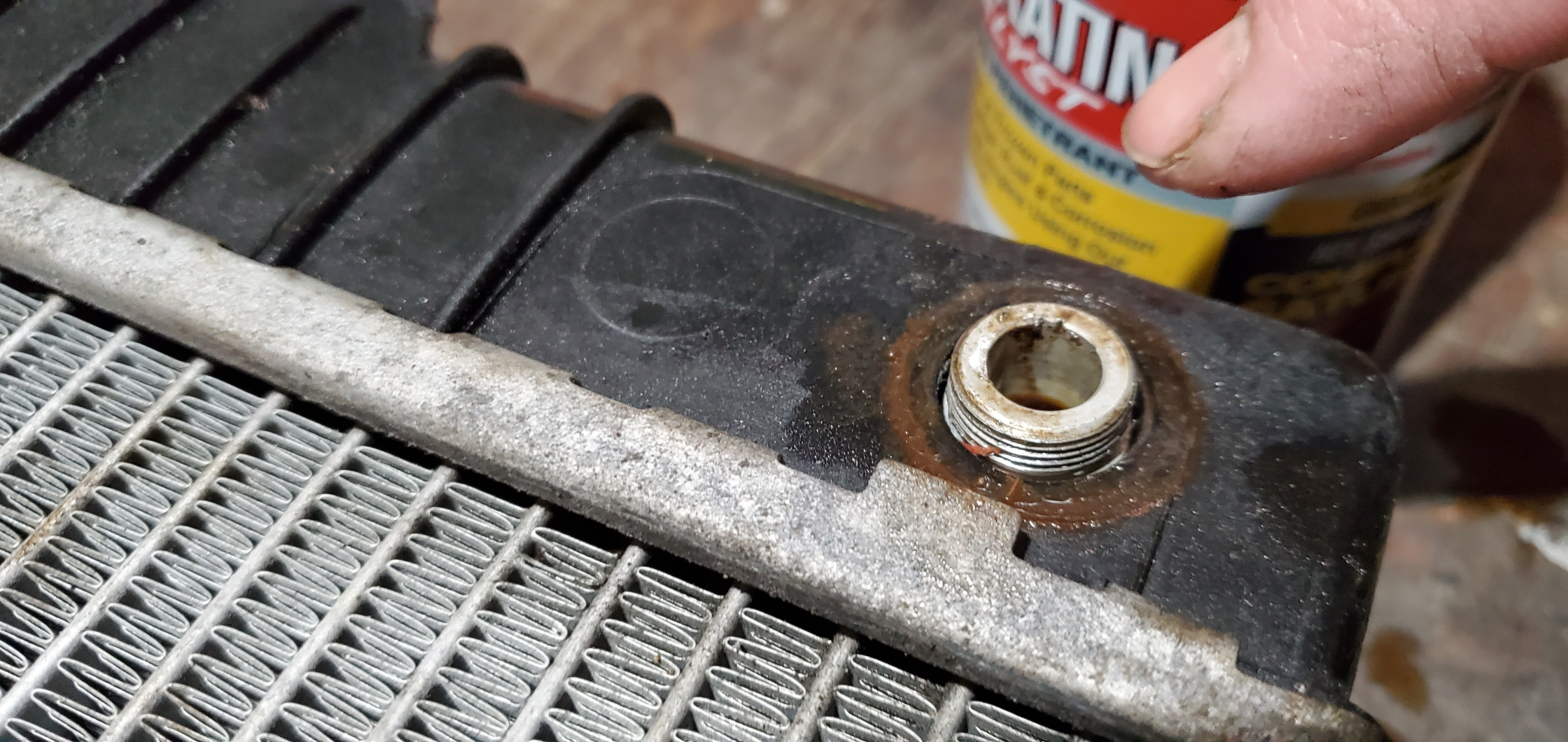

Man, you're too nice! How much do you want for it?abscate wrote: 18 Mar 2020, 00:40 The part in the radiator is ok, but you need to get the line out of the attachment which threads on.

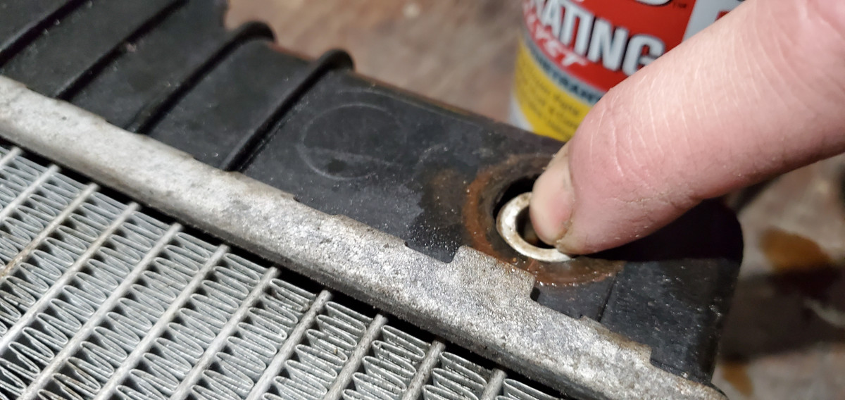

You could try soaking it in a solution of acetone and ATF. Works surprisingly well...

The oil coolers are built inside the end housings. There are seals between the housings and the plastic end housings to seal them. I had issues with a leak at that point at one stage and a radiator shop was able to fix it and pressure test to prove it was then water tight.
