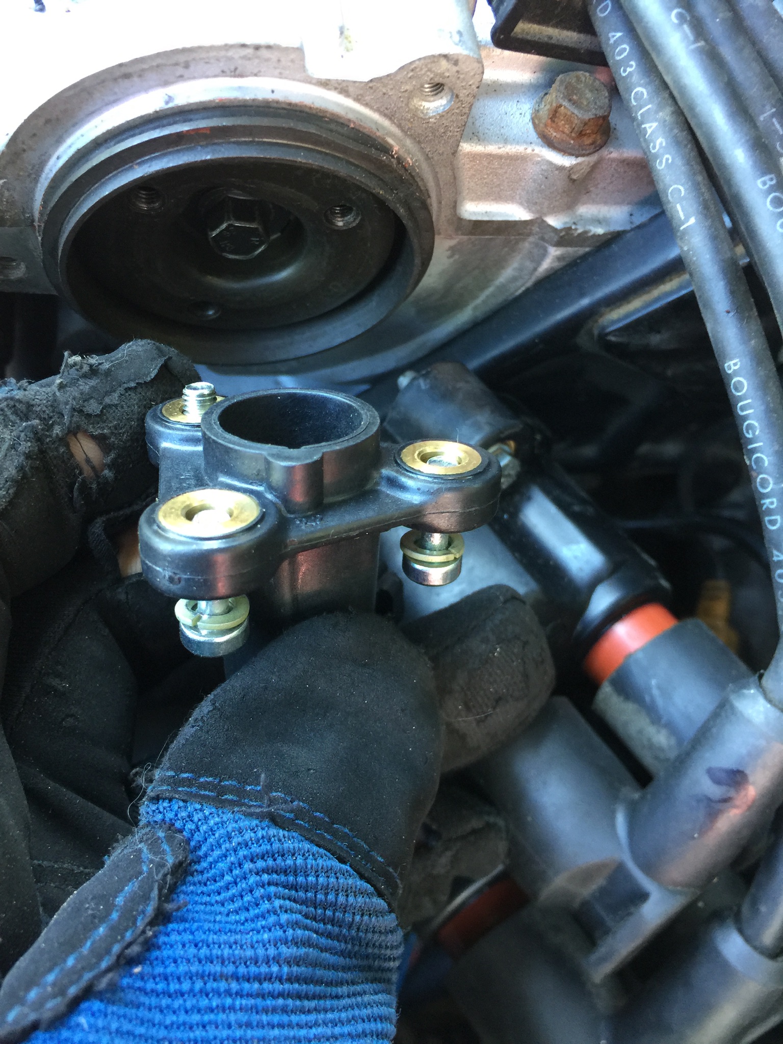

I think you just checked the cams so this is probably irrelevant but: Is the little metal mounting disc under the CPS (and the distributor one for that matter) in the correct orientation? It's possible to mount them wrong and still reassemble, then they are 180 out of phase.
- Posts: 36145
I have not. I thought these were offset, since they go into the cam slots, to prevent this. This might be very good news,erikv11 wrote: 25 Aug 2020, 19:08 I think you just checked the cams so this is probably irrelevant but: Is the little metal mounting disc under the CPS (and the distributor one for that matter) in the correct orientation? It's possible to mount them wrong and still reassemble, then they are 180 out of phase.

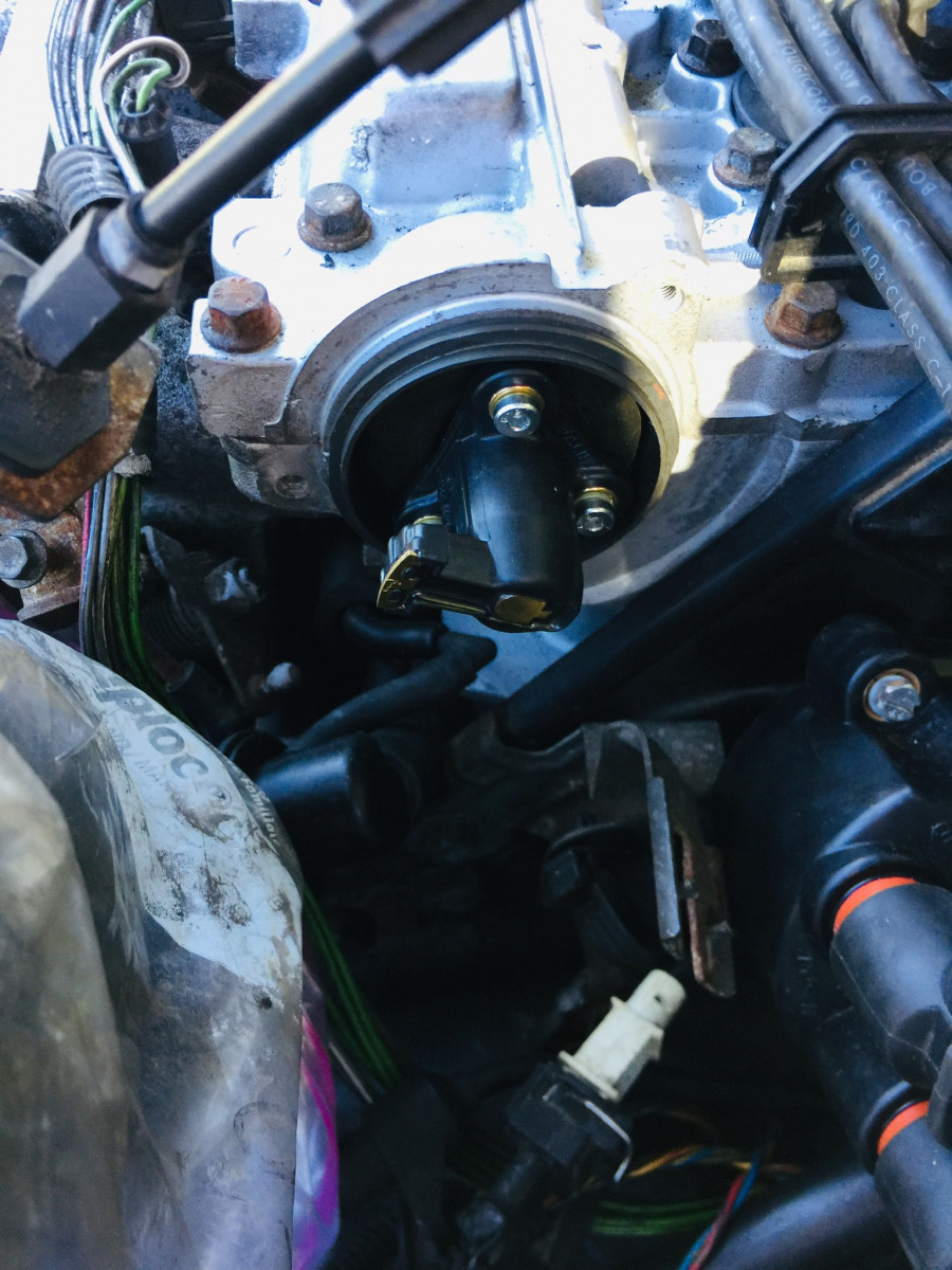

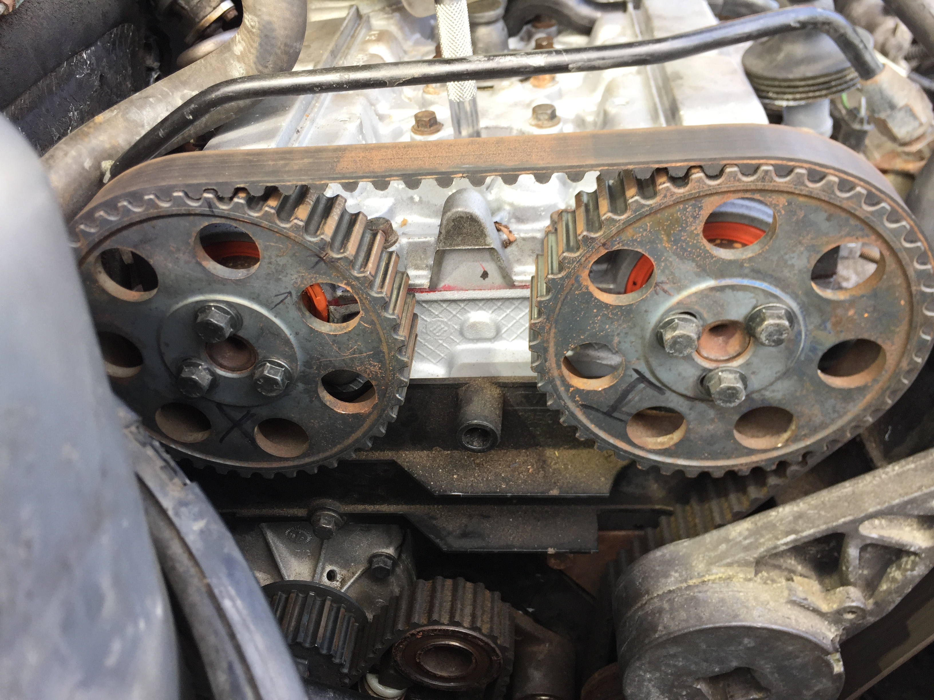

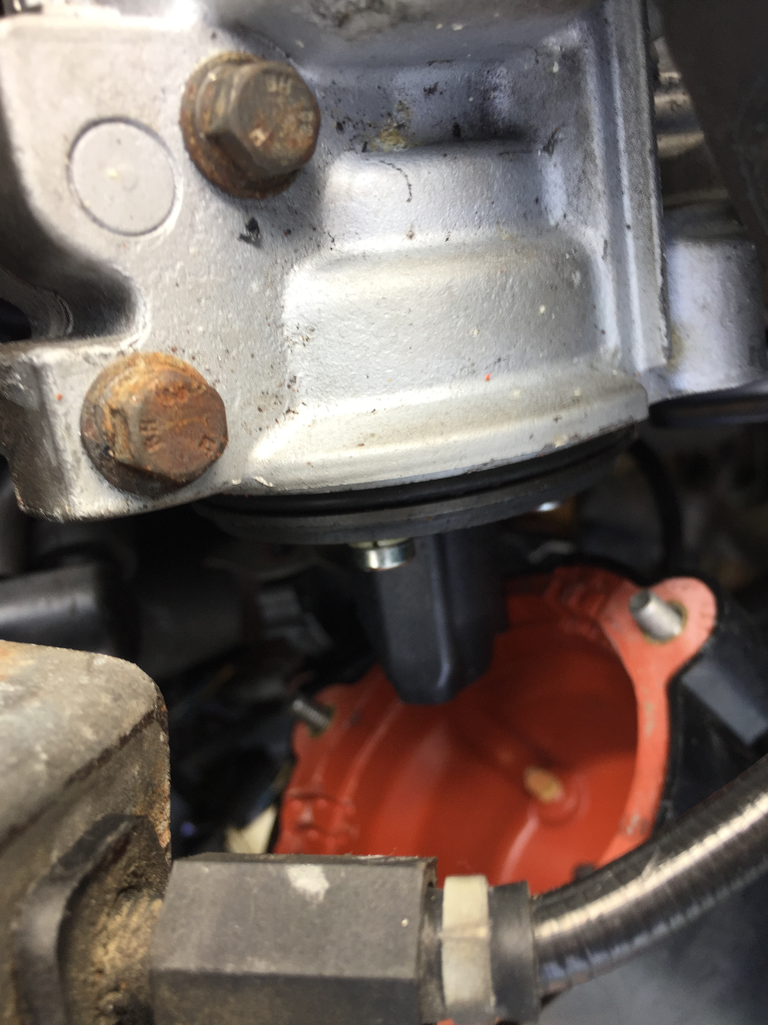

So , with the crank in the mark and the cam gears 180 off the mark
Distributor points to cylinder 1
- Posts: 36145
With the crank on the mark and the cams both on the mark, the distributor points to cylinder 4
Which is right??
Which is right??

Following Erik’s lead , I got to thinking this exactly fits every symptom. No firing , frontfire on ether , good spark at plugs

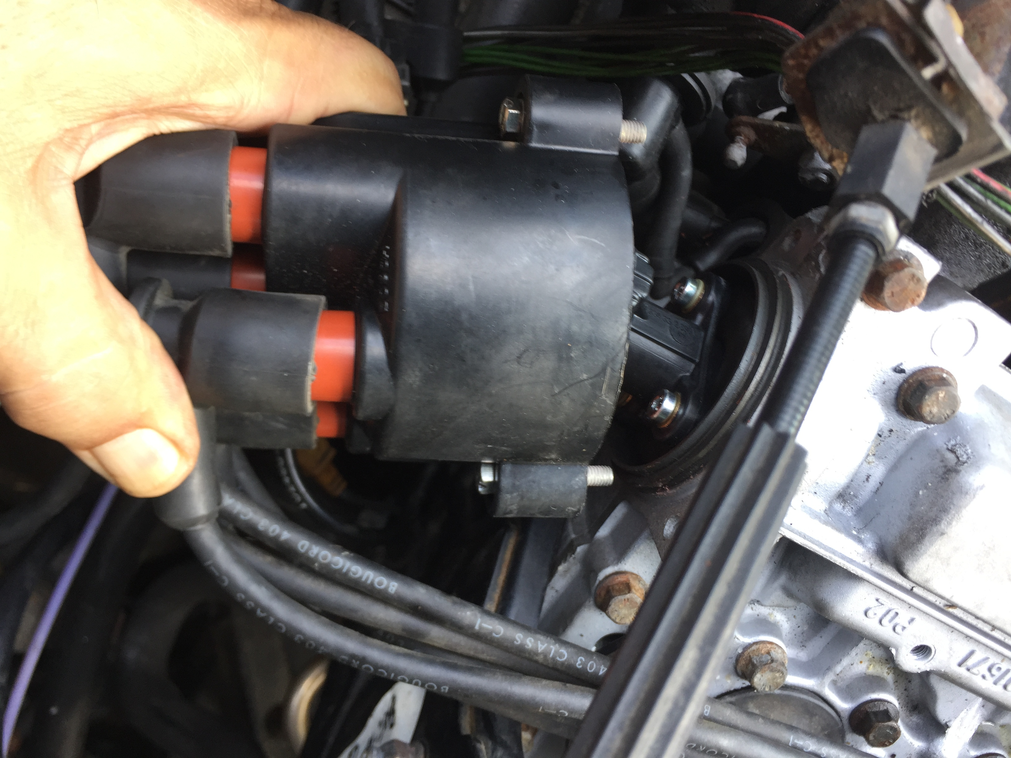

So, I set timing to marks, pulled cap, cylinder 4 firing.

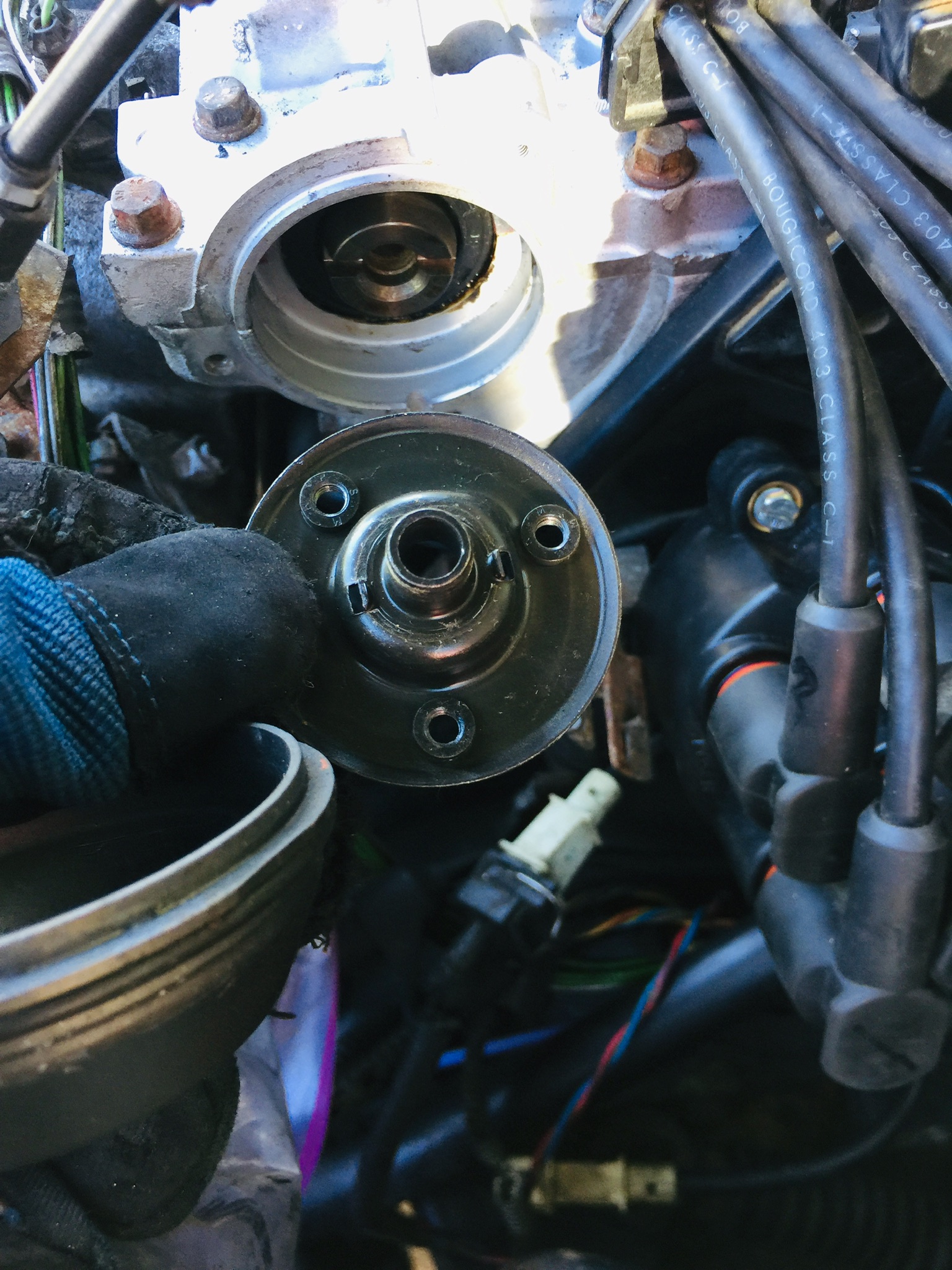

Double check distributor drive plate (couples cam slot to the distributor rotor, one M6 bolt. It looked good , seated it by feel.
Cylinder 4 firing

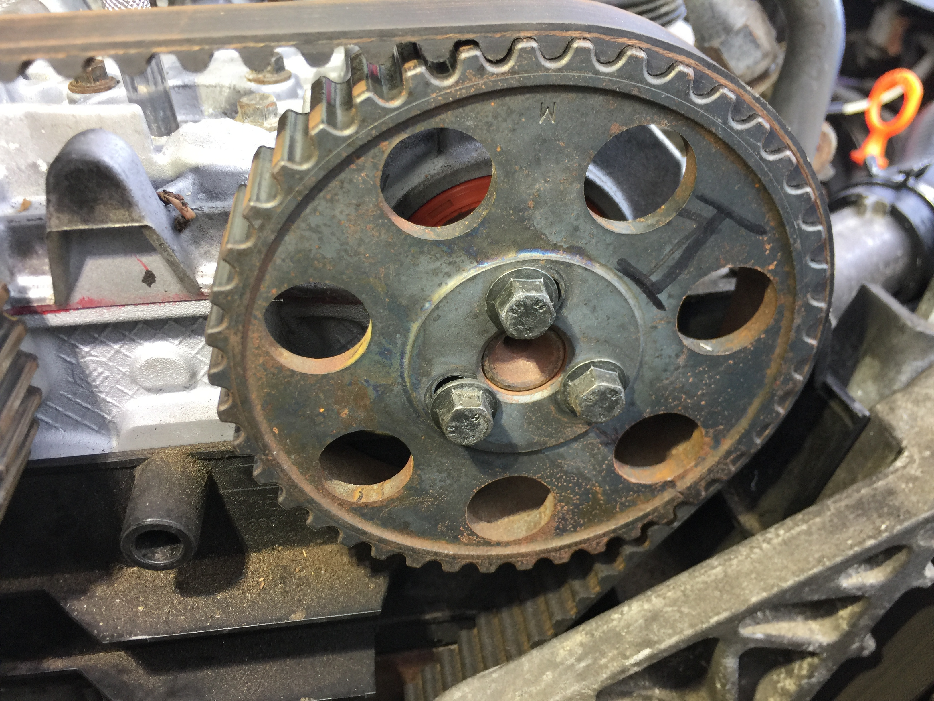

I go to the intake cam sprocket. Do I have that in backwards or rotated by 120? Doesn’t look possible.
Back to the distributor drive plate. I take it out, look at the cam slots and install it carefully
Guess what? Now the distributor points to cylinder 1
Are you kidding me ??
He tries the key......and Earl comes to life, first time since January
Cylinder 4 firing
