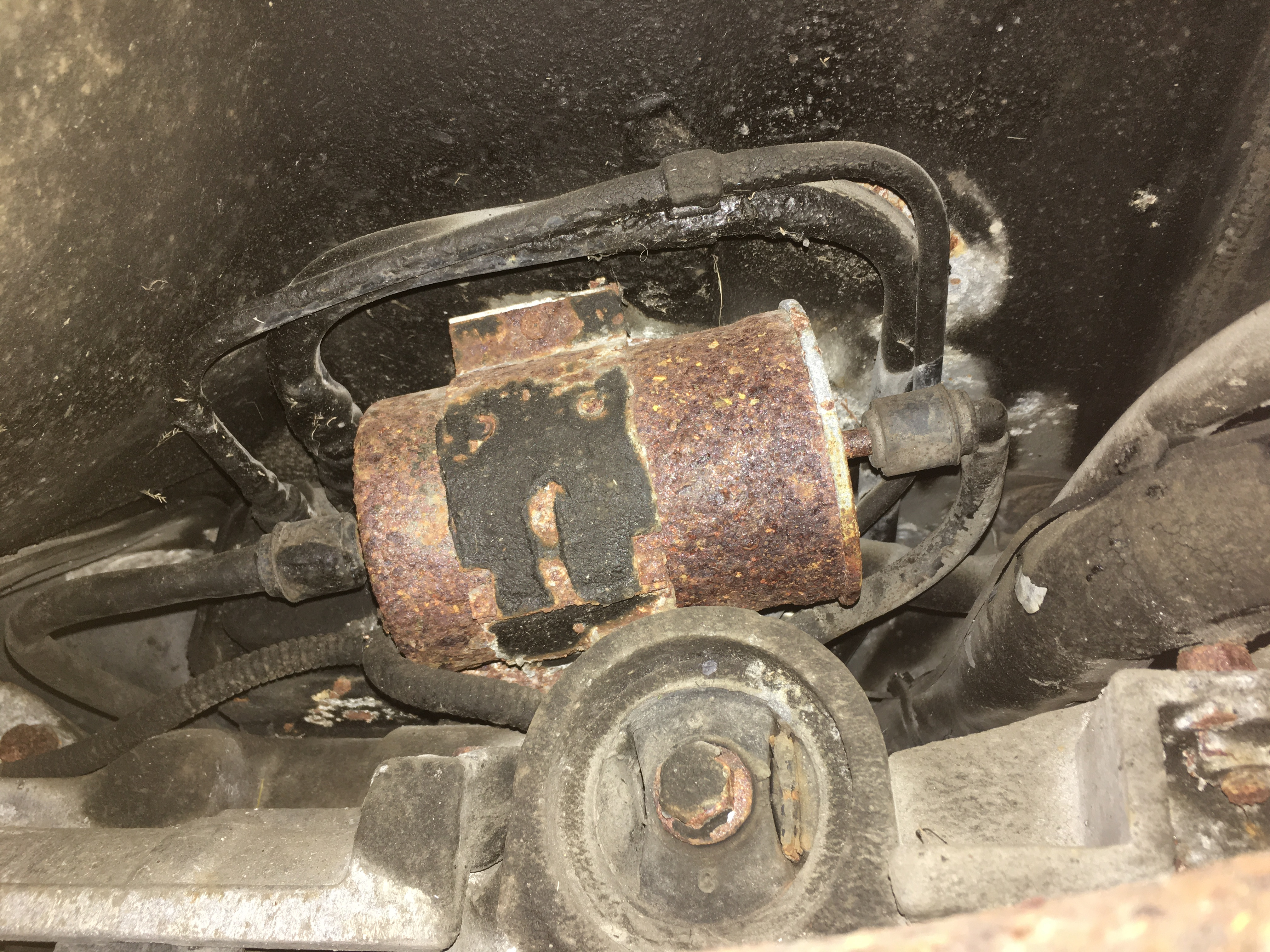

You are just pi$$ed because Neil got dibs on the fuel filter....

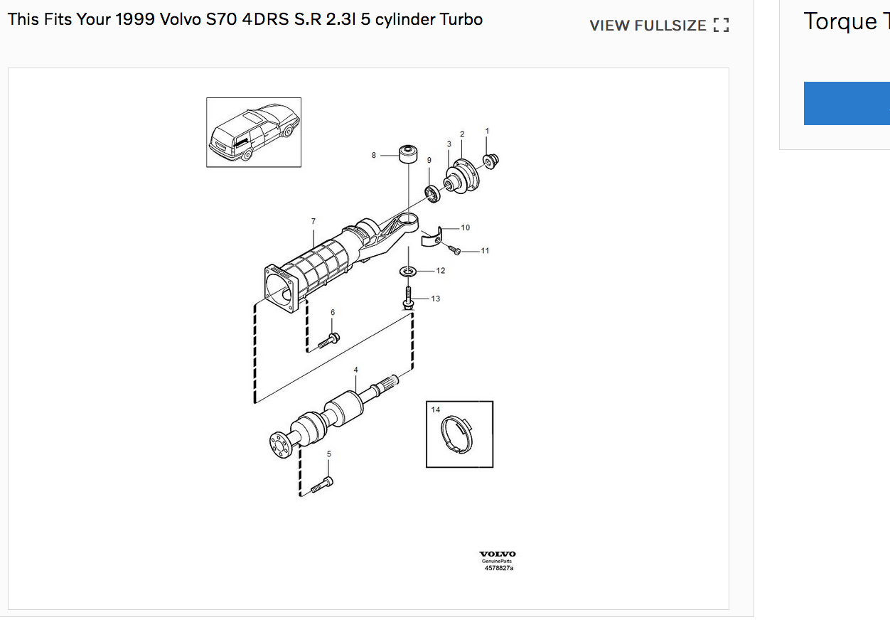

Talking with abscate we identified the 7th bolt (not 8th?) as the bolt holding the front VC housing bush to the bottom of the car.
I have a large circular item in the garage lined with a plastic bag just for that filter!! Have you re-fitted the other bolts before trying to remove these last 2? Have you tried to torque them further first before loosening them?

The Seventh Mysterty Bolt problem is solved
The bolt is listed under the 'Torque Tube' and is number 13 here
Part number Flange bolt 985061
which Skandix.de tells us is a M12 x 80 mm with self locking thread
