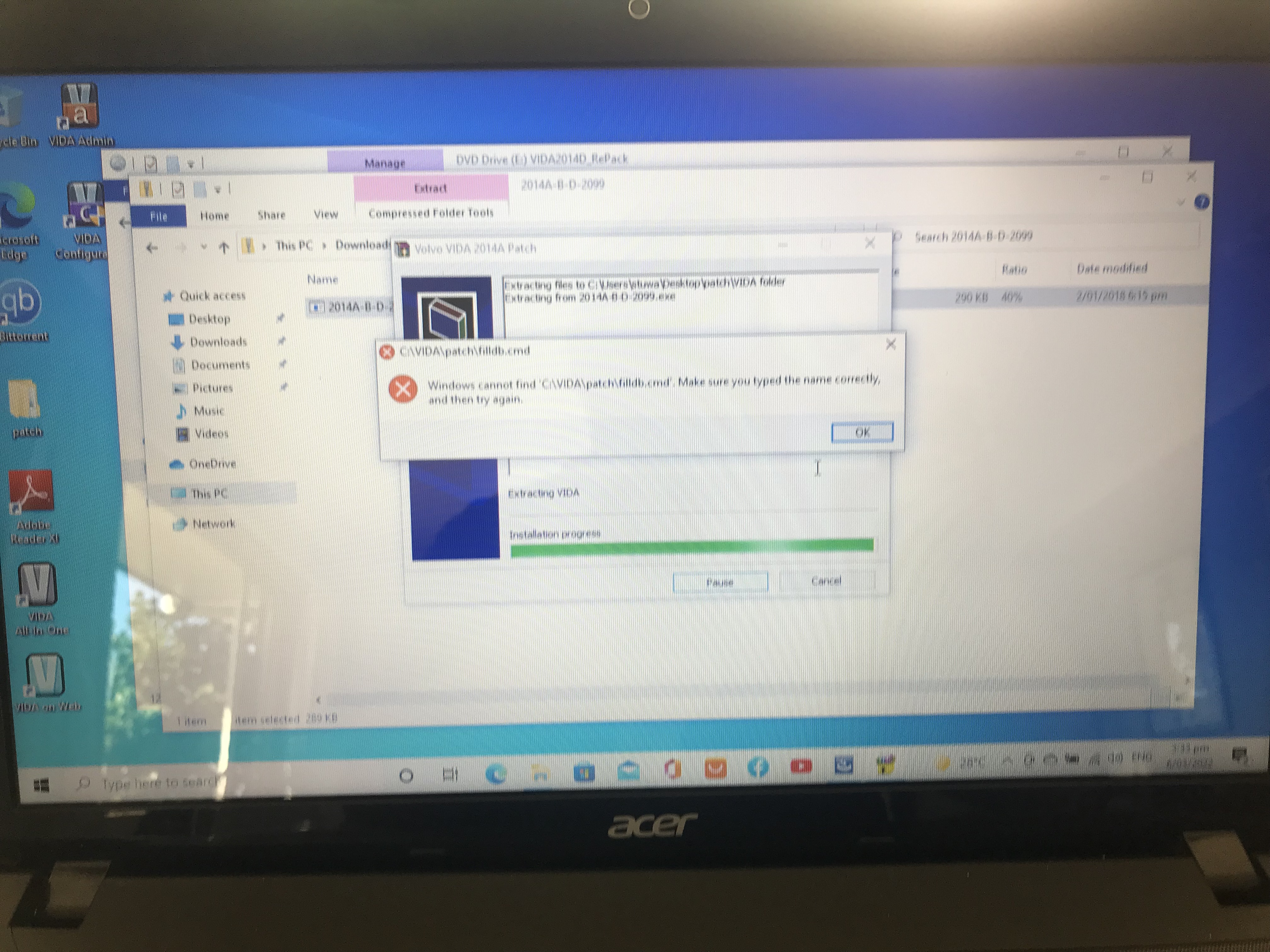

I cannot ‘unpack’ the patch.
I just get …
I have tried for seven days, bought another laptop , Recovered / restarted windows many times on my two machines. I am completely at a loss.
I delete the patch folders, I download again, I attempt to extract and …foiled again
On one machine I have Vida log in page but can’t enter any thing in ( which is what the patch is for) as I proceeded with all the install steps without fully completing step 4 ‘run the 2099 patch’.
I’m very sad - but a dab hand at restarting laptops and erasing everything.
RickHaleParker I need your guidance, I can follow step by steps but am a complete novice and not familiar with the ‘back streets’ of windows.
Am I even doing it right ?

Stu70 wrote: 05 Mar 2022, 21:44 I cannot ‘unpack’ the patch.
The only other time I seen that, it was a download error. Deleting the patch and downloading it again fixed the problem.

Appears that I was attempting to extract into a named folder. By changing the destination to just the c drive it ran and now appears to work. But I have no drop down box for communication tool.
I’ve read one of your posts about running a device install - but quite honestly I have read soooo many posts I now dream of Vida and repackaged.ISO’s.
I’m going to try one more time to delete and reload by following your instructions- maybe tomorrow, now I think I’ve made a bit of headway…
