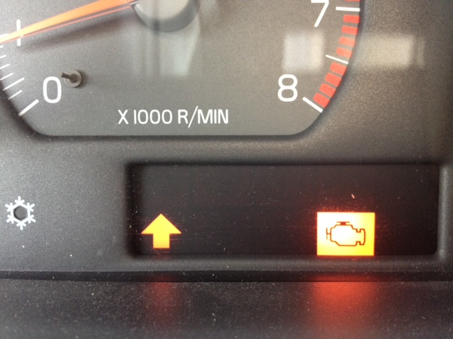

started like this a month ago
- started like this a month ago
