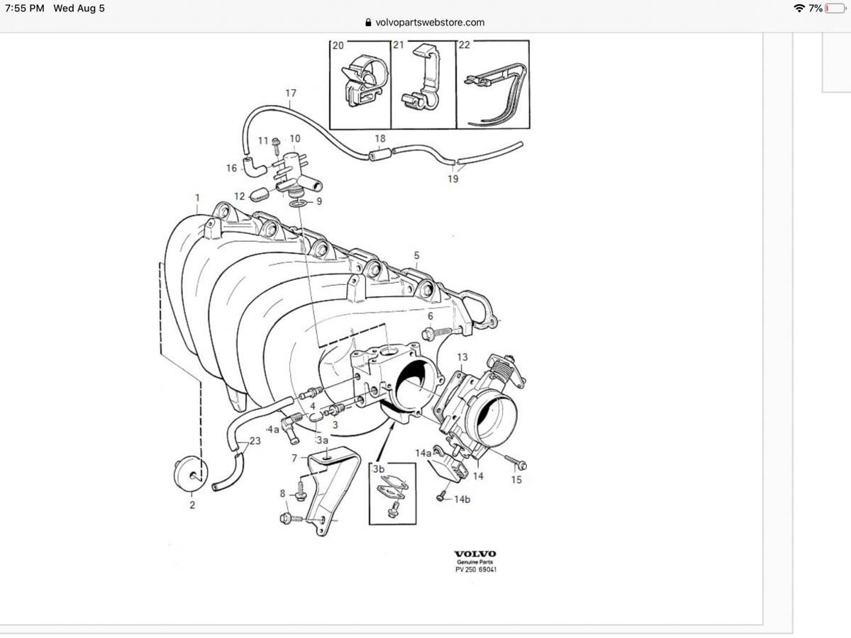

My tip for the day
Intake manifold (IM) installation
4 M7 bolts into slotted holes on IM
4 M7 bolts up top into full holes On IM
One M8 bolt up from below through metal angle bracket shown below
My advice? Attach angle bracket to IM loosely with M8, after getting IM M7 bolts torqued, go back , insert lower M8 and M6 wiringharness bolts, tighten them to torque
Much easier than threading in M8 blind, upside down
