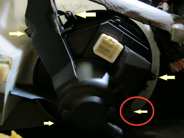

First, your writeup with photos is amazing and very well put together. Kudos. I have a 2001 V70 2.4T, and I was able to take apart my blower motor + cabin air filter assembly, clean it, and put it back together to solve an issue where the car would heavily vibrate when the fan was set to max, and the fan would make a chittering sound when set to low.worldbound4now wrote: 27 Oct 2011, 11:50
Now comes the tricky part where you can feel the frustration of a toddler yet use some very adult words. Using your T25 bit and various 1/4 inch drive attachments, locate and remove the five mounting screws. I tried my best to get a picture of them in place, highlighted with the arrows.
Second... I realize you wrote this up nearly six years ago... but by any chance do you remember what setup you used to get off the back right screw? I marked it in this edit of your photo:
The other four screws weren't too problematic for me, but that one was wedged right up next to the footwell, even with the carpet fully pulled back and the drain pipes moved out of the way, I could only barely manage to get the torx head onto it. Even then I was only able to slowly get it off by making hair-width turns over and over. Eventually I just grabbed the screw with my fingers to get it out the rest of the way. I suppose the issue may have been that my drivers are all 1/2" or 3/8", and so I was only able to use the 1/4" torx heads with a 3/8" -> 1/4" adapter, which added extra height to the head. Even with things like a slim head angled ratchet and a universal swivel adapter it was still a PITA. I guess a slim 1/4" ratchet with a short torx head might have worked, but I don't have those things. Ugh. To be honest, when I was putting it back on, I did the other four screws nice and tight, and just left that one hand-screwed in as much as I could. It doesn't seem to be causing any ill effects, but we shall see.

The tool you need there is a flexible 1/4 drive extension, flexible like rubber, not a Ujoint
