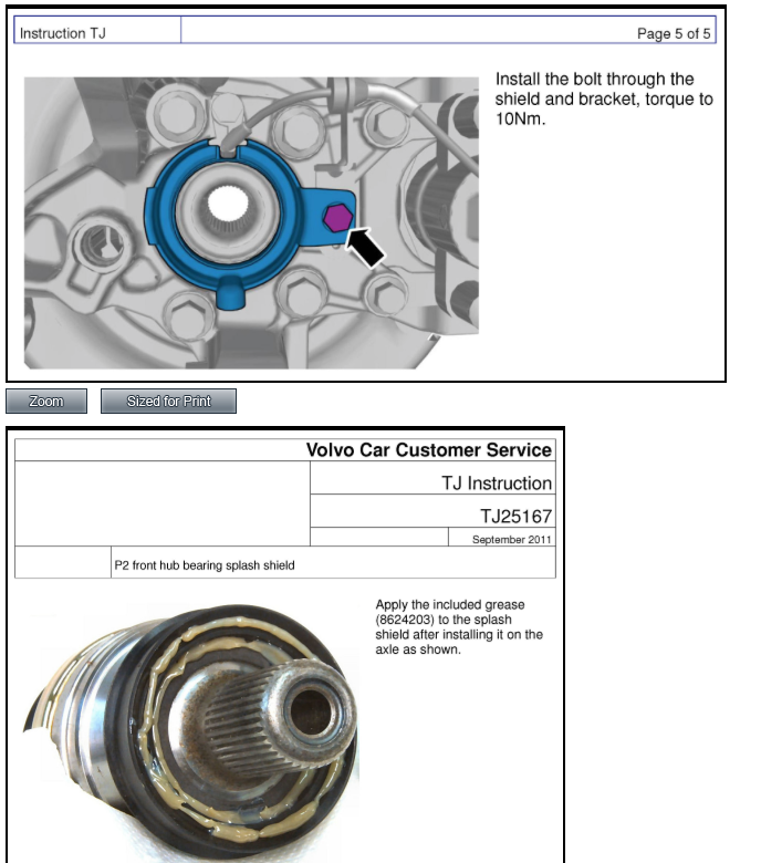

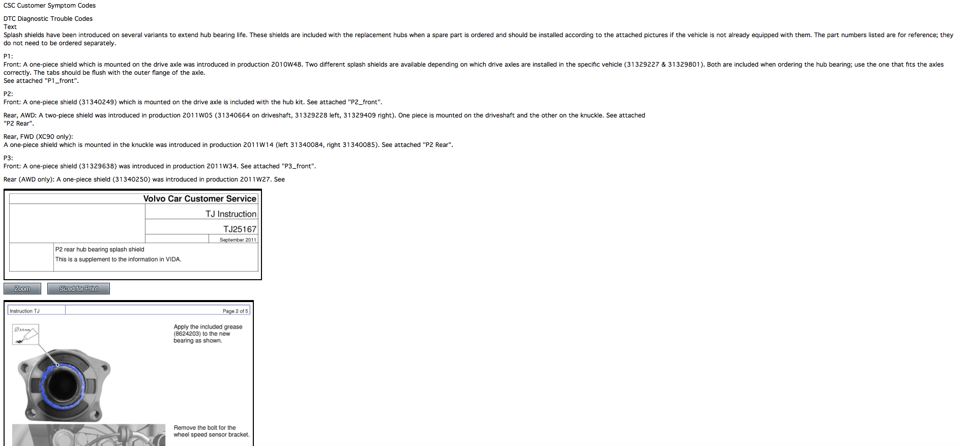

TSB dated 2011 for adding dust shield to bearings on P80s

I can confirm that a wheel bearing will last much longer with a splash sheild when exposed to water, mud, or salt. They were always recommended for such applications. They are not pressed directly against the bearing, so there is no concern that it will allow it to dry properly.
I would recommend it; especially knowing they made one for this application.
How does the shield attach, I see a pic showing it bolt from the rear, it looks like it is steel. What is the rubber one?

I do not have experience with a splash shield but will +1 on the logic - I can't imagine a splash shield would possibly trap water inside the bearing, seems we can be sure Volvo will have at least considered that much when they designed/recommended it.
