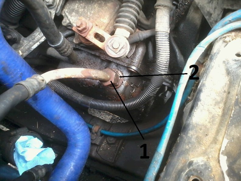

So Im at the point where I need to remove the ATF cooler line from transmission pan cover. There are two bolts, one on top of the other. Which one do I undo to remove the hose? I've tried both and neither is moving. PB Blaster and a torch don't seem to have helped much. Any advice?

Wow.
I really shouldn't be allowed to work on cars. Can't believe I didn't think of that.

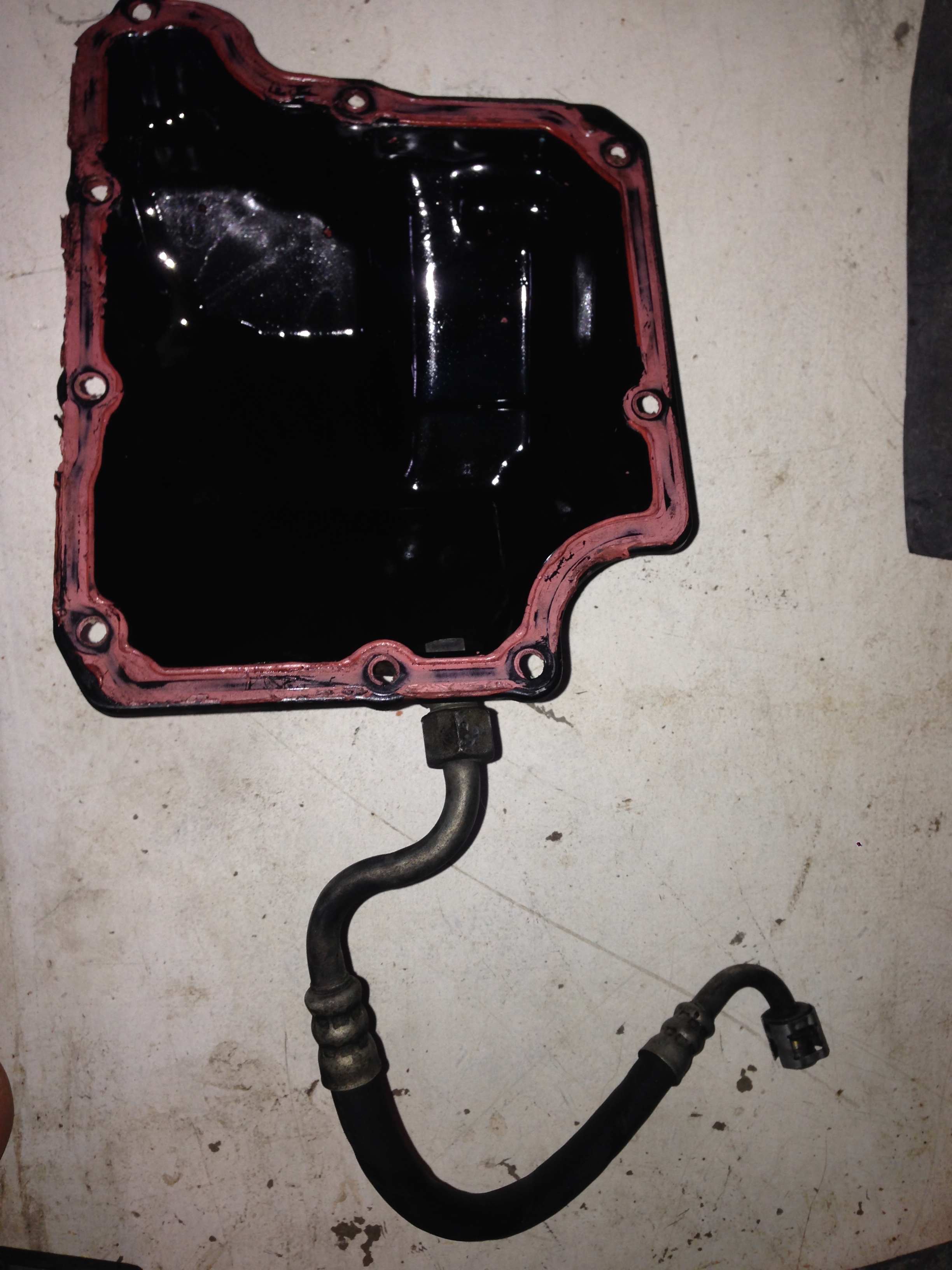

Good news! I got the S2 and lock up solenoids replaced and everything put back together.
Bad news! My gasket paper did not work at all and I'm leaking ATF like a sieve. Looks like I'm going to have to drop the subframe and use RTV after all. Such is life. And for what its worth, my S1 solenoid is one of the later ones; it is different than the S2.

I just replaced my s2 and lock up also, All is working perfectly thus far.
Also got all parts from trans parts direct.
I also used gasket paper, Ive had no problems thus far.
This is the Gasket paper I used.
http://www.oreillyauto.com/site/c/detai ... &ppt=C1984
I really hope I don't get a leak in the future, that would suck so much.
