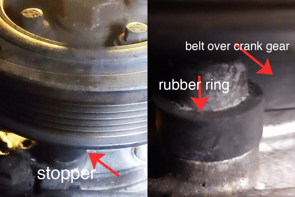

Why the belt wouldn't come off from the bottom of crank?
I am guessing pulling the rubber in off of the thumb would make enough room for the belt to slide out, any comments?
a thumb with black rubber ring...
I am also guessing this rubber ring prevents belt from malfunctioning, keep the space just tight enough for it to keep the close hug and not slide.
Could I slide out the rubber ing, and put it back on after the belt install?

Did you already take the metal shield around the pulley off?
And yeah, that stopper thing is right in the way. Just pull the belt off everything else and you can get to the water pump. I wouldn't pull it off the crankshaft pulley because it's just A PAIN to get back in between the pulley and whatever that rubber thing is.

Yes. Located around the bottom right quadrant of crank, the metal plate cover was held by two bolts, it is out in cleaning pile.

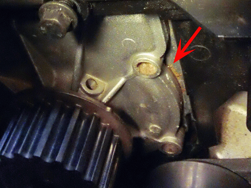

No success with water pump removal. It cemented harder than i imagined. Thinking about using pry bar as a chisel to wedge between the two mating surface. The pointing arrow may be the widest and most accessible surface.
pointing arrow where pry bar may work, not sure, i have to try...
Would PB Blaster help soften the bond?

After a good number of knocks with wooden mallet, the water pump would not yield, but more coolant has escaped.
scratching head...
Like the belt removal is depended on removing each tensioner, I wonder, if water pump removal, in some mechanical way, tied to removing roller and the pulley, or the invisible 8th bolt?

You have a new water pump in your hand. You can count the bolt holes and locations and make sure you have all of them out.

Sunday was set aside for family hence no time for repair, but counted the bolt on new pump. I have all seven out.
Read through the instructions this morning one more time, and did not see one missed step.
It is a start of work week for me, which means little time.
The water pump won't come off, ran out of ideas.
To remain focused, I will take out the rollers, and then make another attempt on water pump.

Now that the water pump is off, I am moving to removing the T45 on the roller. With a 3/8 adapter, I would use a 15mm combination to fit the space. So I have solve the tight space problem. I Would pull it from 3 o,clock to turn it counterclockwise. Is there a better method, wrench position, or tooling?
