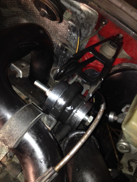

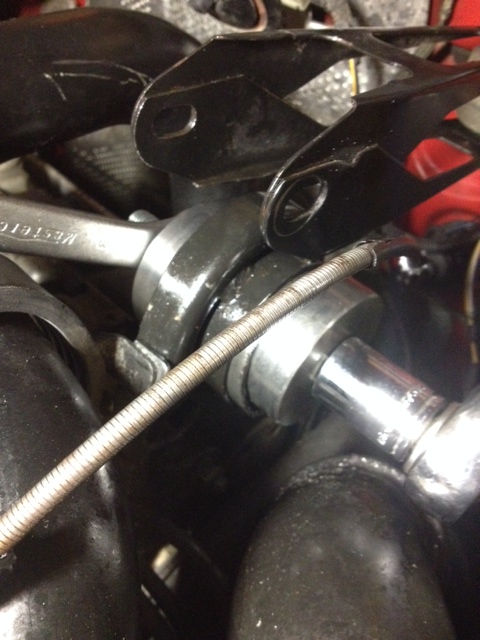

I tackled the upper torque mount. Being an Engineer I desgined and had a machine shop make me a press. The 'right' press puts load on the outer ring of the mount, the 'left' press pushes aganinst the assembly.
It took me way too long because there was a post that said a 3/8" bolt is acceptable. Trust me, don't use a 3/8" bolt!!, it will strip and cause you lots of grief, I tried it twice. I spent hours taking apart the stripped bolt. I used a Canadian Made (not Chinese crap) M12 bolt and it worked perfectly the first time. Make sure you lubricate the opening and it helps to lubricate the threads on the press.
I also changed the transmission fluid. Big difference in performance and shift quality! Really, I was surprised.
