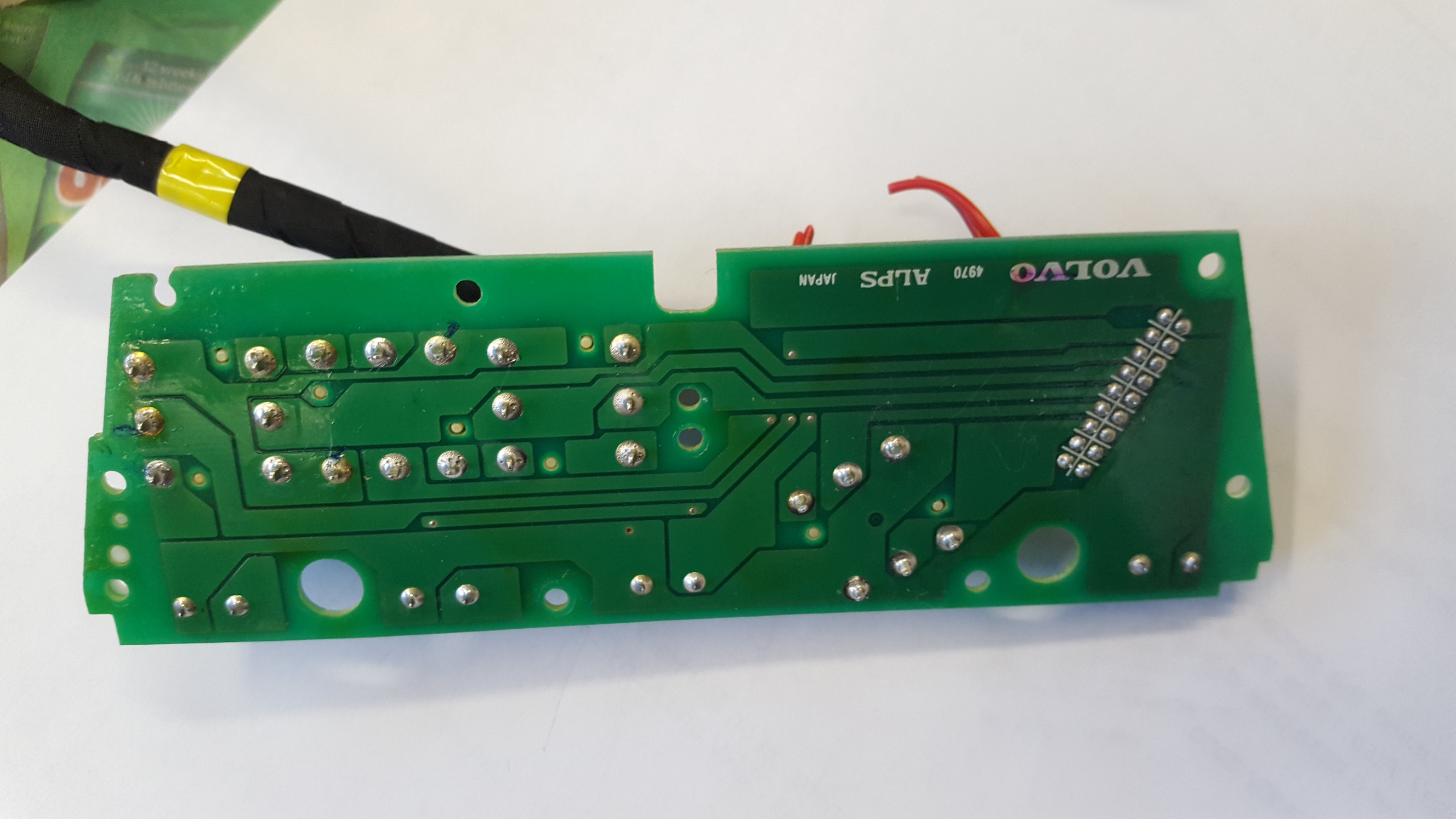

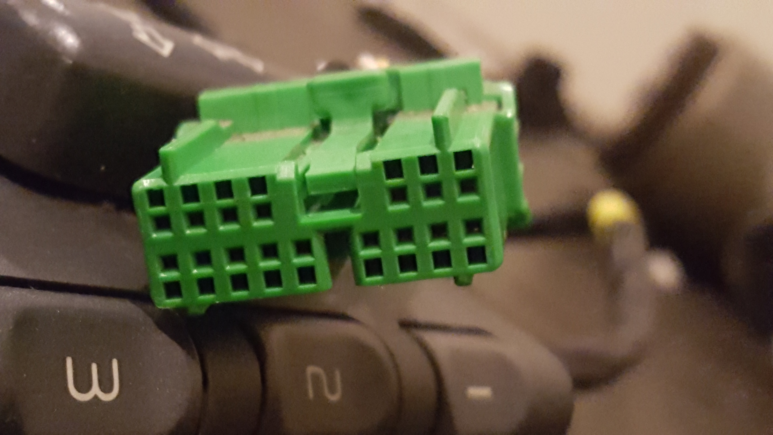

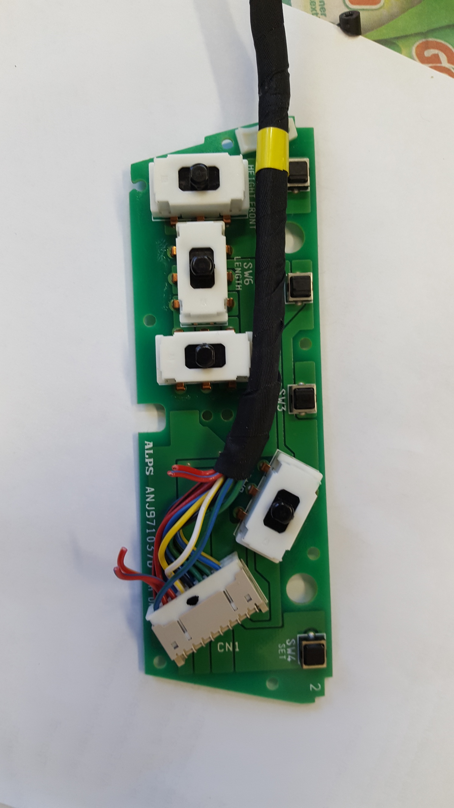

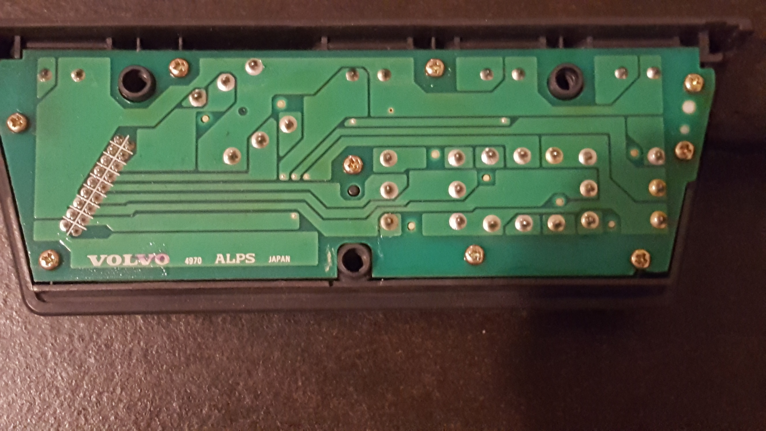

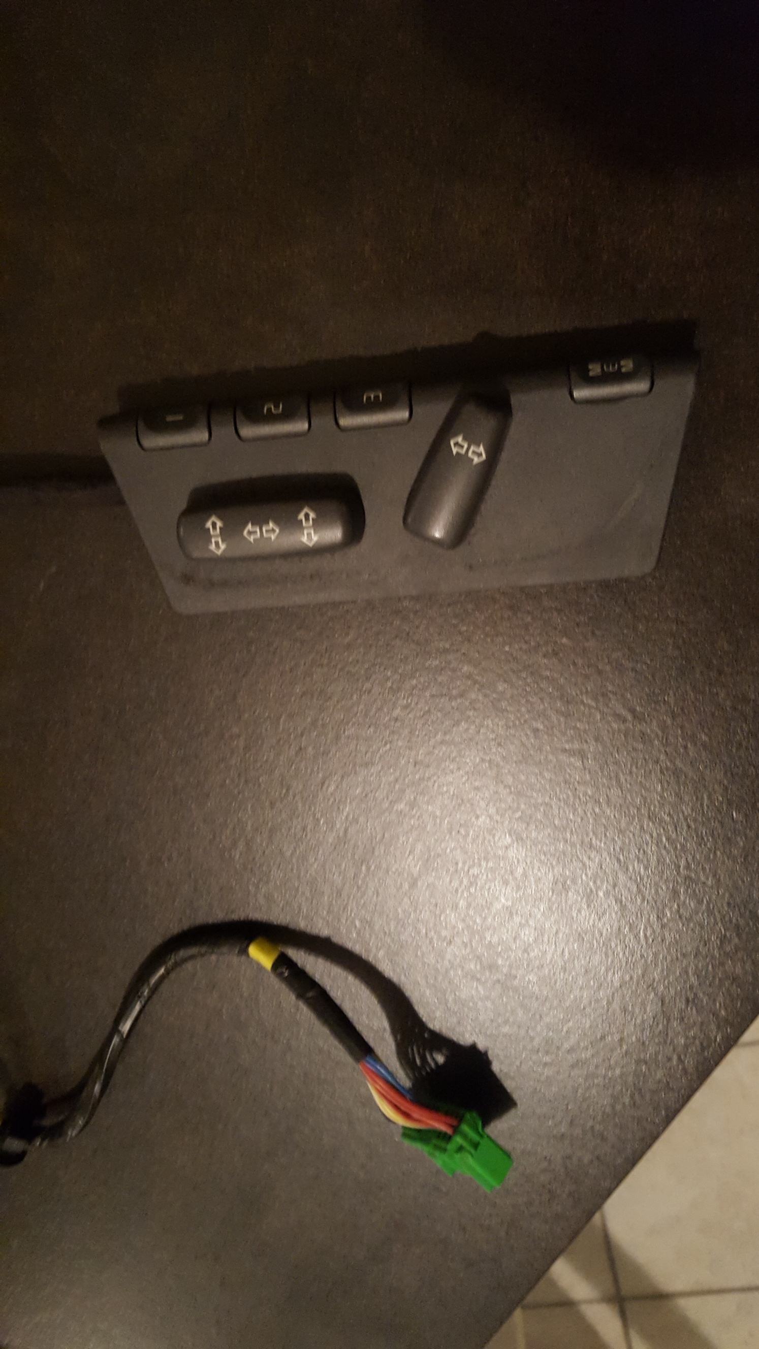

My passenger seat is identical to the first seat in this post. However my drivers seat has an addition 3 memory positions and the circuit board is a different configuration. I'm also trying to fit these Volvo seats into another vehicle. Jeebo can you help me sort out the wiring. I have posted some pictures of the actual seat switch. 3 of the 4 switches are wired the same as the first seat one in this thread however the first switch is different. any help would be appreciated. thx

I'm going to guess that later seat is controlled by CANBUS, whereas wades seat was analog
That's going to take some coding and hardware to tune up that tuba
