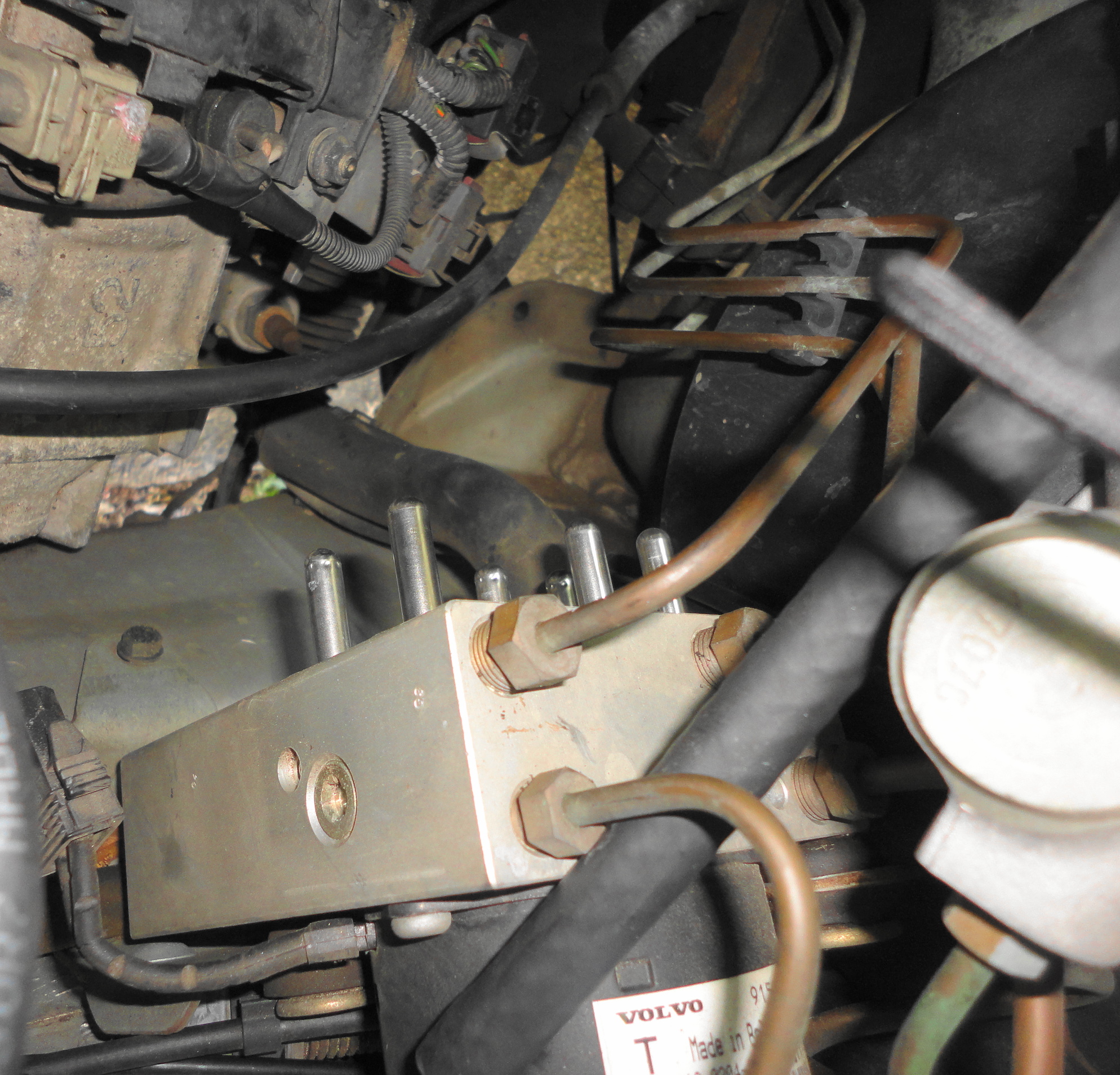

So.. Today I too, after reading this, found the courage to fix my abs controller.
I got it out quite easily.

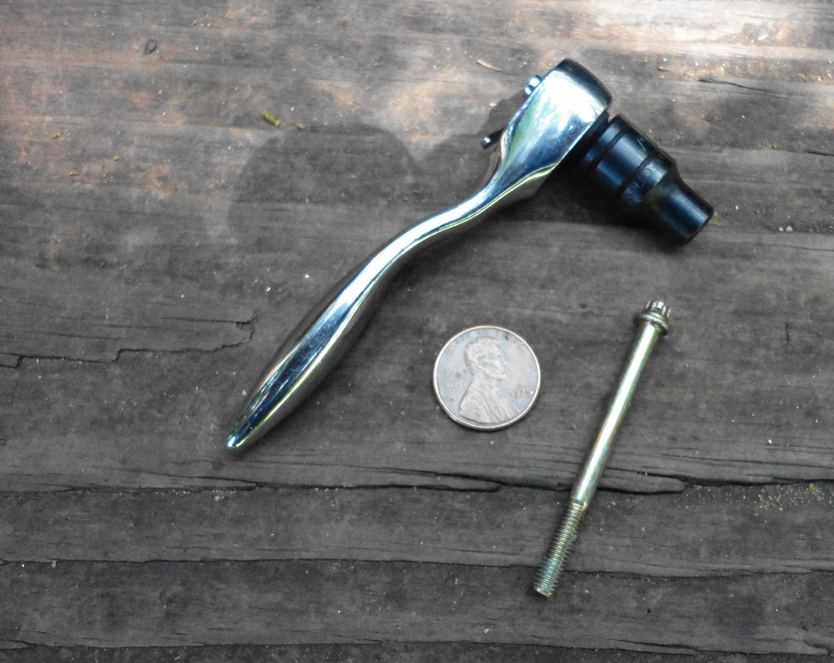

A 4mm socket will fit just as nicely. And most cheap socketsets here include that socket.
I have a turbo model and it is a bit fidly to get the bottom ones out. but They are not very tight. so once crack them loose, you can twist them out by hand just using the socket. Wich saves a lot of room!

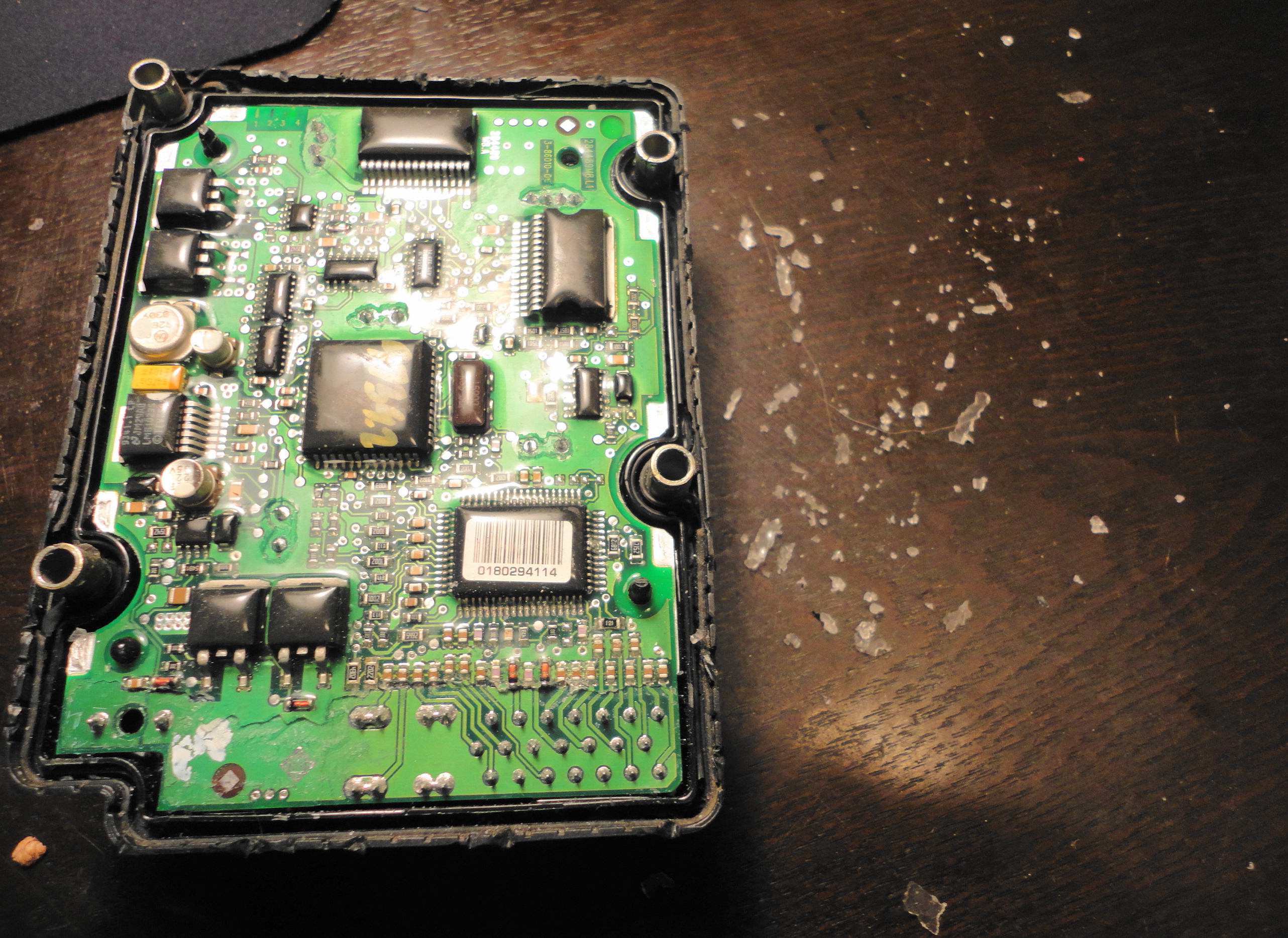

Whatever will be the case, I cracked on opening it.
The washers came off easily when lifting them with a scalpel. And the two halfs seperated easily too..
This showed it had been opened before. there was also some aftermarket sealer in between. I think it was gasket sealer. It is really soft and opened way too easy to seal properly.
The top layer on the circuit board is only removed on the two big solders points on the bottom. So they only soldered that and called it a day I guess.
I will just make the solder flow on all of the contacts on the original page one picture and see what happens.

So peeling of the silicone of the board took longer then soldering and putting it back in the car, but ok.
I resoldered every connection. Put it together with some ducttape and installed it in the car.
Drove 20 meters and abs light went off and never came back
So I took it out again, cleaned it with some breakcleaner to make it fat-free and sealed it with some nice strong transparant acidfree silicone sealer.
Its drying now. Will go back in in a few hours. The car wont be driven till tomorrow anyway. So then it will be all dry and strong.
Thanks very much for the instructions!!!!!!!!!!

There is a bracket that has a large vacuum hose running through it and the bottom of the air cleaner attaches to it; I removed this bracket to accommodate the 1/4 ratchet. I was able to get to the back outer screw this way.

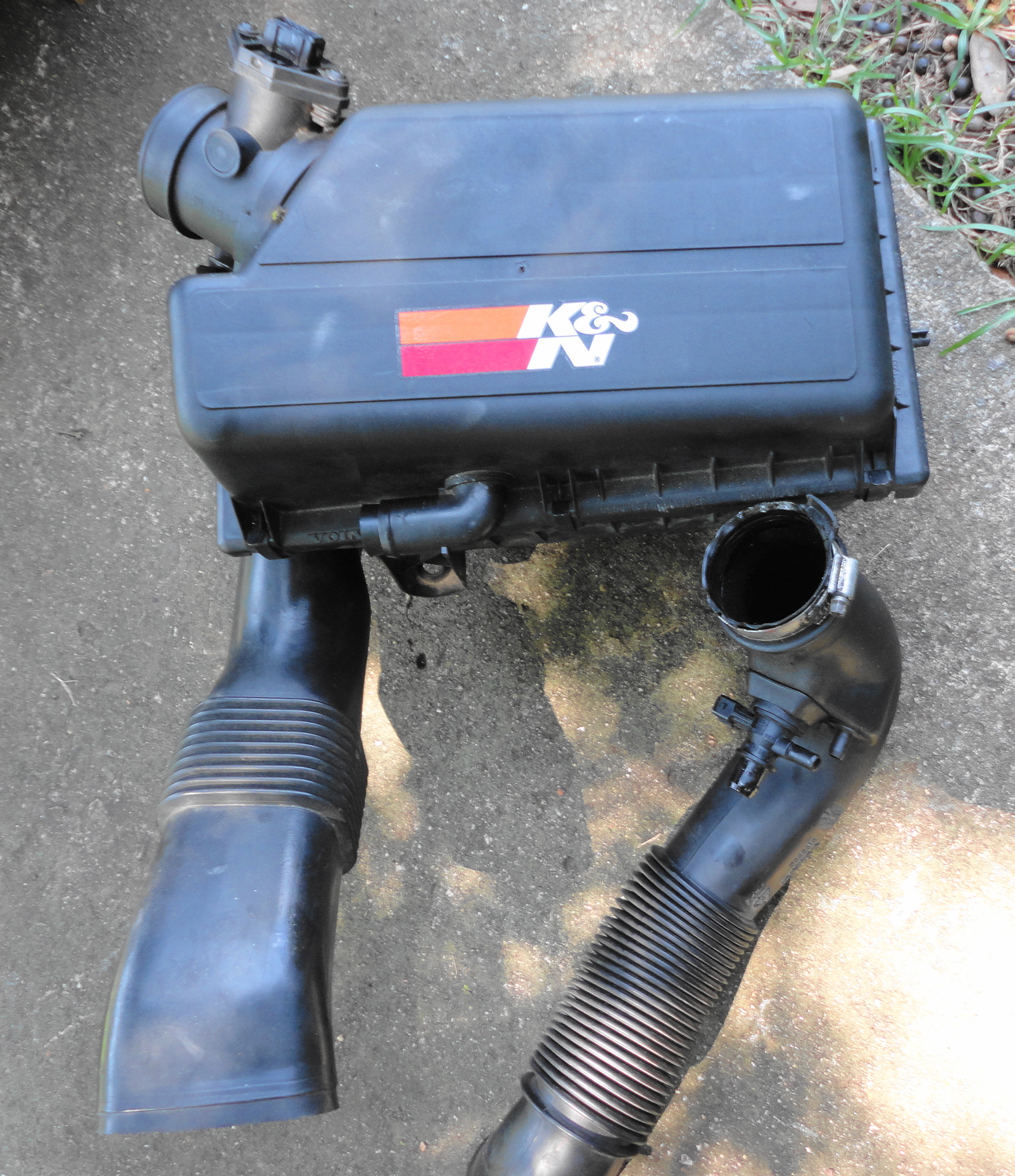

Did this on my 1998 V70 AWD this afternoon. ABS was fuse number four on my V70. Took out the airbox and air pipe (turbo) for easy access. Good time to clean PTC Nipple as well. Used a 1/4 inch drive mini ratchet with E5 from eBay (2.50 plus $2 shipping). Also used former suggestion of screwing down box with four screws and pried lid off with wood chisel (came off with no problem).
Most difficult part for me was getting the old silicon off the power points. That took over and hour and I ended up with about 1000 little pieces. Only found one cracked point but hit them all with solder anyway. A bit of black silicon, several hours to cure, and it's all back together with no tracs and ABS lights!
