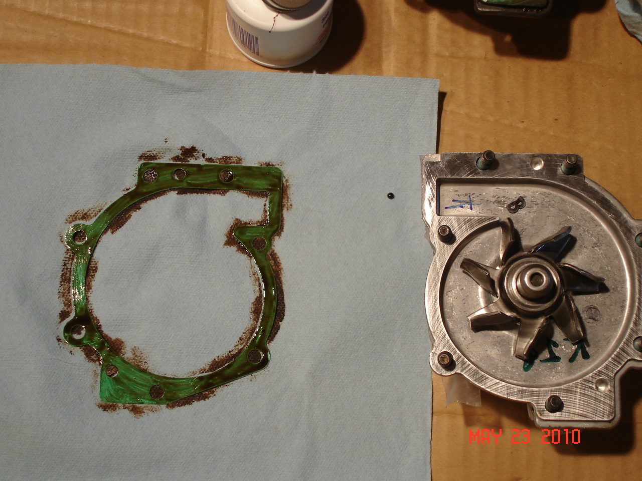

I tried a razor blade to clean off the old gasket. Difficult doing detail work with a razor blade in
such a confined space. Manged to get the gasket off yet there was still a thin green coloring on the
block in spots.
Ended up using steel wool to clean it off. Worked great for me.
I applied a liquid gasket on the new green gasket to make it stick and provide wiggle room if I
didn't get 100% off the old one off the block. Not sure if this will be a problem in the future.

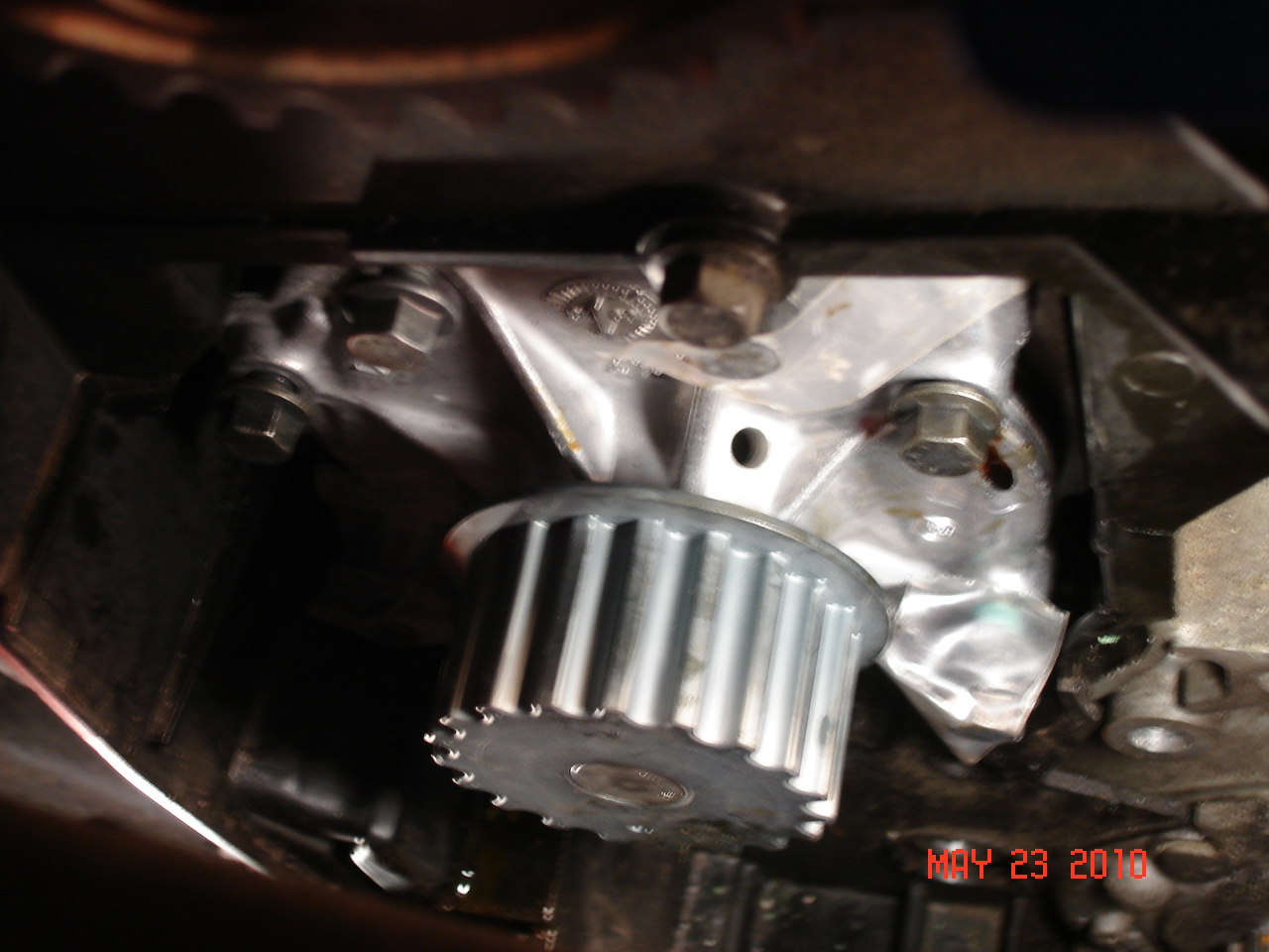

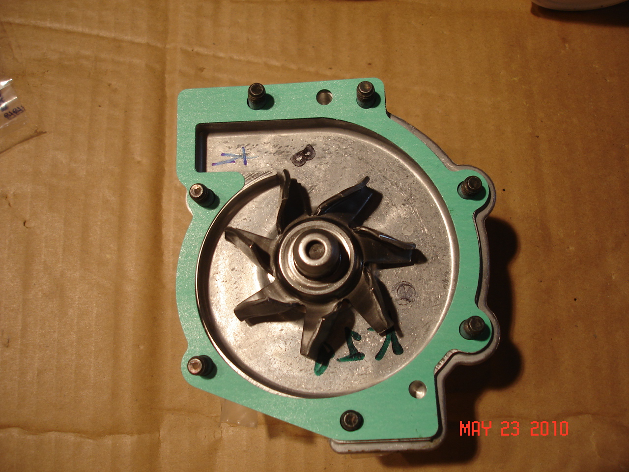

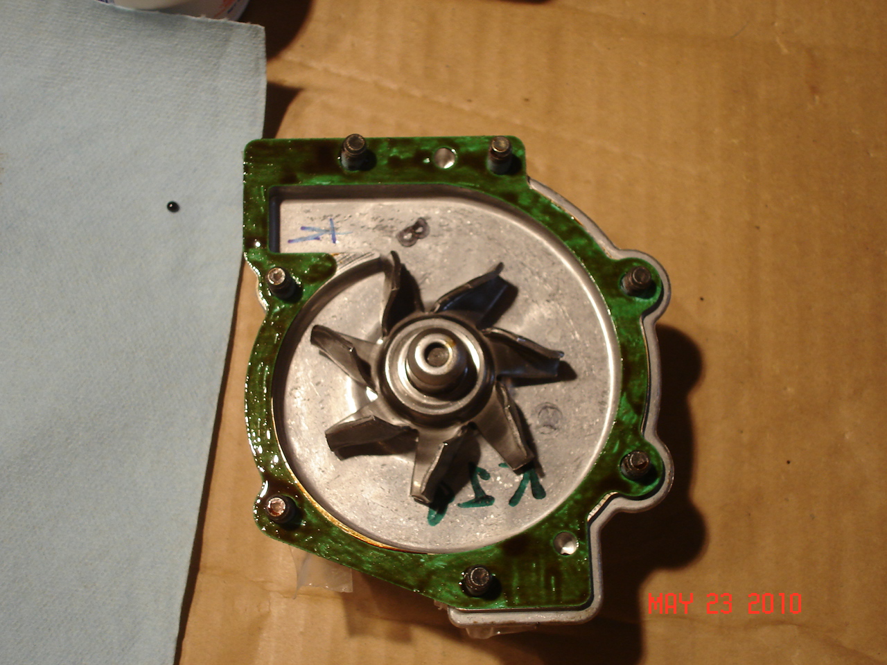

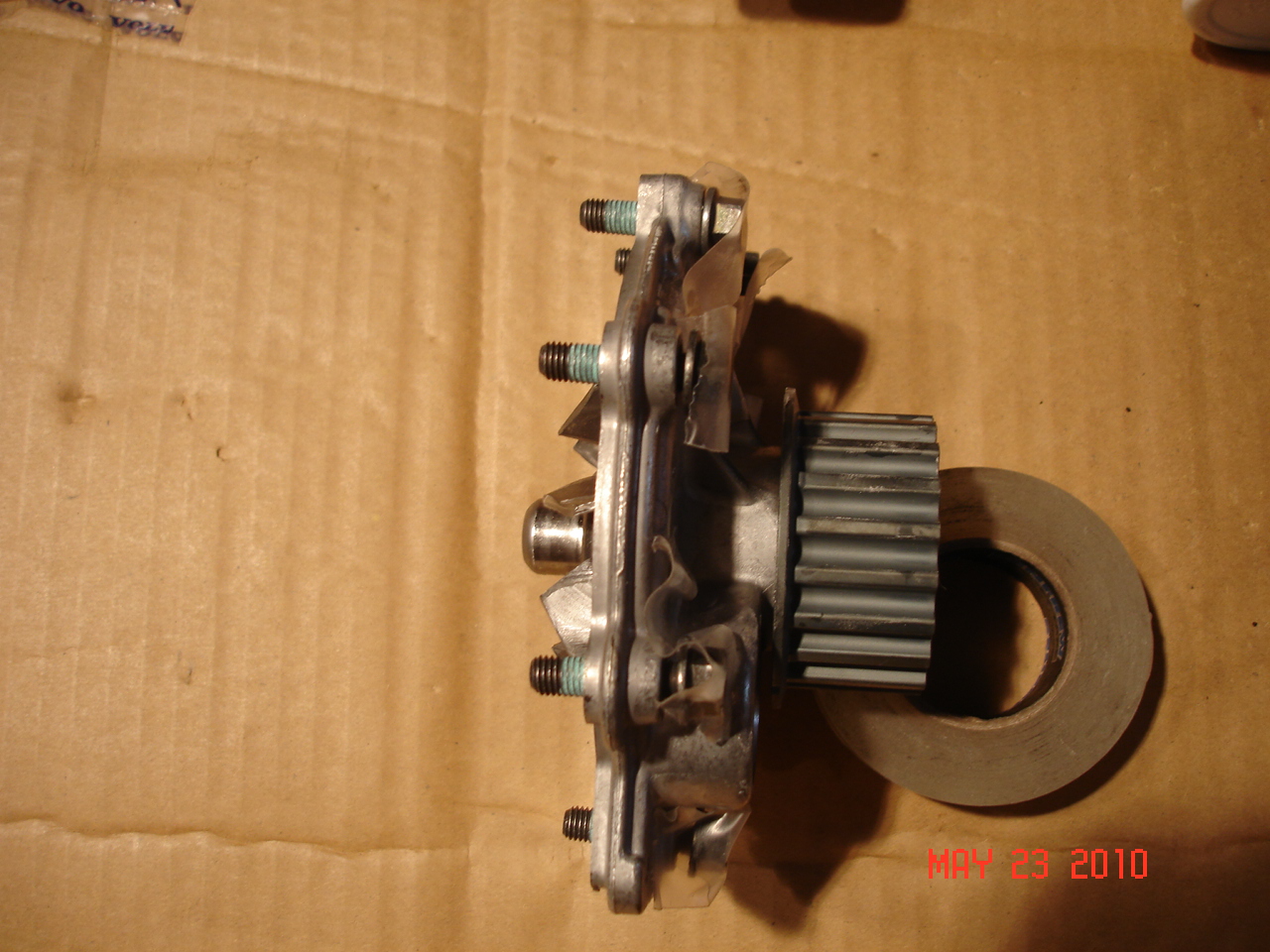

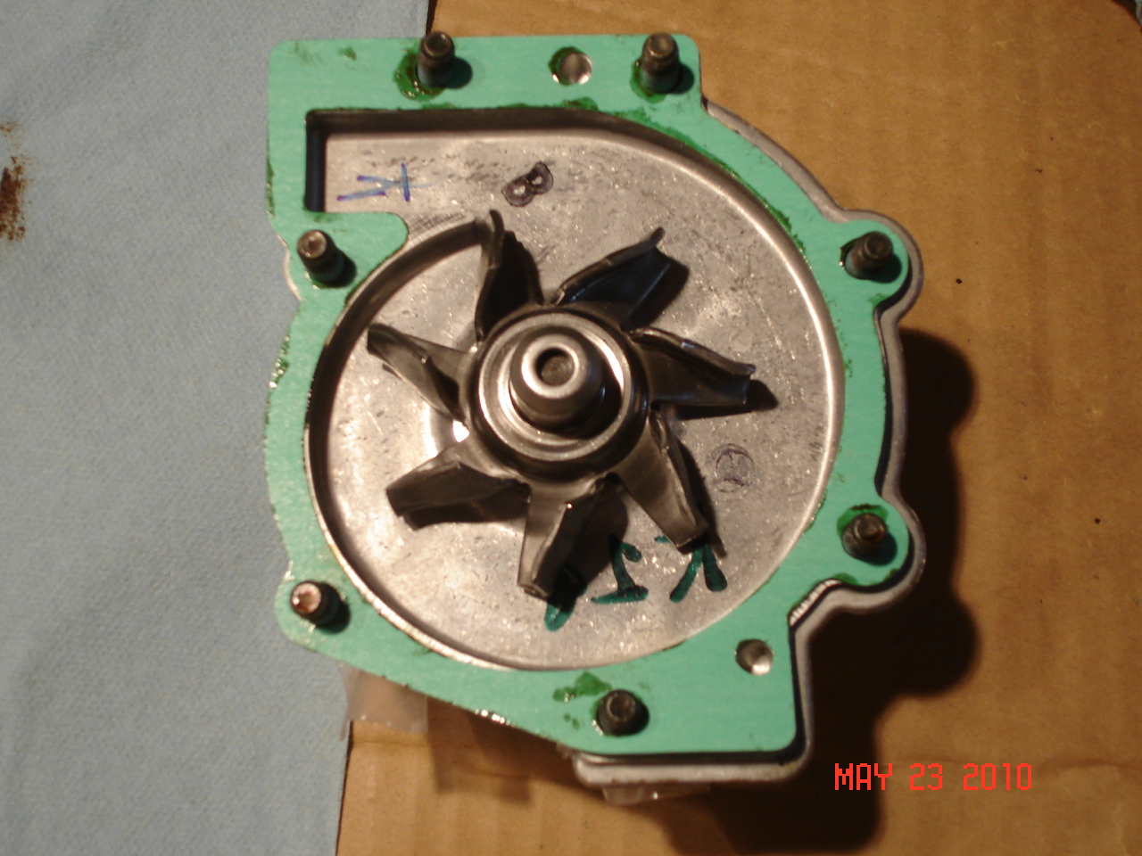

Spent some time yesterday and installed the water pump and all my new timing belt components
(tensioner, tensioner pulley, tensioner idler roller) and auxiliary idler roller (regreased).

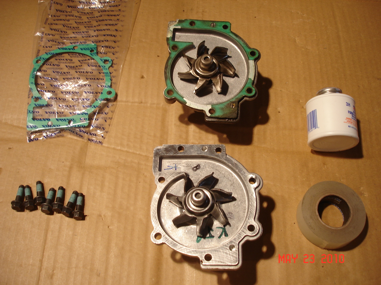

I tried something a little different on the water pump. The experts can tell me if I screwed up.
Since I'd read that some folks add some stuff to make the gasket stick to the block to make
installing the water pump easier I decided to try the whole operation outside on the floor.
The gasket seems to be the main point of failure with the water pump so I decided to try something.
I applied a thin coat of liquid gasket thinking this will provide some wiggle room if I didn't
get the gasket area completely clean or if I scratched it a little with the razor.
I'm pretty lazy so I decided to have all the bolts ready to tighten down instead of trying to install them
one at a time and drop then a half dozen times...
Here's what I did:
Lightly tape bolts to water pump.
Make sure gasket fits over the bolts.

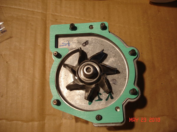

The next steps happen very quickly. I test install water pump so I know the path I will use to
install it. From adding liquid gasket to installing the pump is a minute or two. I wanted the
liquid seal to fill any potential leak points so I didn't want to let it dry all the way.
Apply liquid gasket to gasket (you can probably skip the liquid gasket step if you want)
Install gasket on water pump.
Apply liquid to other side:
Having the bolts ready to go made this go smoothly. The write-up took several times what the actual install took.
Hopefully this will all work just fine when I install the timing belt, auxiliary belt, refill with coolant*, reconnect the
battery, and start the car. *Still debating on changing coolant hosed first.
Here's what I did:

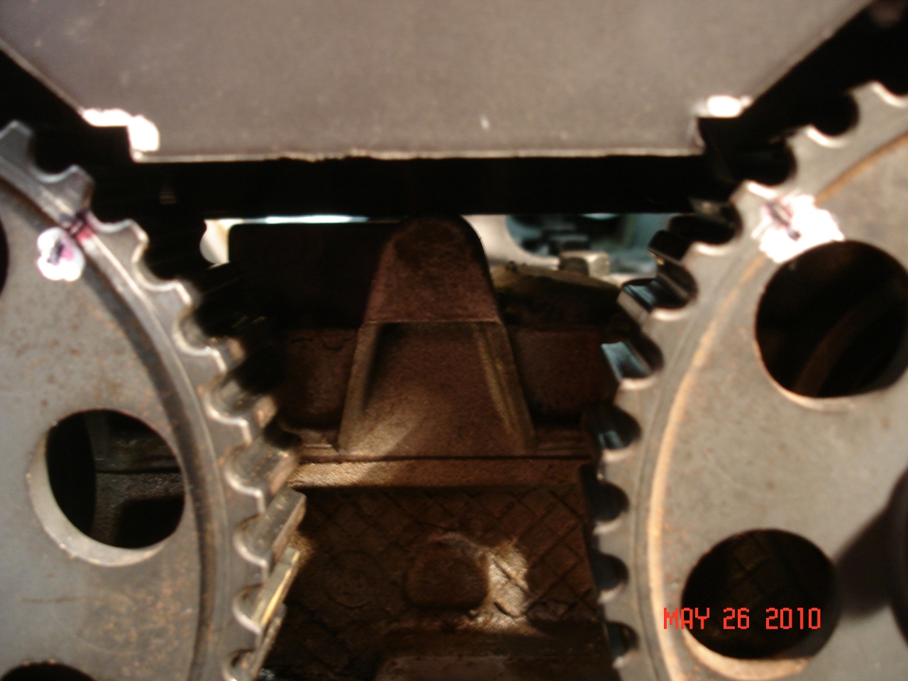

I started using the IPD cam locking to but I wanted to move the intake cam to remove slack between the intake and
crank so I temporarily removed it for this operation. Good thing I marked the timing belt at a few reference points
and transfered it to the new belt. The exhaust cam moved on me and the white marks on my new timing belt saved
me a great deal of time.

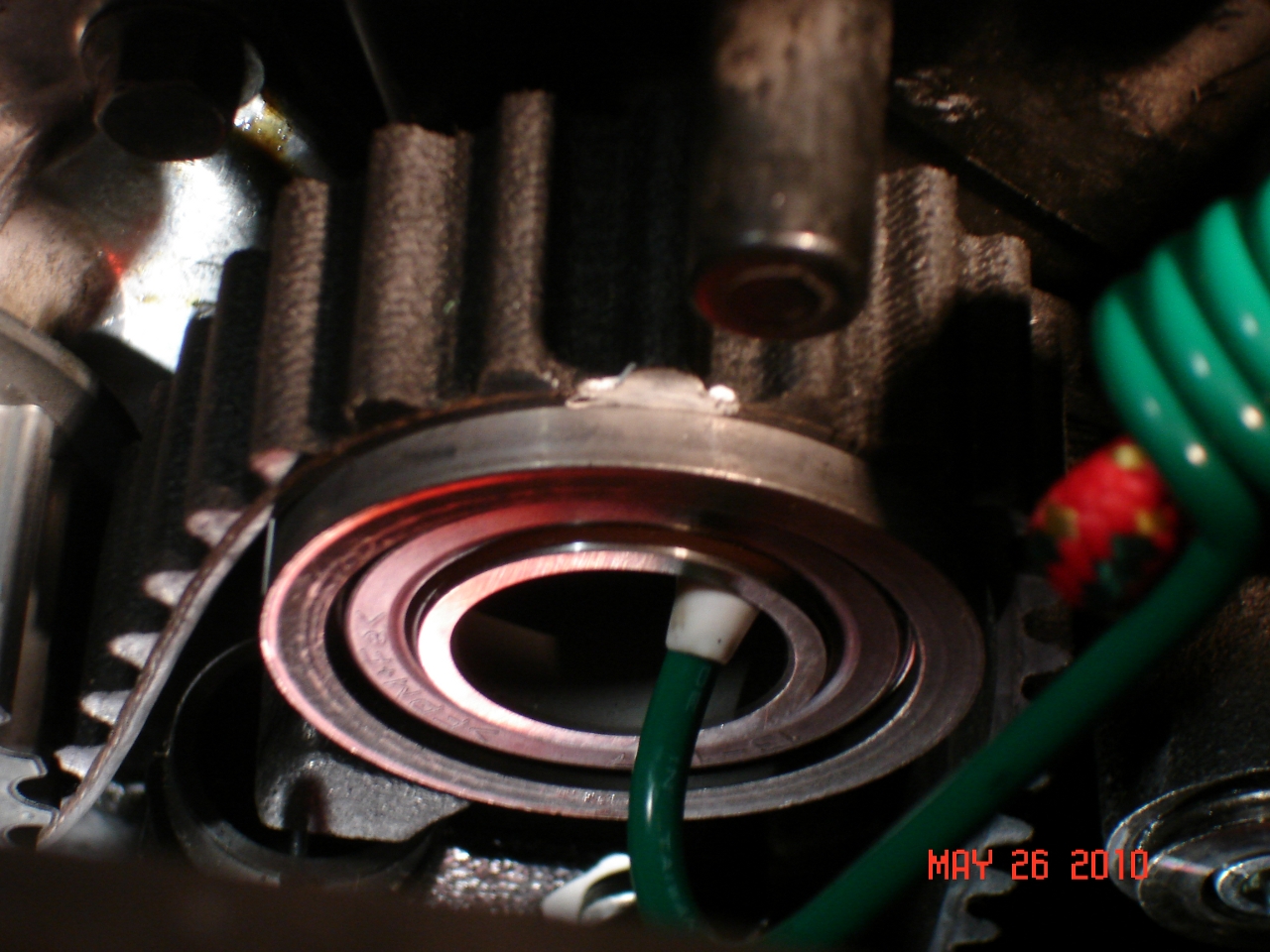

I started lining up the belt in the intake cam ( a little different from posted instructions) because I had marks I wanted
to line up. I put the belt on the intake a tooth or so off with the intention of moving the intake cam to remove slack.
This worked great for me.
The white marks on the new timing belt lined up exactly with the picture of where they where on my old timing belt.
I marked the two cams and one under the stub near the tensioner roller. Gave me a feeling of security as I did the
job. This also made it clear my exhaust cam had moved on me. The IPD tool was like a crutch ( I was terrified of
moving the cams and wrecking my engine) but now I understand things better and no longer need the crutch.

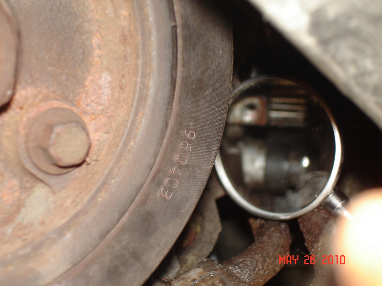

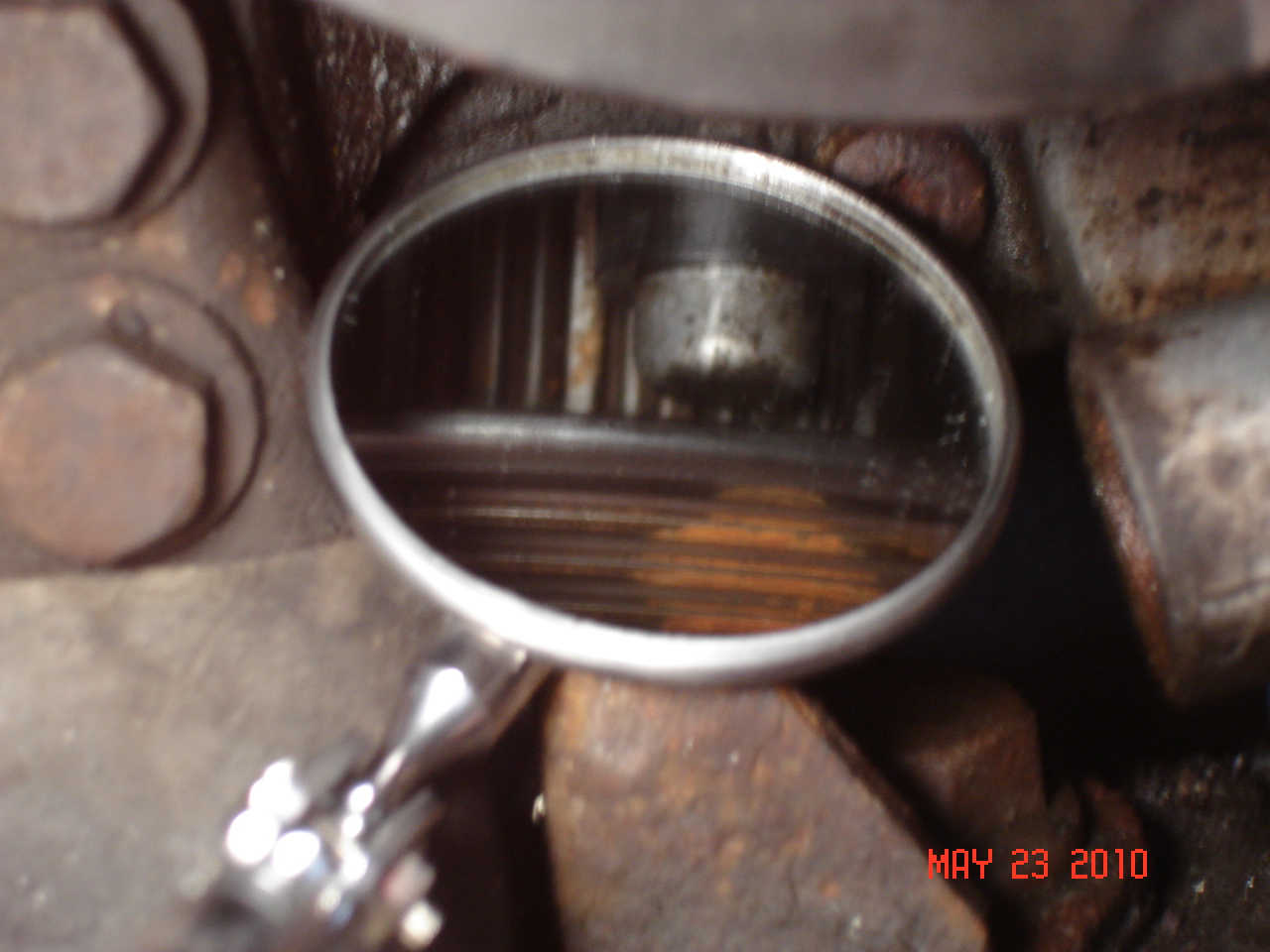

Taking the belt off was a pain. I will post some pictures of the two obstacles below (the stub under the crank and
the crank cover bolt mount points.
In order not to destroy my NEW belt I practice putting on and taking of my old belt a few times. Now that I know
how to do this I need another 850 to change the timing belt on. I figure at my rate of speed I'll need to charge $2500
for a timing belt job.
Note that I also placed white marks on the timing belt and crank where the belt contacts the crank. Basically at the

My crusty water cog spun with little resistance compared to the new well-greased water pump I installed. I suspect
this water pump MAY have been close to dying and MAY have contributed to the noise emanating from my timing belt
and auxiliary belt area.
top of the cranks. These were more exact (tooth granularity). These marks were my security blanket and helped me
avoid a potentially time consuming mistake.
This mark is just below the stub that is right above the timing belt tensioner roller. It aligned perfectly to old timing belt
mark. Photos help with this process.
