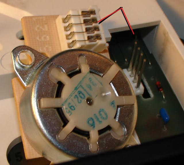

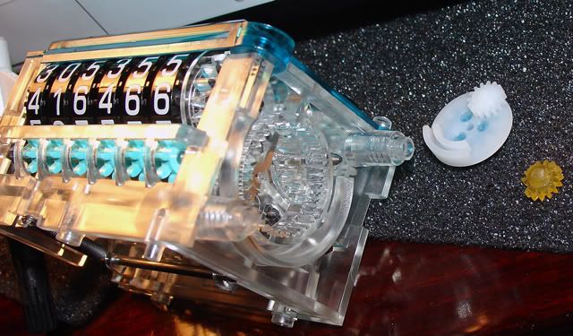

Thanks for taking the time to post the photos and explaining everything.
I followed instructions to fix the odometer.
Did a test run and it still doesn't work! I want to see the numbers roll.
I just took it apart again and the none of the teeth are broken. One thing to note (not sure if this affects anything) is that it doesn't have a wire, instead there is a 4 needle adapter.
SEE PHOTOS
Not sure what's wrong???
SEE PHOTOS

The smaller gear looks like it has a tooth missing!!!!
Or is that the old gear?
Did you try to wind on the miles using the pencil and eraser method? Did the numbers roll then? If not you may have the orientation of the gears all wrong or the motor may be shot.
There is a way to test the instrument panel. Look at the download-able 850 manual at the top of the page under instumentpanel.pdf

The gear in yellow is the old broken tooth.
I didn't use the pencil and eraser method, instead I just manually turned/ rotated the wheel just enough to get the trip as well as the collective miles to move, so I could press the reset button. It rest, but once I installed it back in and test drove, it didn't work.
I don't have a diagnostic cable. My car as a data link connector, but for some reason I can't get the OBD II to read anything on it.
Mind boggling. I'm determined to get it to work.

FINALLY GOT IT TO WORK!
THANK YOU TAILOR for all your help!
All I did this time was made sure I reinforce the prongs and made sure it was pushed in all the way.
The trip ometer is a little off, but I'm not going to bust my butt doing it a 3rd time.
CHEERS!
CHEERS!
