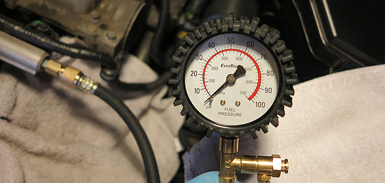

I will pick up gauge from auto parts to check fuel pressure at the fuel rail.

After overnight.
Ignition ON. No movement in needle - no pressure at fuel rail?
