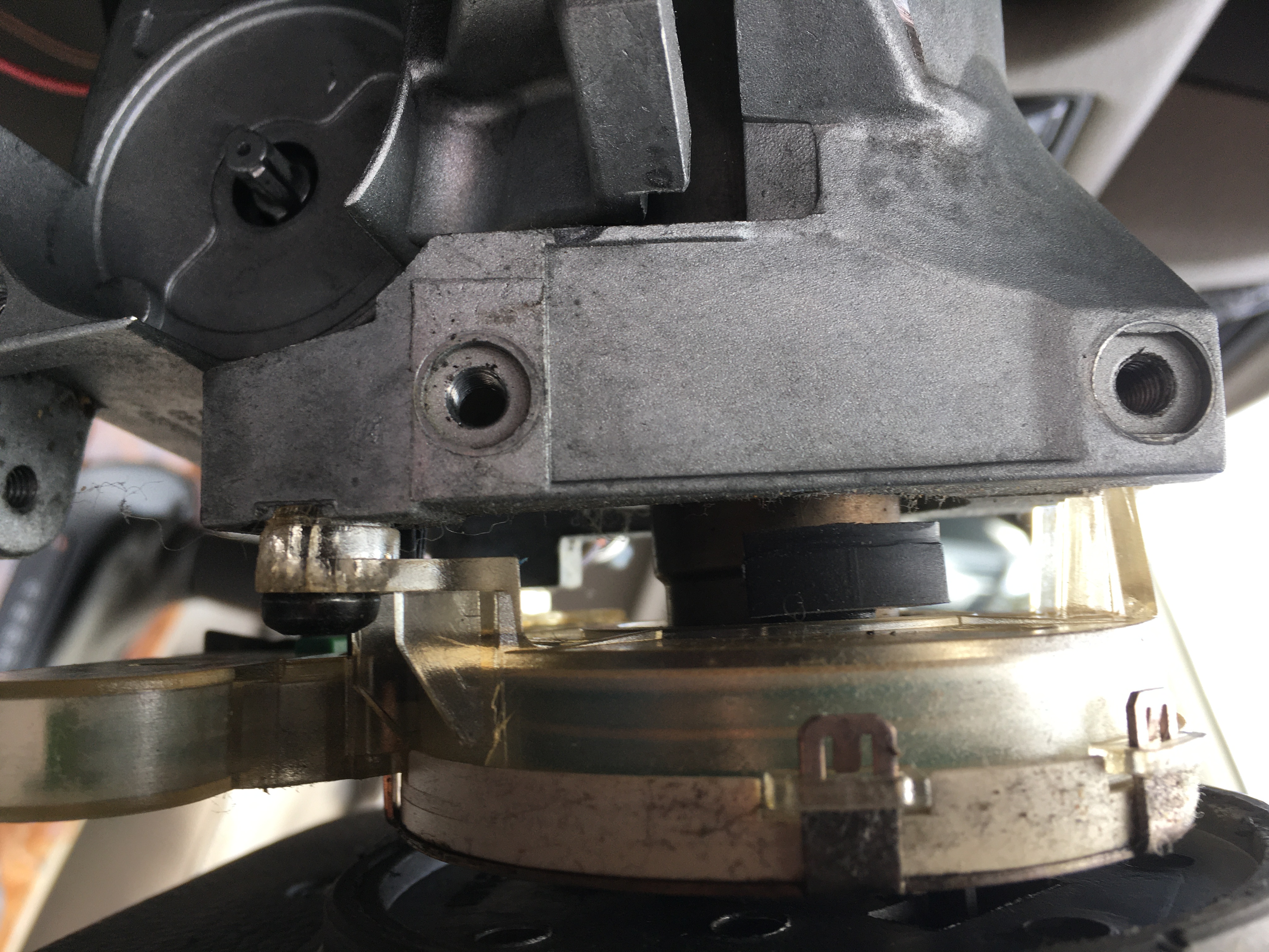

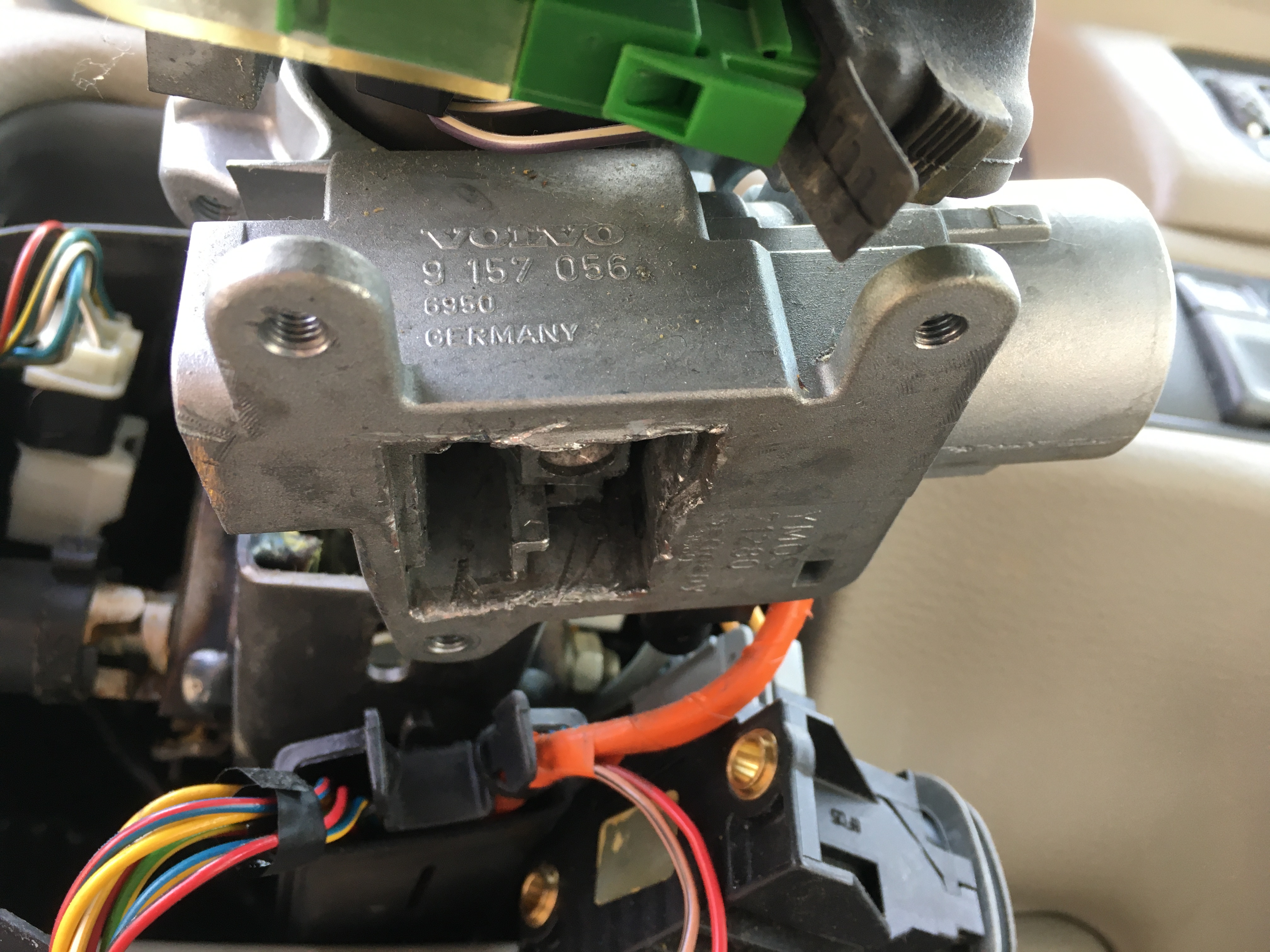

The electrical part ($50) won’t fix the key spinning or sticking problem, that needs a new tumbler ($400, or junkyard)
The junkyard route introduces a new problem of getting a set of keys that will work, plus extraction is probably a 1-2 hour job
Write up is here
viewtopic.php?f=1&t=98078
DIY: 1998 Volvo V70 Ignition Switch & Cylinder Lock
DIY 1998 Volvo V70 Ignition Switch & Cylinder Lock Replacement
