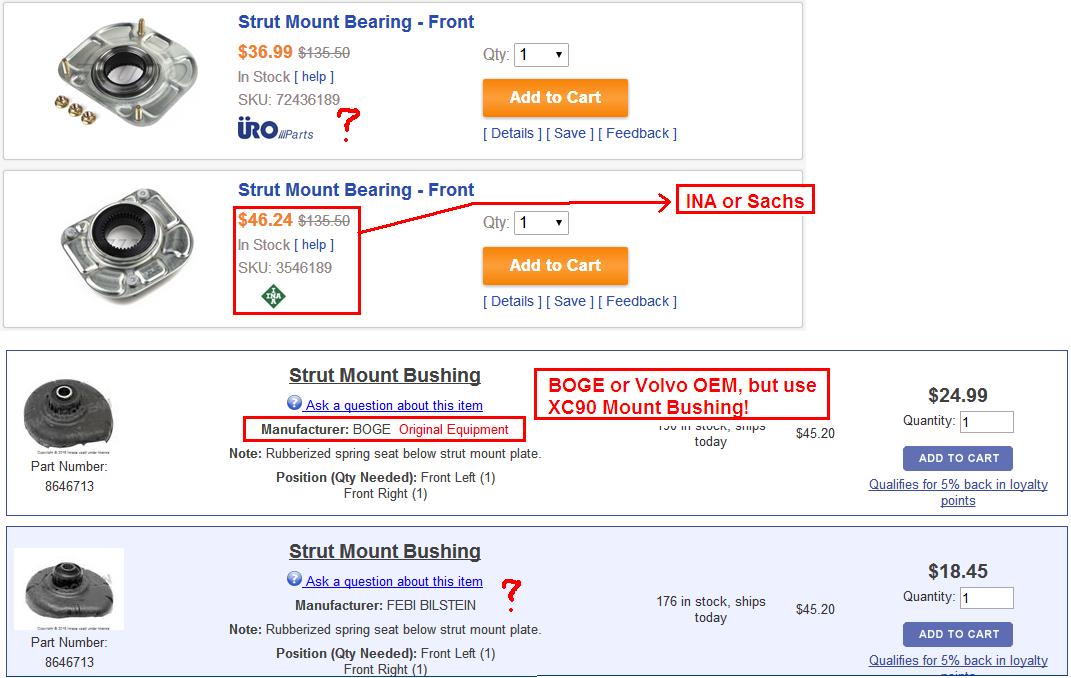

JimBee wrote:Maybe I missed it, but still not sure if Sachs spring seats (for 850) are OEM. Comments?
Jim,
Couple things: terminology and brand name.
Terminology: "Seat", "Bushing" etc. etc. terms can be confusing.
The bottom line is no matter what name people call them, there are 2 components:
a. The "Bearing" part (this allows the front wheels to turn R and L on the strut bearing). Use INA, Sachs, or Volvo OEM.
b. The "Cushion" part: basically a steel plate coated with rubber. Use BOGE or Volvo OEM.
erikv11
Posts: 11913
Joined: 25 Jul 2009, 14:03
Location: Iowa
Has thanked: 312 times
Been thanked: 818 times
Post by erikv11 »
"Strut mount" and "spring seat" are the terms you will find in > 95% (my estimation!) of the discussions.
bearing = strut mount
cushion = spring seat
It is true that there are various terminologies but fortunately I have never seen a vendor confuse the two, e.g. by calling the spring seat simply a mount!
